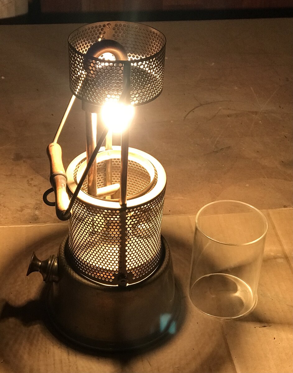

    Found this rare beast today at the swap ,my mate saw it and left it but I saw something about this one its not a Lamp but Lantern missing its cowl .
    Help need picture of what it looks like .
    The mantle for this looks to be a preformed one with 3 lugs on it

    Here it is cleaned plus some photos of the burner set up not for a normal mantle must be earlier than the table lamp ?
    Bob
    1456567233-Kerona_cleaned_up_001.JPG 1456567281-Kerona_cleaned_up_002.JPG 1456567330-Kerona_cleaned_up_004.JPG 1456567381-Kerona_cleaned_up_005.JPG 1456567420-Kerona_cleaned_up_007.JPG

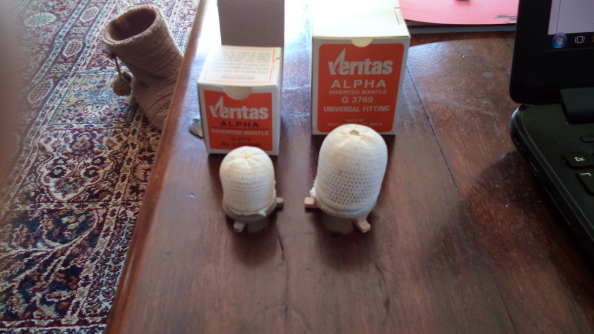

  14. ColinG
    1,465
    I have some of these...
    The small ones have an inner ring diameter of 19mm and the legs protrude 2mm allowing them to slip over a circle of roughly 15mm.
    The large ones have an inner ring diameter of 25mm (probably 1inch) and the three legs protrude about 2mm, maybe aittle more, allowing them to fit over a circle of about 21mm.
    If either of these might be useful I have quite a few. Likewise, if anyone else has a device that these might fit, make me an offer. I have 24x small mantles and 36x large. I'd be happy selling them singly or in multiples.
    Armed with a Dremel and some patience I suspect it would be possible to either remove the legs completely or trim them back a bit.
  15. ColinG
    1,465
    Excuse the lousy photo but the legs can be easily cut away with a pair of wire cutters without damaging the mantle, however, grinding the stumps flat wrecked the delicate weave.
    The inside diameter is very close to 25mm, just a smidge less than a Petromax style pepperpot burner.
