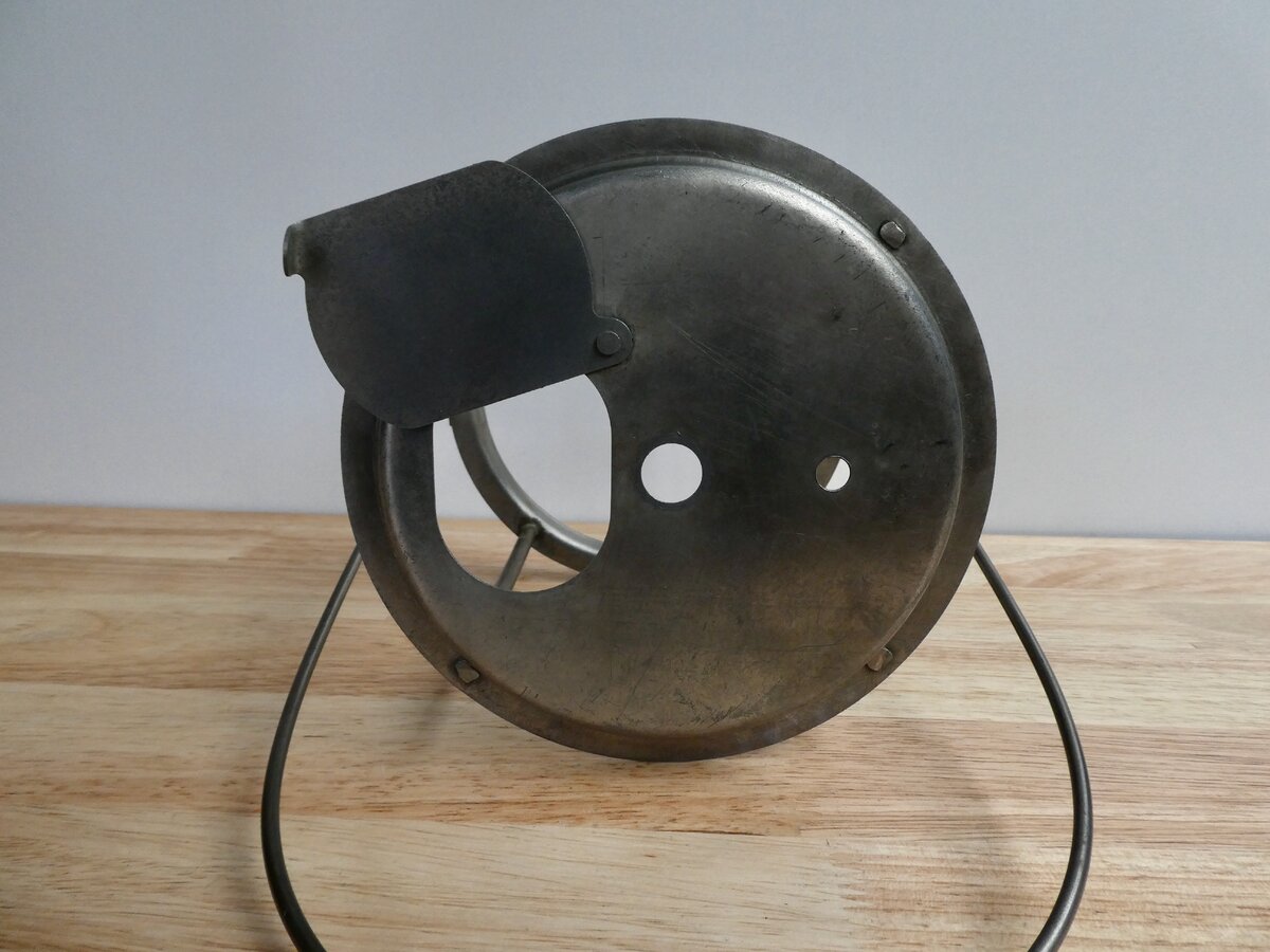

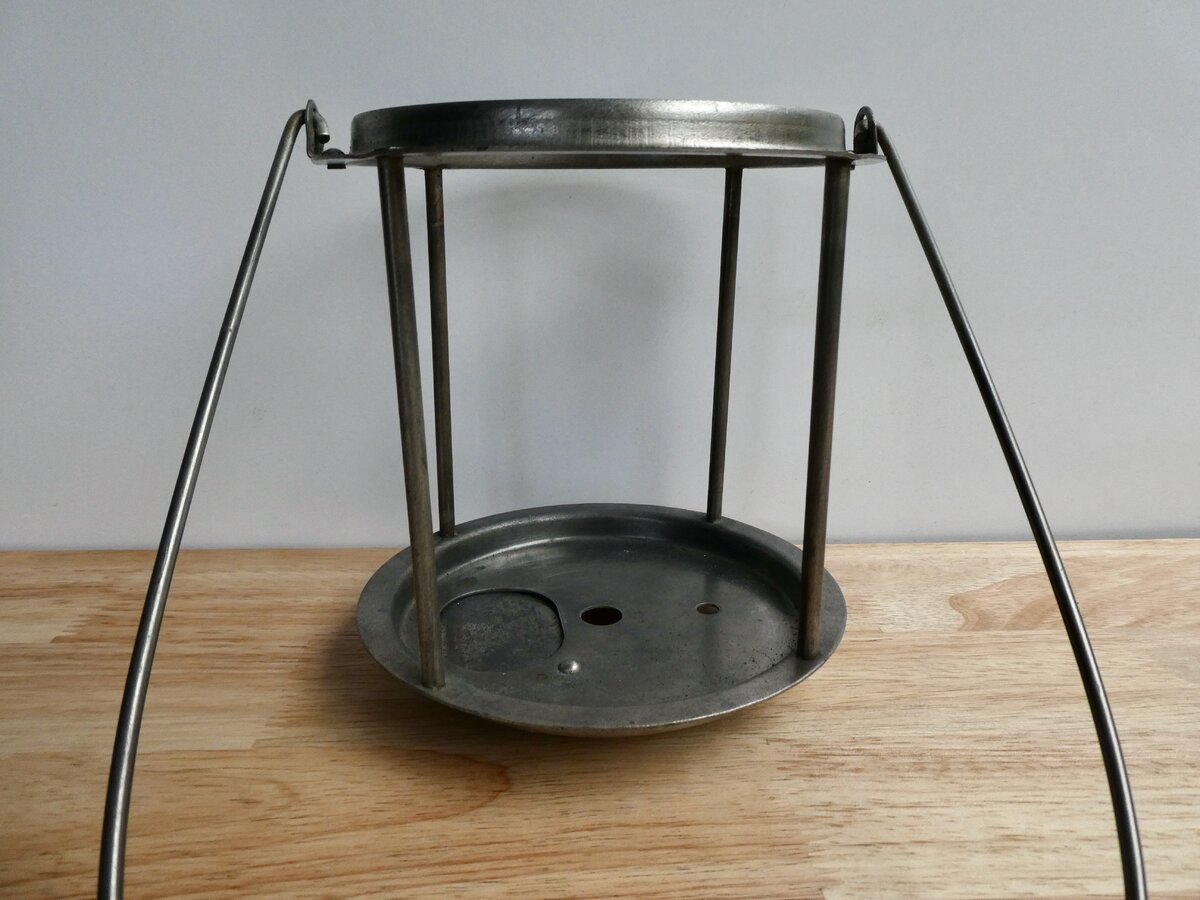

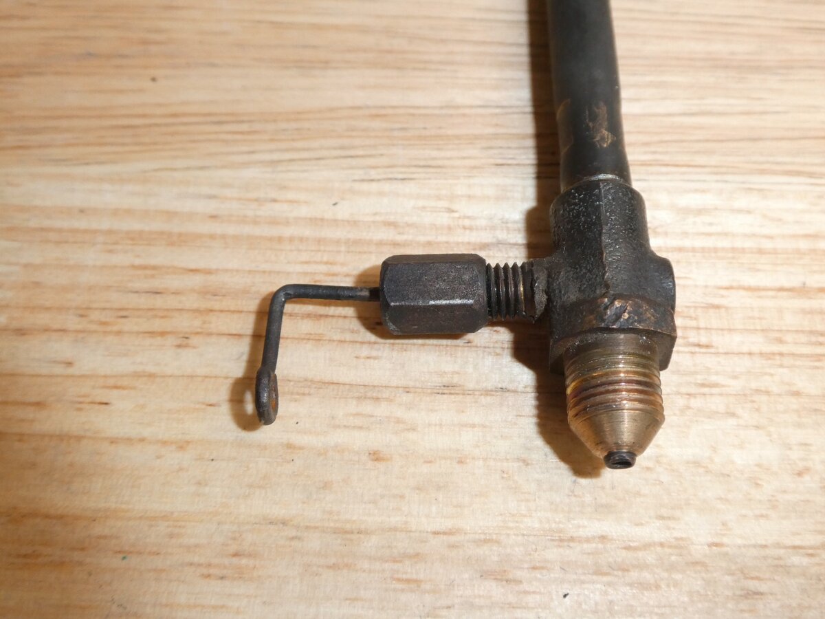

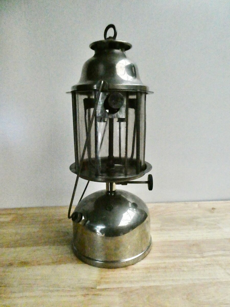

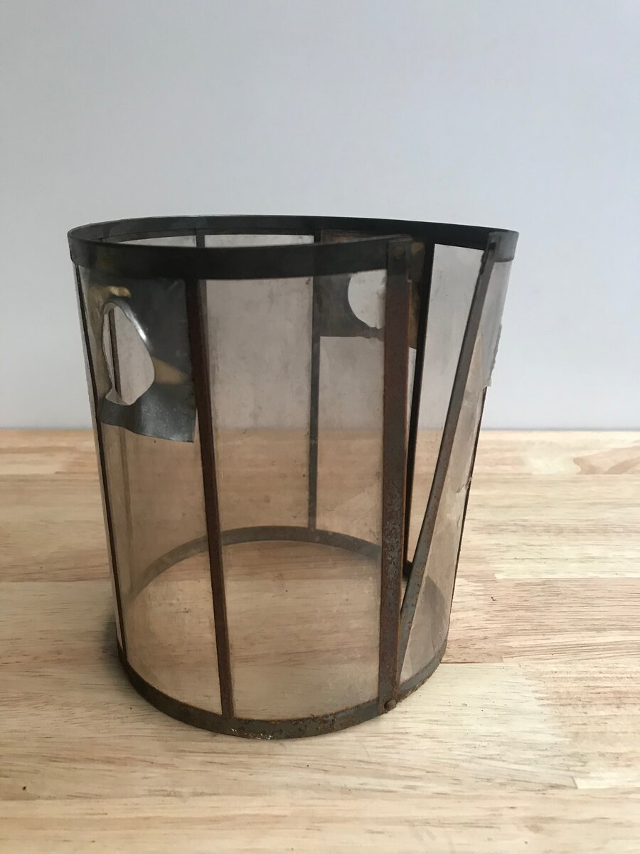

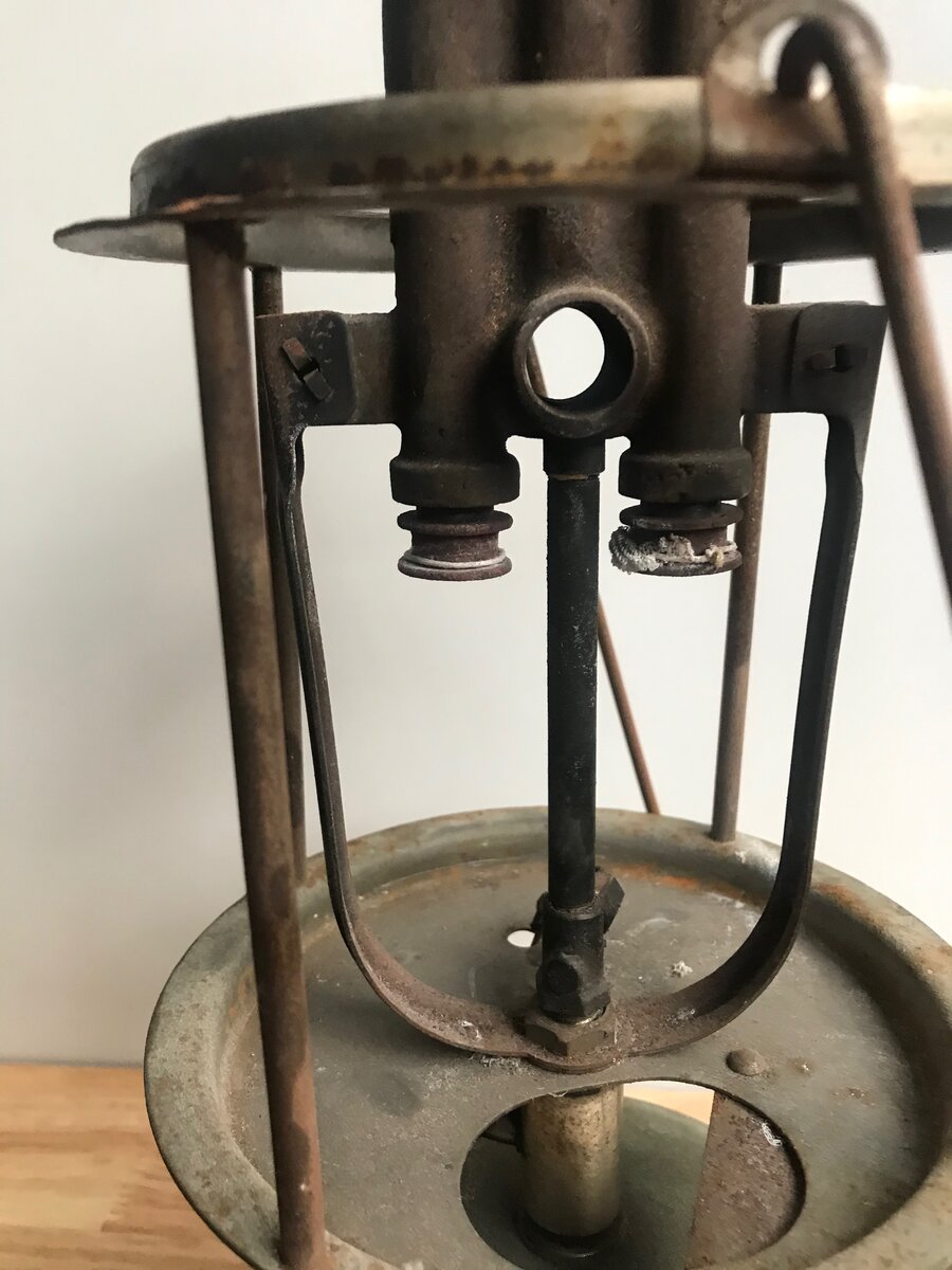

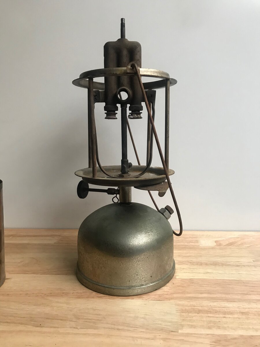

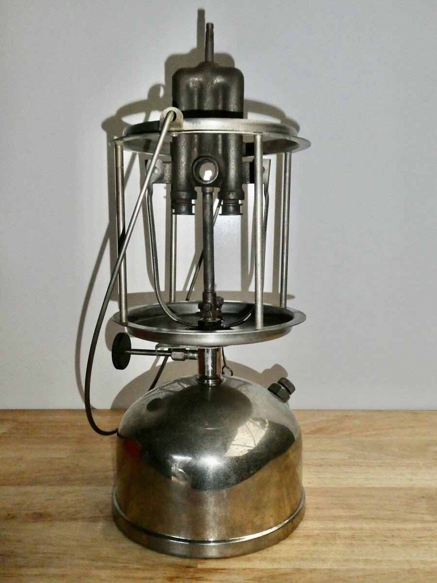

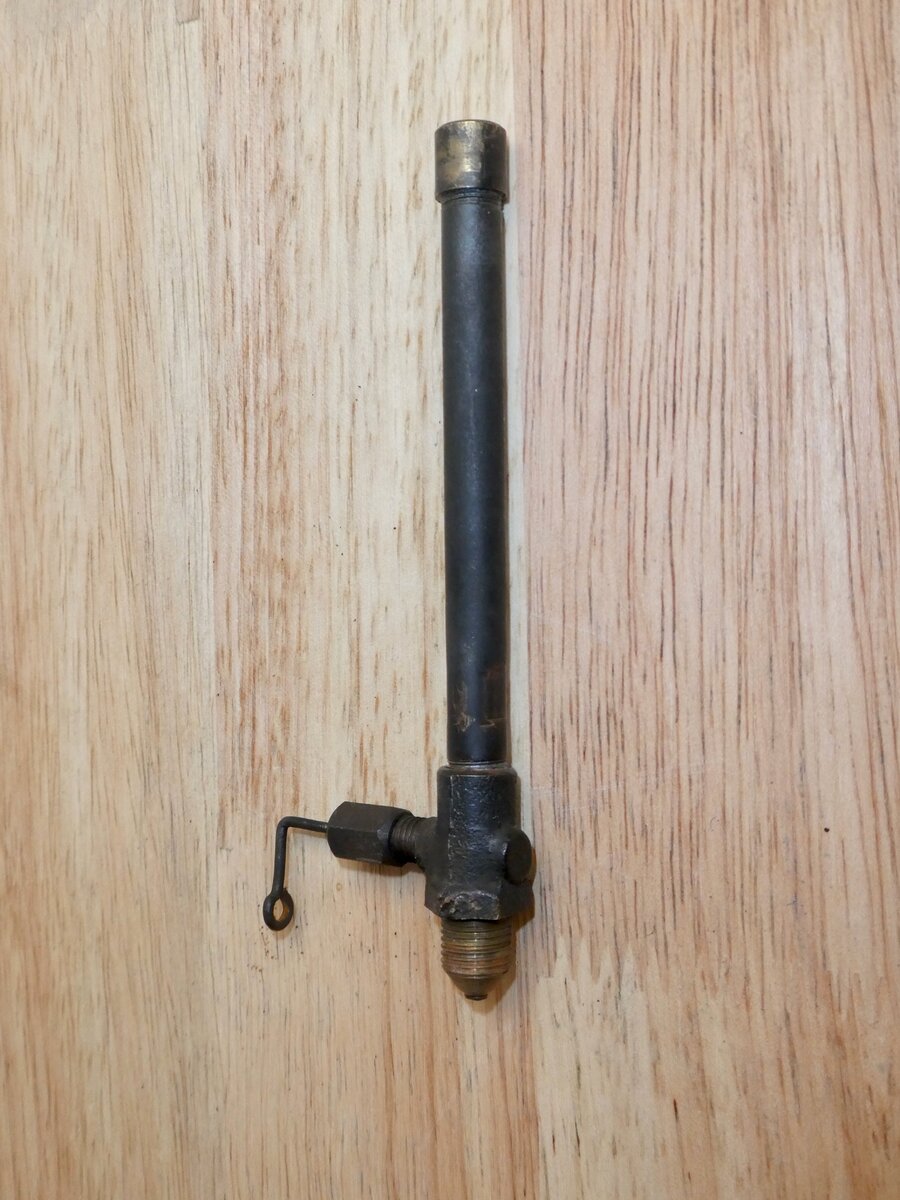

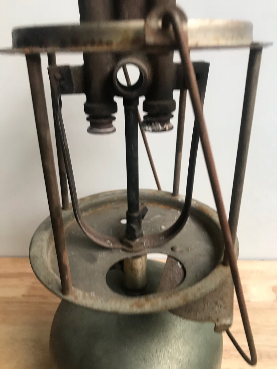

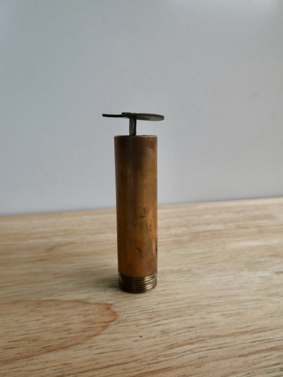

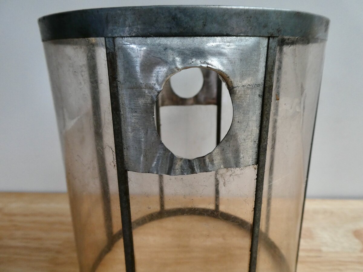

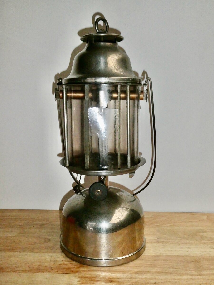

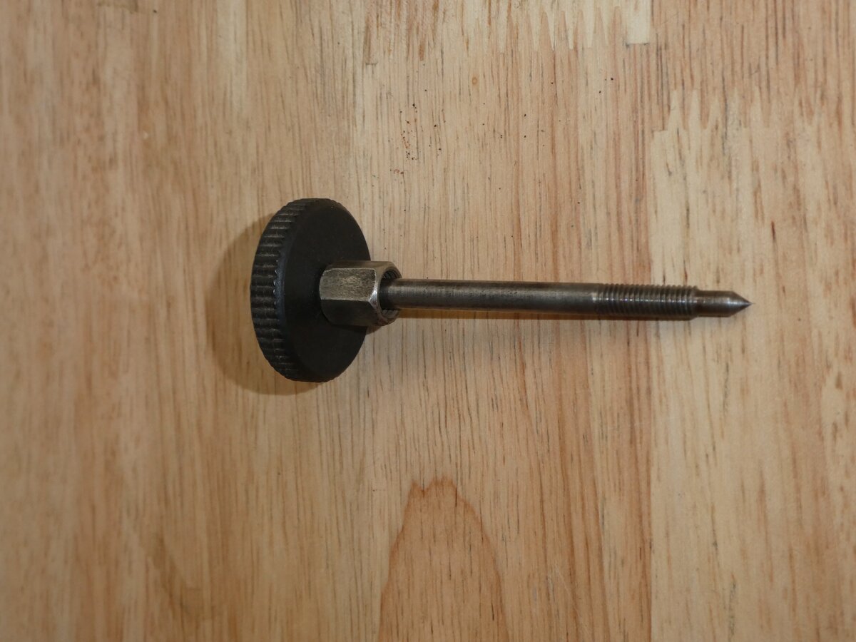

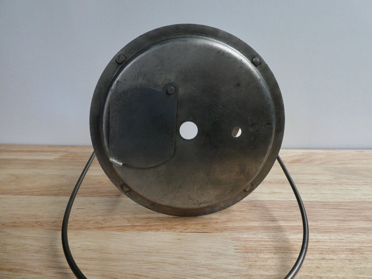

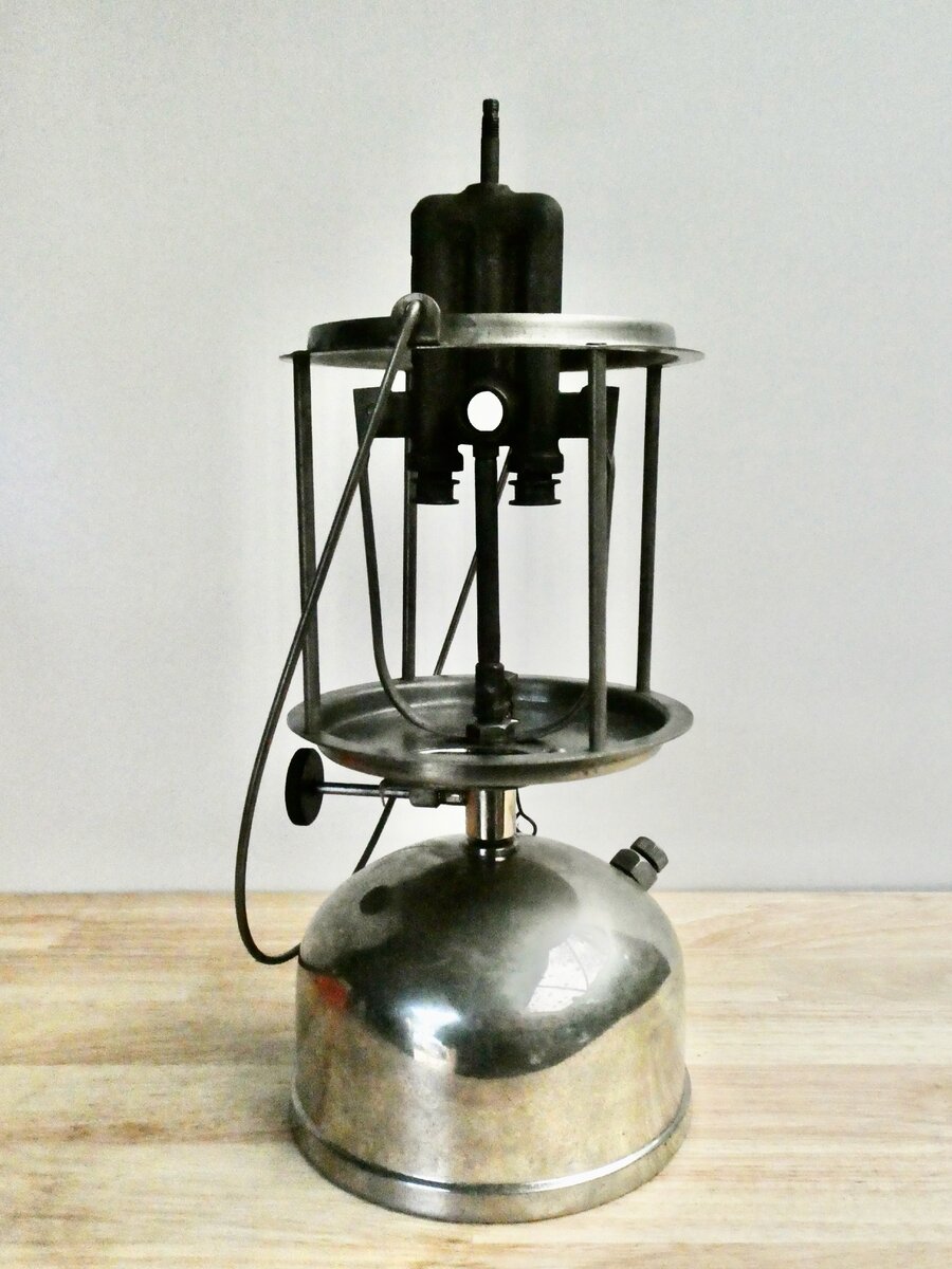

    This is my Thomas Kerosafe. Found in Australia, this one came with a generator with a pricking needle, and the hole in the cage plate to take the pricker extension.This probably dates the lantern 1920 - 1926.

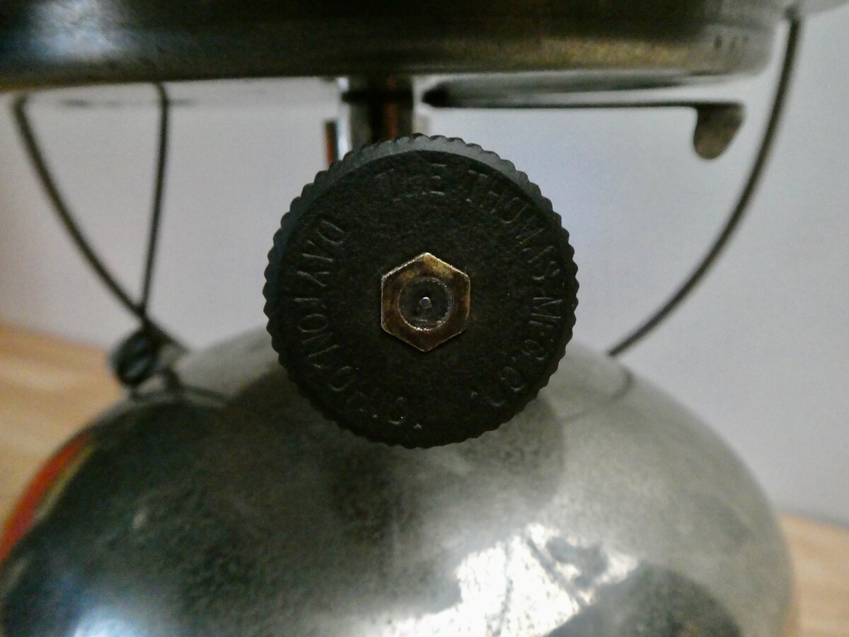

    The Thomas MFG. Co.Dayton Ohio

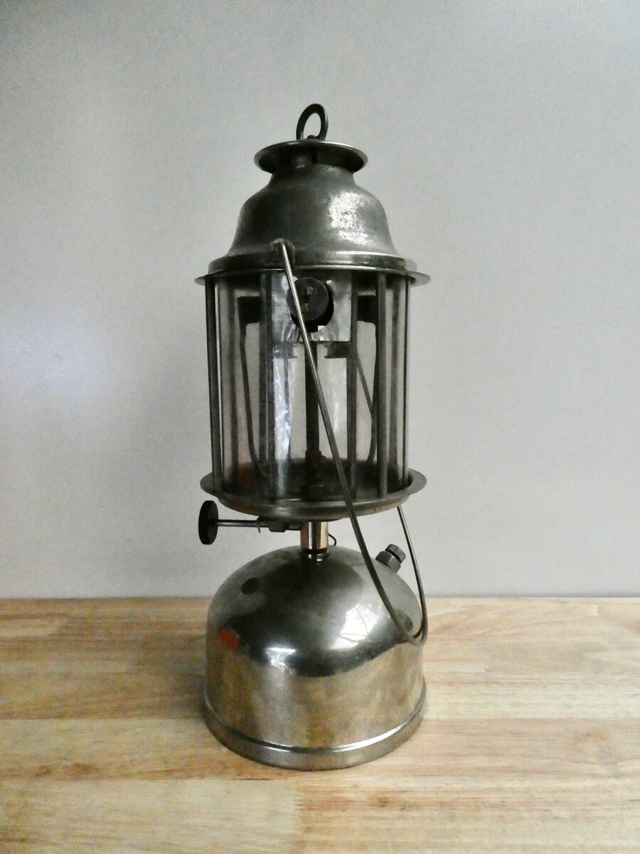

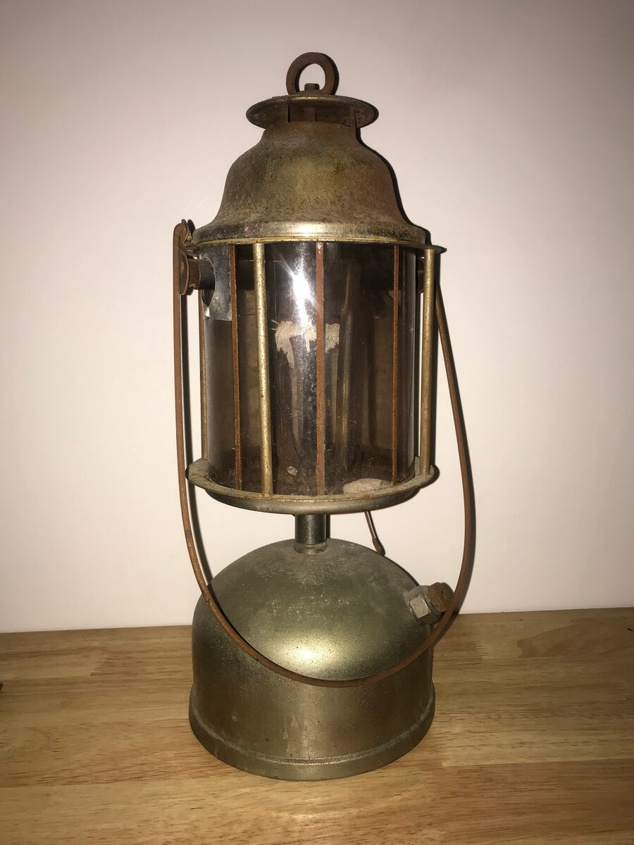

    As it came

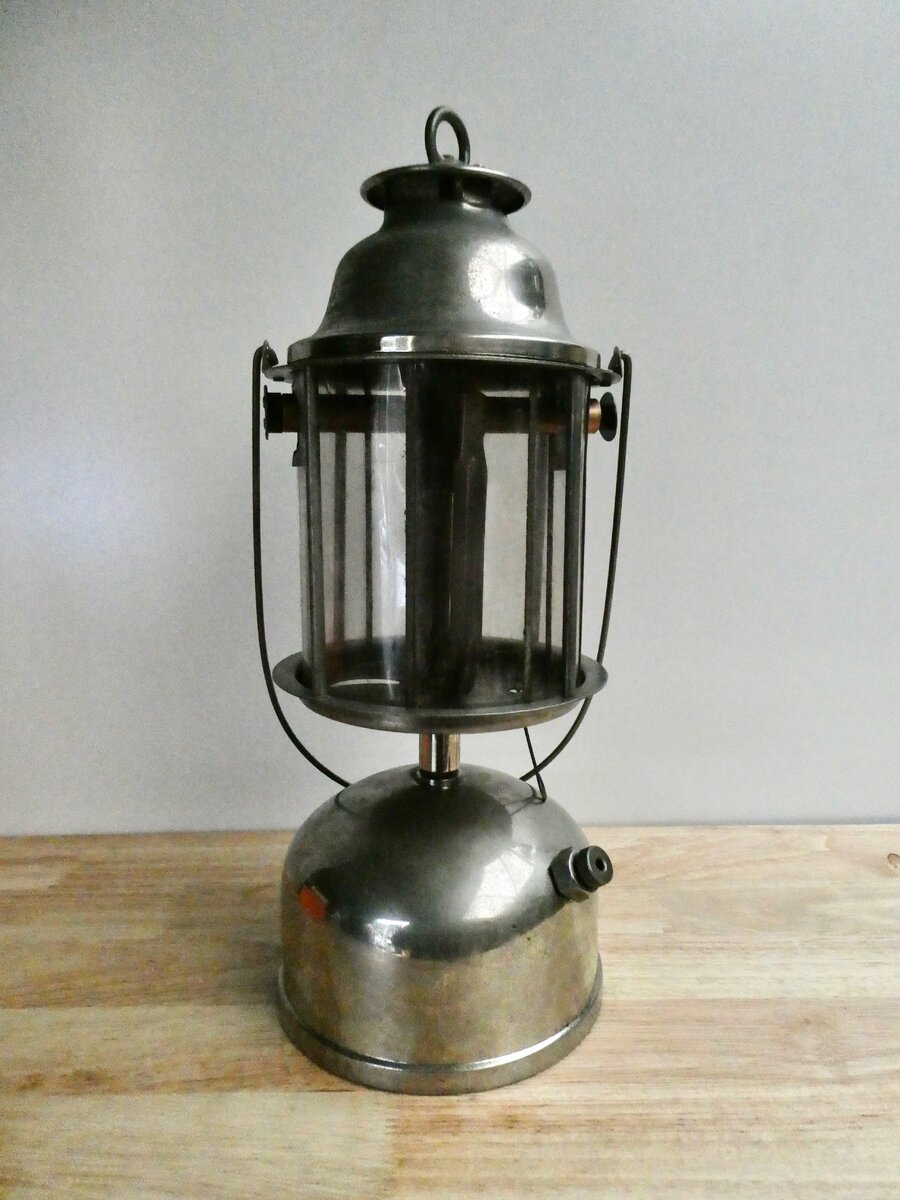

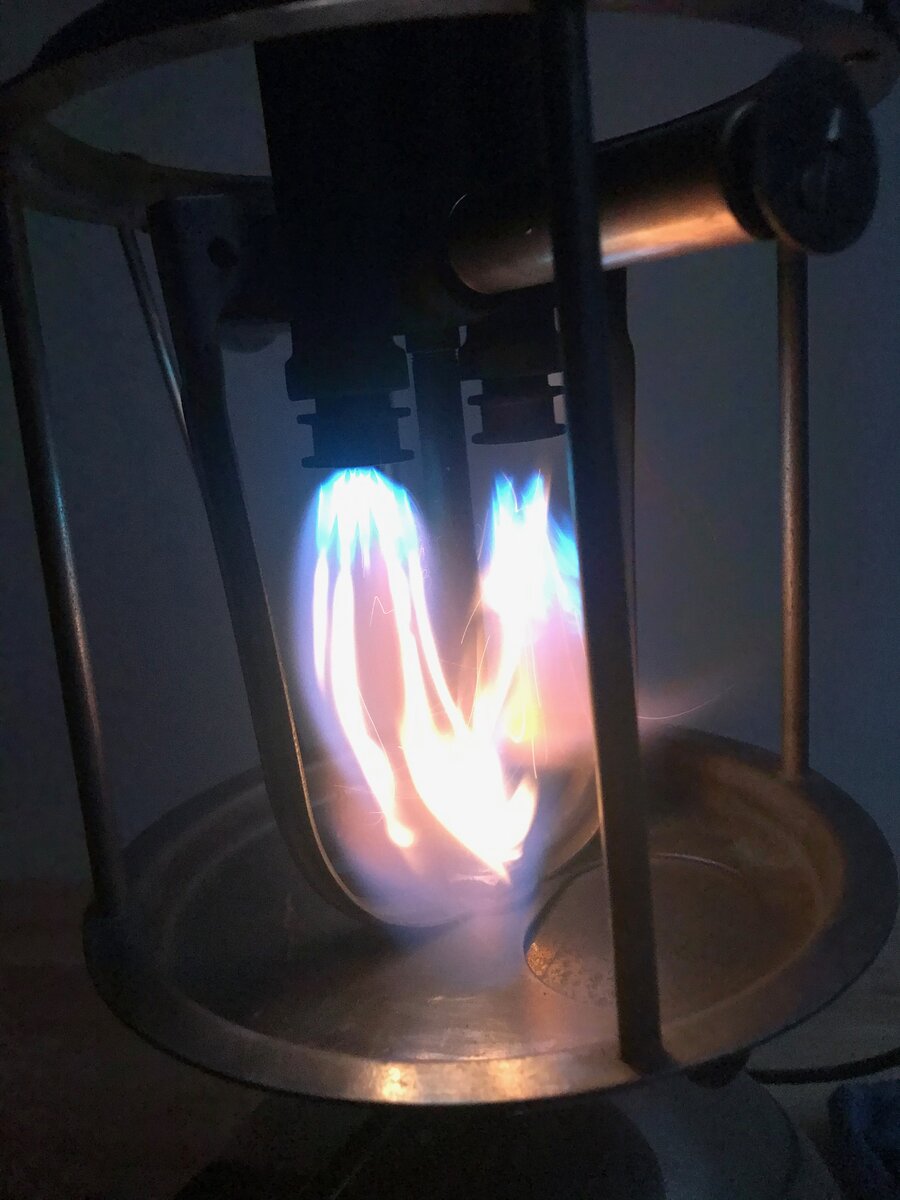

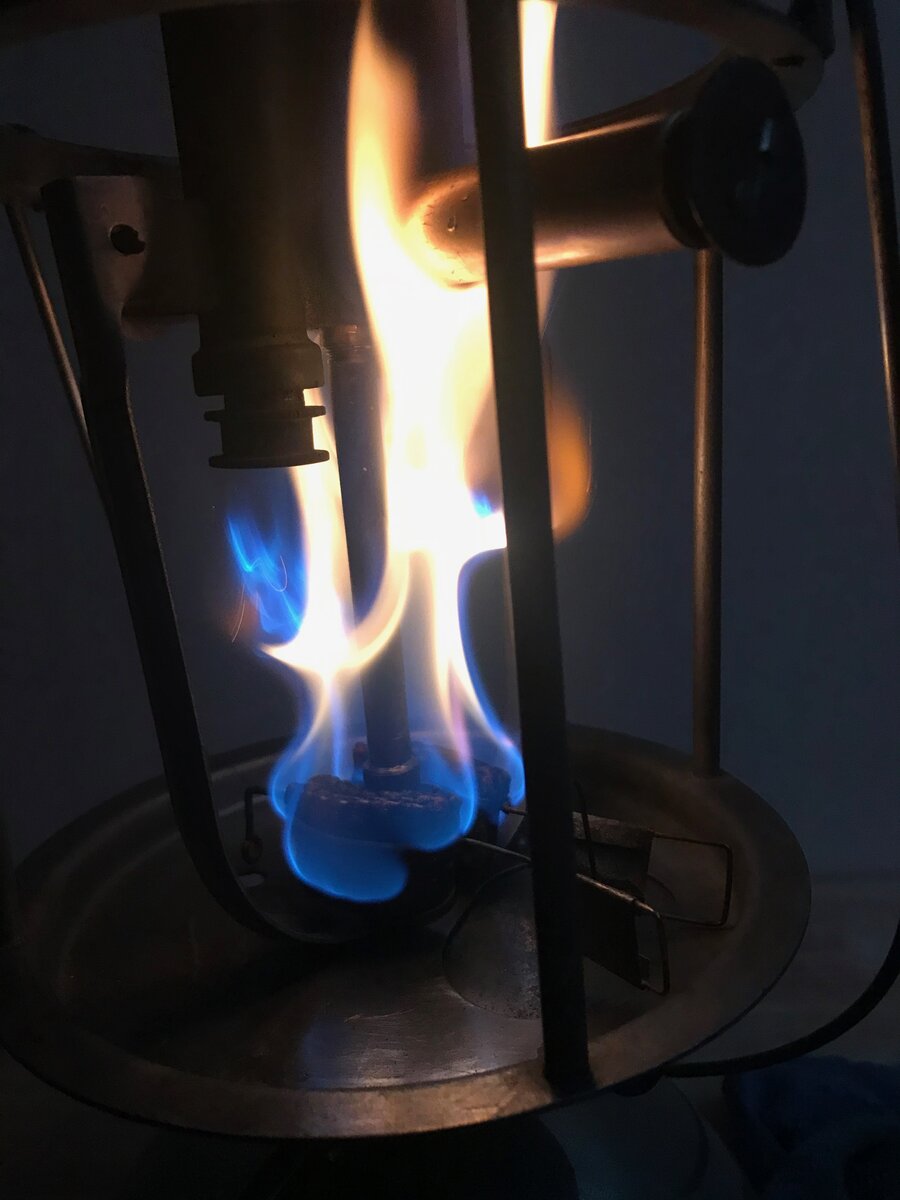

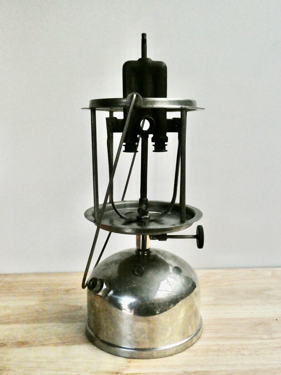

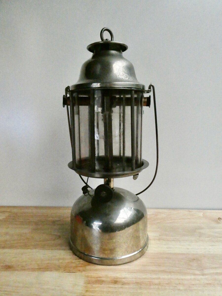

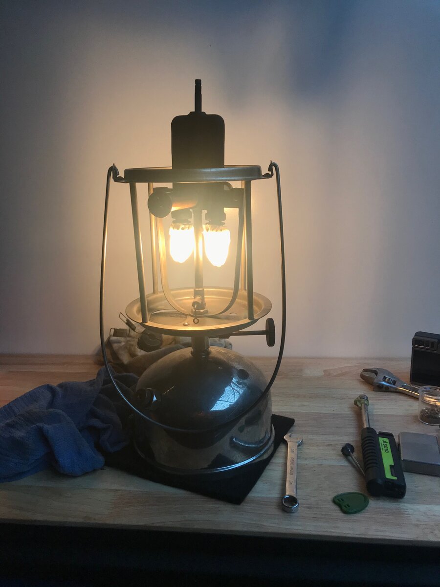

    Up and running
    This is a very fine lantern.
    Curtains drawn.

    The lantern has cleaned up very well and you’ve presented the fettle very well.

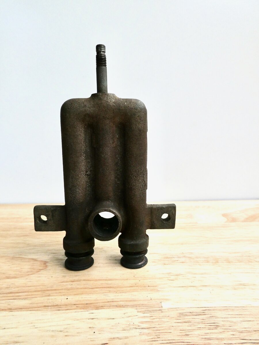

    Hum...that looks to be a very well made and substantial lantern indeed...
    The burner is a hefty looking thing..No wonder you are making a special pre-heater!...Is it cast iron or some sort of brass/bronze there, Tony?

    Thanks for the comments folks.

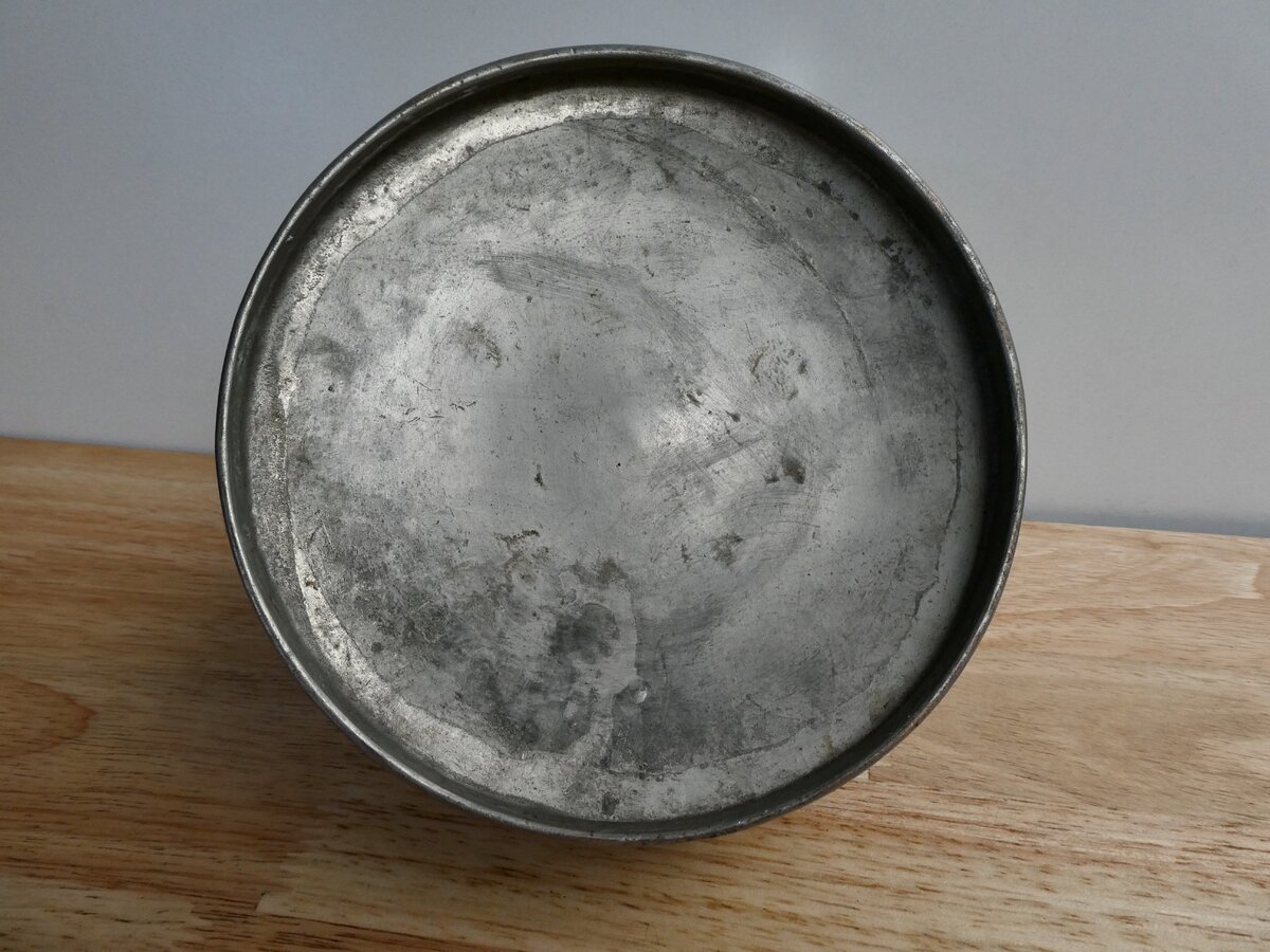

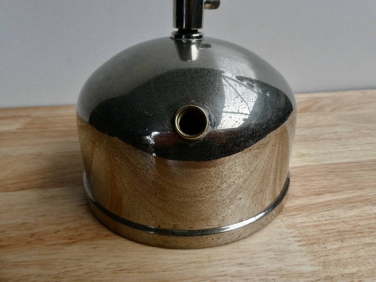

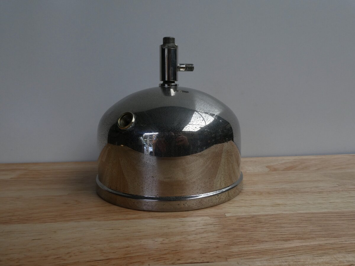

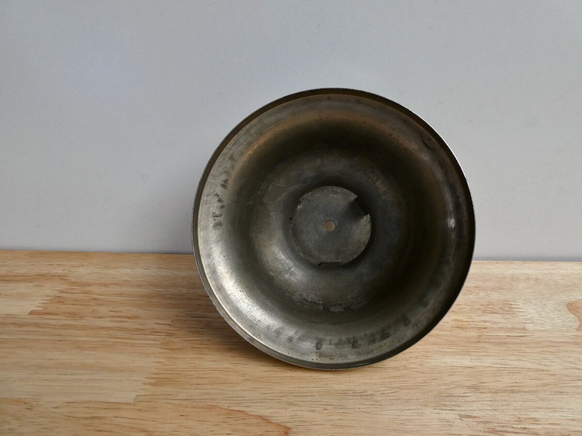

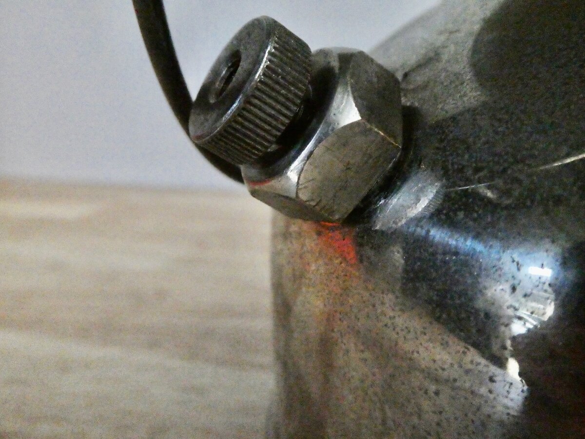

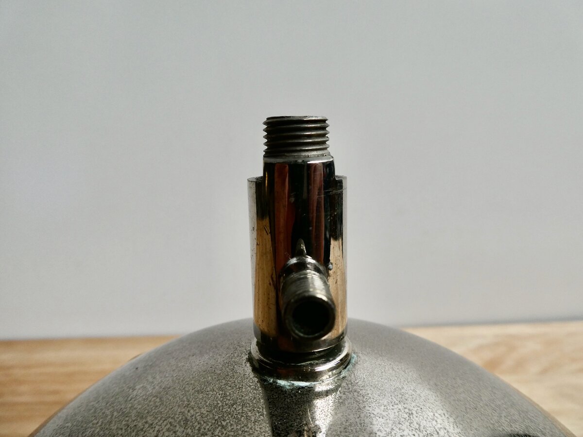

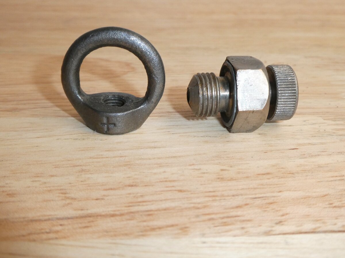

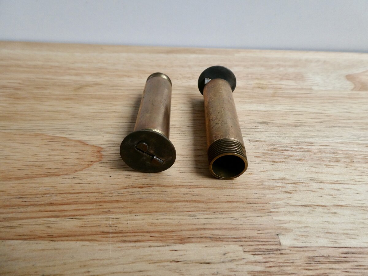

    The lantern is all steel except for the generator and the air tubes. My tank had no hints of stress cracks, and was pretty rust-free on the inside.

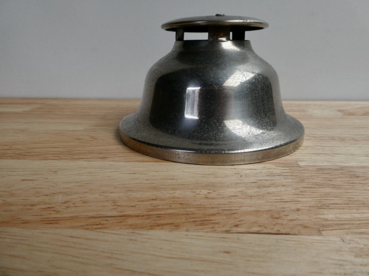

    The nickel plating on the vent is ok on one side and rusted away on the opposite side. The nickel plating on the tank is good, but pocked. The steel cage appears to have not been plated or, the plating has completely disappeared.
    It’s a solid lump of a thing.

    @Tony Press Tony, I think your spot on with the dates, 1920-26. The ones without the cleaning needle came out, I think in 1916, so without a tip cleaner 1916-20, with a tip cleaner 1920-26. I think production for this model ended in 1926.
