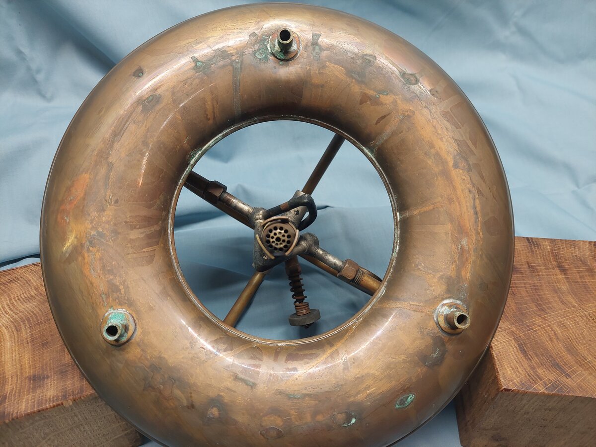

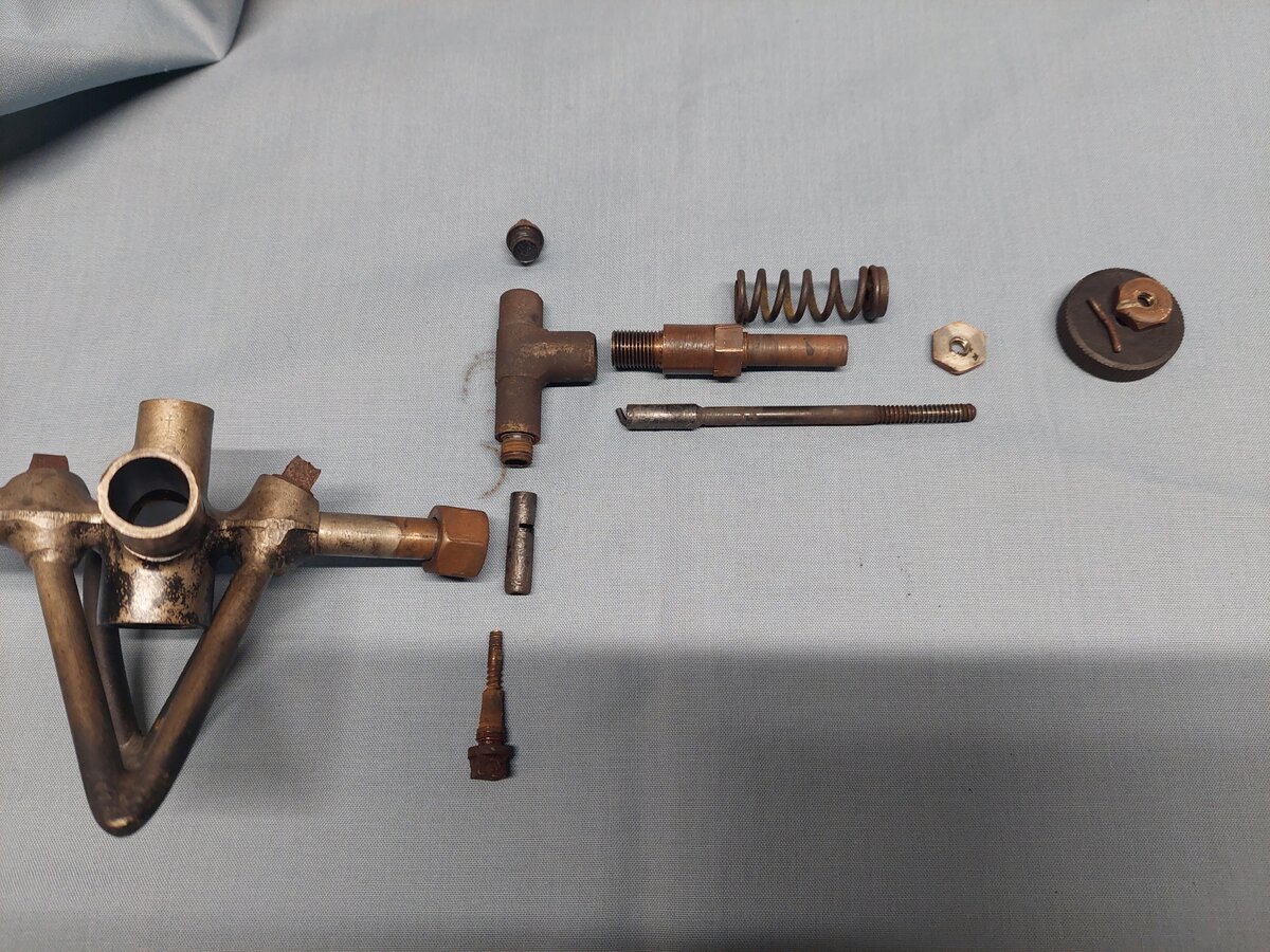

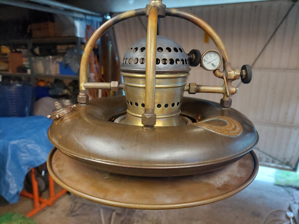

    Here is a very early kitson that has landed here to fettle. Not my lamp only here for some tlc. It is unusual as it has a inbuilt pricker mechanism not seen in later lamp or in adverts post 1915. Some pictures here of my initial stripping down nothing too scary but the jet and pricker will most likely give me some grief

    This is a truly old lamp which looks to be complete and in great condition except for the globe and its clamp perhaps. The earliest ad we know of with the four tube arms is from 1912 but by 1915 they were illustrating the same lamp with just two tube supports so this has to be pre WW1. ::Neil::

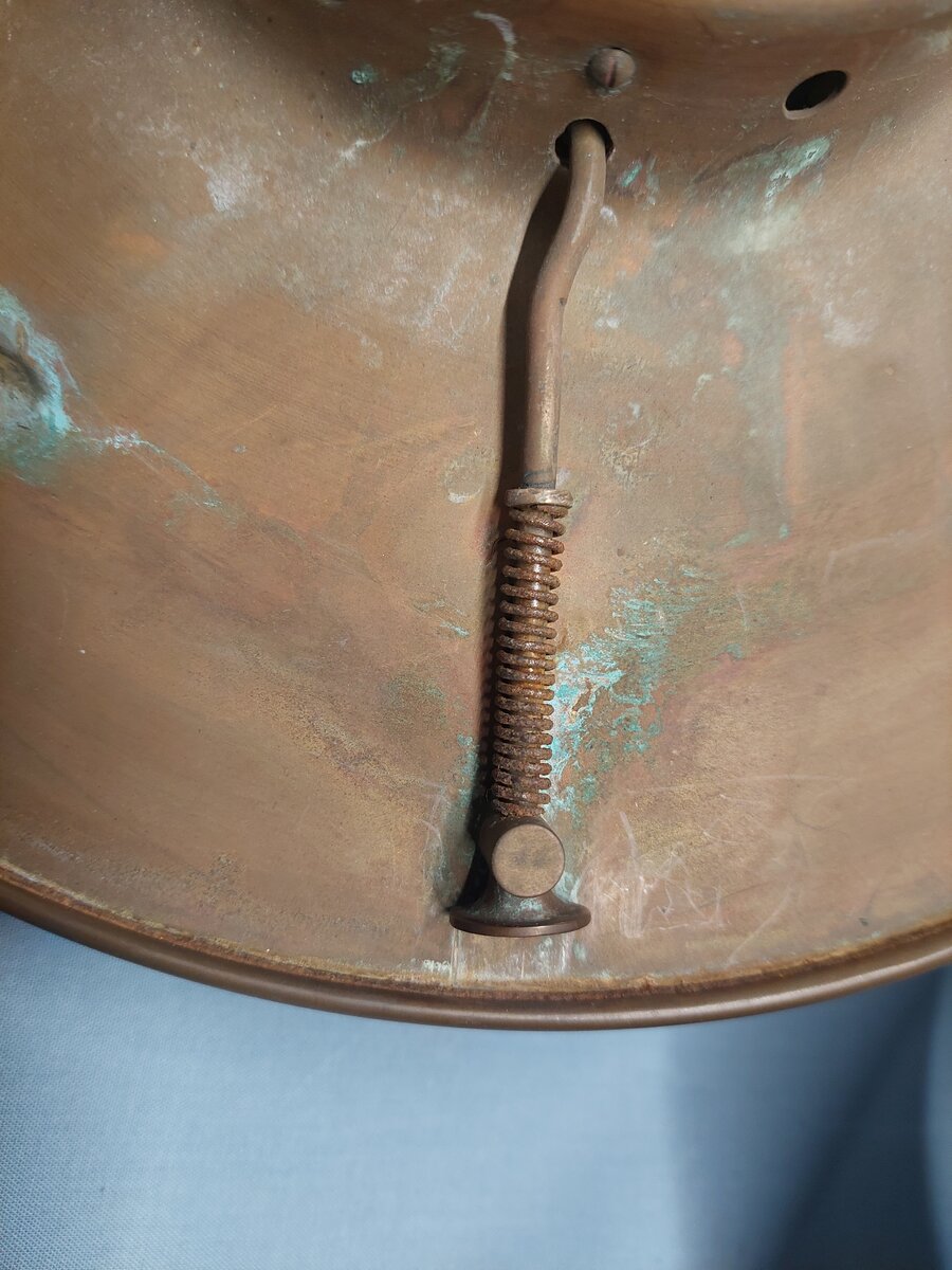

    Yes it's a fine old lamp this I think it's all original with it's nickel plate been taken off somehow. The plating can be seen on the spirit dish and the globe clamping system Neil. There are 2 fixed pegs and 1 spring loaded one not like the usual globe ring on later models.
    Had little time on it today but it was so cold in the garage I left it till tomorrow.
    Jet is rusted out way oversize and the pricker gone so that's a task for tomorrow rest of it looks really good for a lamp of this age. A previous owner has had it in bits and cleaned it up some time ago but not damaged it in any way unlike a lot of these old lamps so high hopes of a runner here watch this space

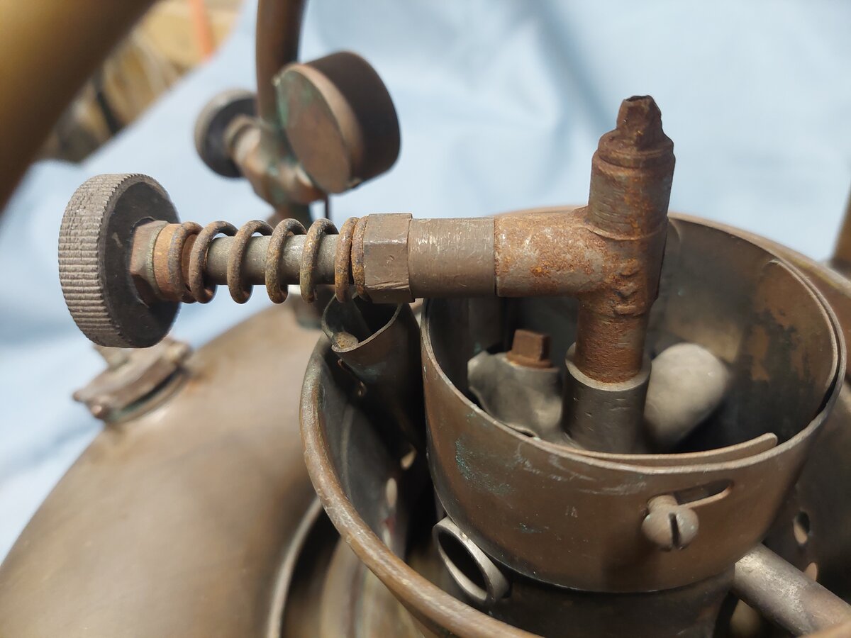

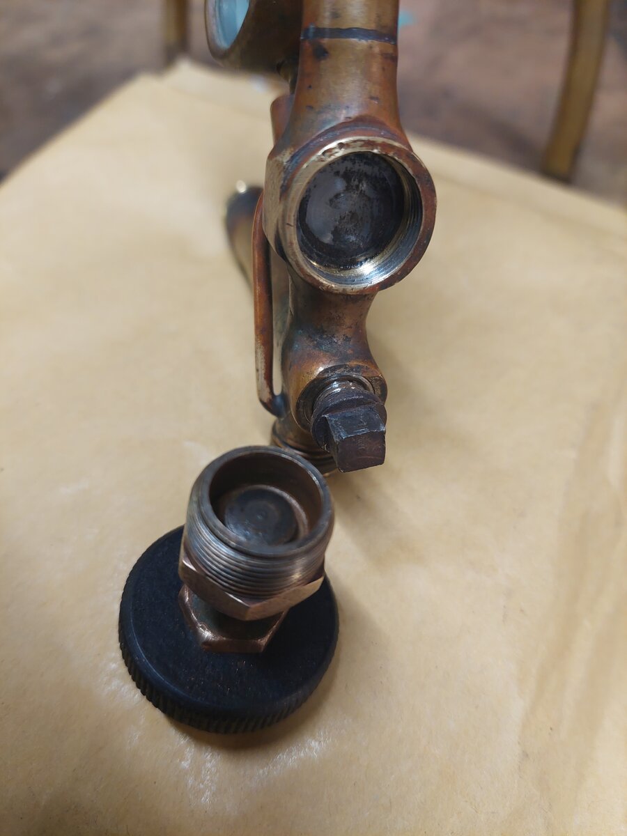

    Had a play with this lamp yesterday made a new pricker and swapped the jet for one that looked in better shape.
    The nrv looks strange cap soldered on surely that cannot be right now this should have set alarm bells ringing but it didn't
    Any way reassembled the lamp felt pretty good about how it had gone but thought I would leave it till this morning for a light up. 20221212_155958.jpg
    Nrv ?
    Shut off valve is different to what I have seen before too
    The control knob presses on a metal diaphragm to shut fuel off bit odd but works well

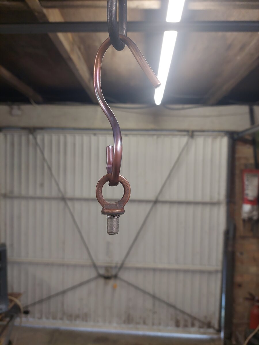

    Next thing bang the whole bloody lamp crashes to the concrete garage floor give me a shock.

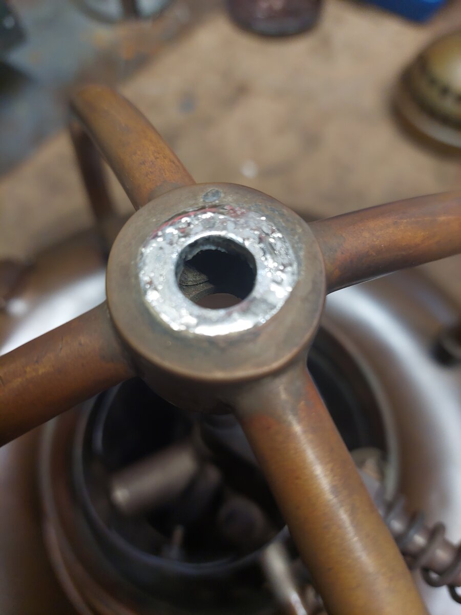

    Now someone a previous owner must have soft soldered the top ring to the hanging frame now thats a new one on me never saw of that coming.
    20221213_104131.jpg 20221213_104122.jpg 20221213_104122.jpg 20221213_104233.jpg
    So spent today repairing the carnage as best I could have another go tomorrow

    Ouch ! I hope the carnage wasn't too severe. A good job you have the skill to sort it out.
    It looks like that top ring started life as an eyebolt and someone sheared the end off trying to loosen the nut.

    This old stuff catches you out at times henry, yeh I reckon it was a eye bolt now it's silvered soldered to the frame spent 5 hours doing repairs straightening pipes fixing broken metal most of the damage was inside the cowls so it won't be seen , still I could have done without it.

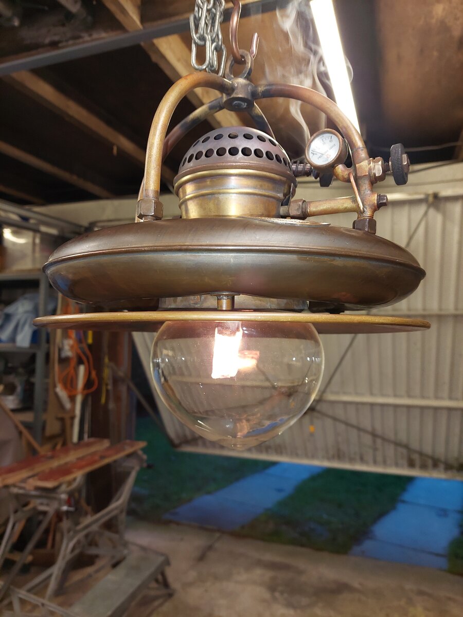

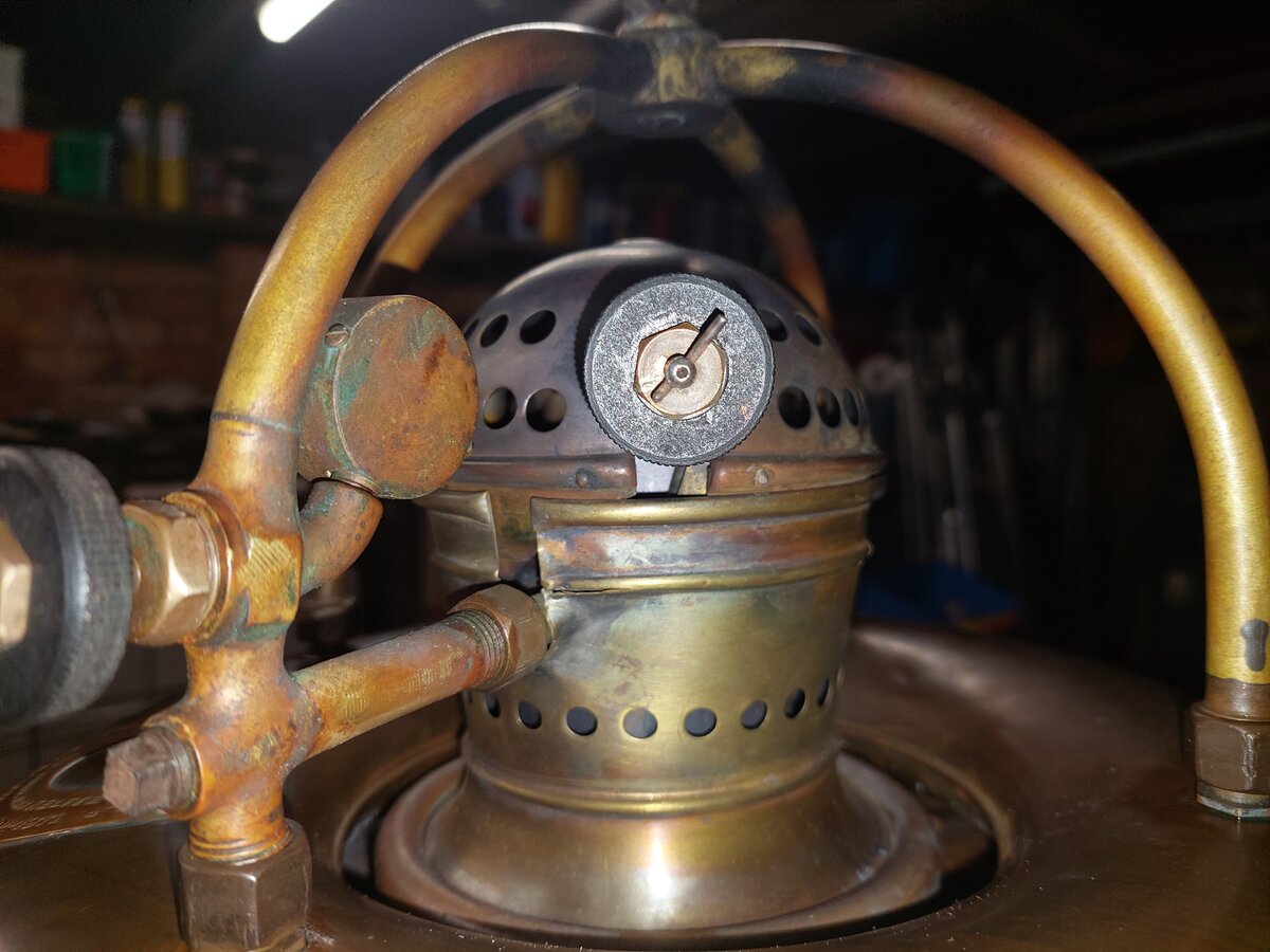

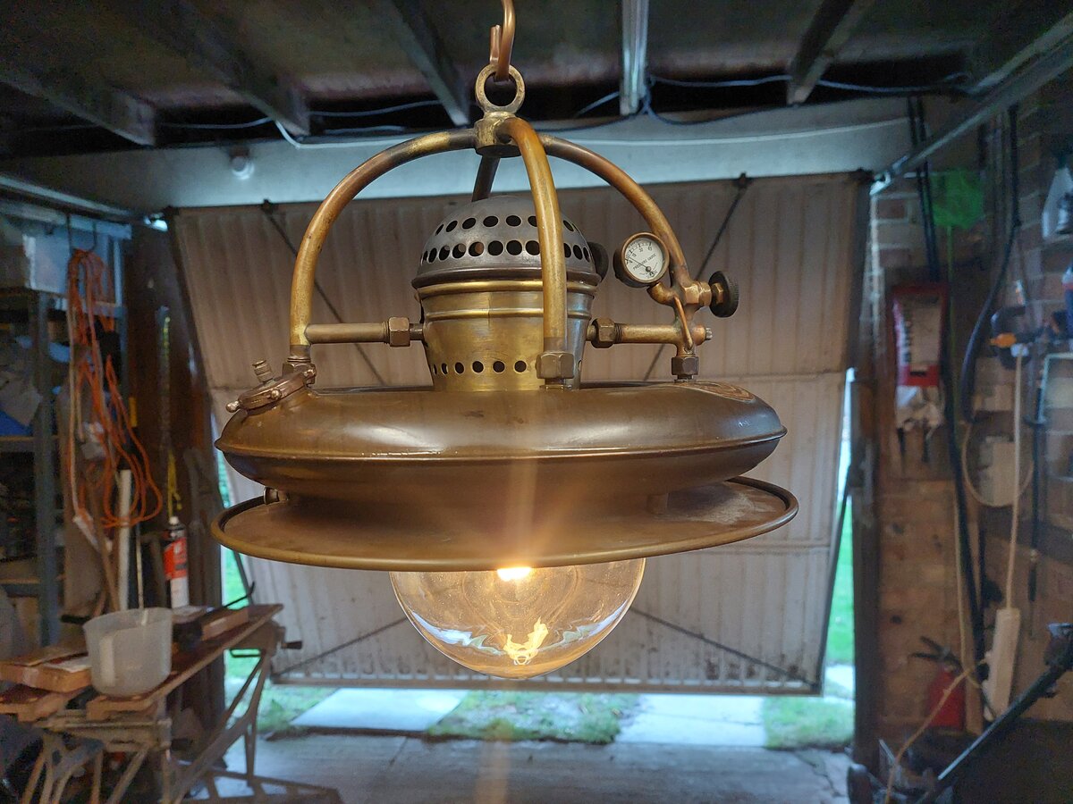

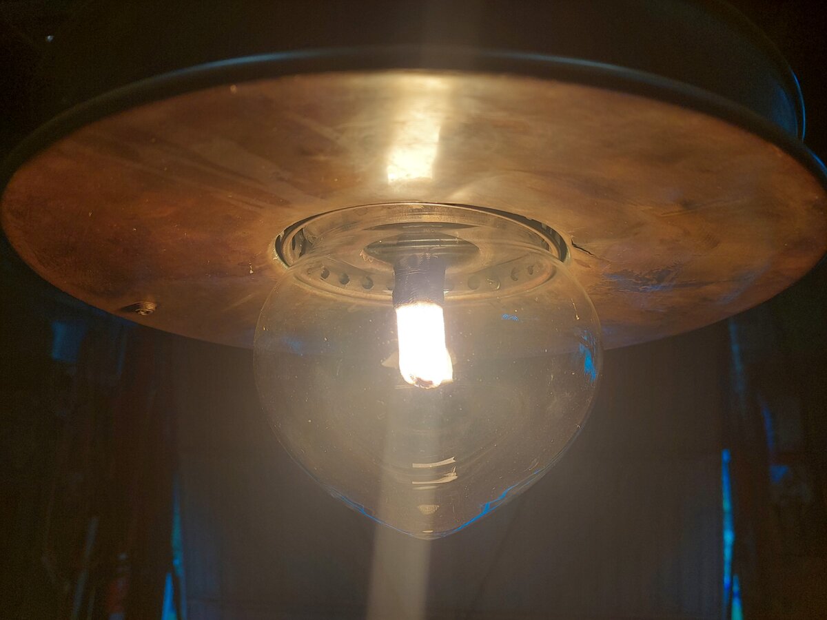

    Well finally managed to sort this donut out at last. All repairs done and it runs quite well for a lamp of this age. Had problems with the jet and pricker as usual with old lamps.
    The shaft that moves the pricker smoked really bad so I put loads of copper slip on the shaft and once it got hot it appears to have helped the smoking reduce.
    One nice little touch on this lamp is the pin on the pricker control knob it shows the position of the pricker before you light it good idea.
