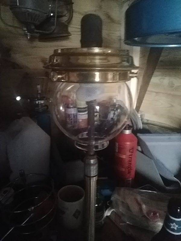

    Hi, here is my X246B converted to a lamp using parts from Ebay. The seller supplies everything needed to carry this out. It works very well. I also have bought seal kits from the forums sponsors
    16717172972898948039726682648641.jpg 1671717333291757272183905968336.jpg 16717173624428882387896096150875.jpg 16717174240167273152183365635510.jpg

  2. Fireexit1 United Kingdom
    3,430
    I always wondered if they were any good. I just might treat myself...:thumbup:

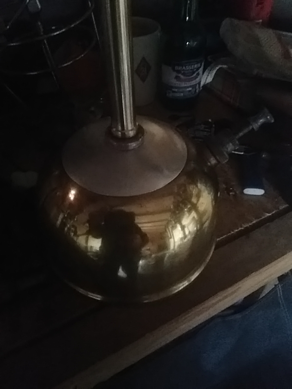

  5. Norman Murray
    Norman Murray United Kingdom Subscriber
    Dec 21, 2022
    47
    Scotland
    Yes. I'm having a bit of bother sealing the extension to the base though. There's a slight weep when I use it.
  6. presscall
    1,528
    Lancashire, UK
    Thread sealant - Loctite Blue is medium strength and threads can be unscrewed if necessary without too much difficulty.
  7. Norman Murray
    Dec 21, 2022
    47
    Scotland
    I thought about a copper washer. What do you think?
  8. X246A
    1,216
    Norfolk, England
    I am surprised the standard washer doesn’t seal well as with the control cock. I have never used a copper washer for anything previously so am unable to offer an opinion, however I’ll be interested to hear your feedback. I was going to suggest a small amount of “gas” pterodactyl tape around the thread.
    Regards, Jeremy
  9. Norman Murray
    Dec 21, 2022
    47
    Scotland
    I'll try a copper or fibre washer. If no joy, then I'll give the Loctite a try.
  10. podbros United Kingdom
    3,455
    Hi Norman
    I have not seen one of these kits close up but I changed the seals on a TL120a which has a similar arrangement with the removable stem to yours and I found that there were two control tap washers in there so maybe try that first?
    regards
    pb
    edit ; I spoke to @Henry Plews about it and he thought that Tilley may have originally had 1 washer but thicker than normal
    I may have made up some of my own washers out of different thickness viton and mixed and matched until it felt ok.. it was over a yr ago now
