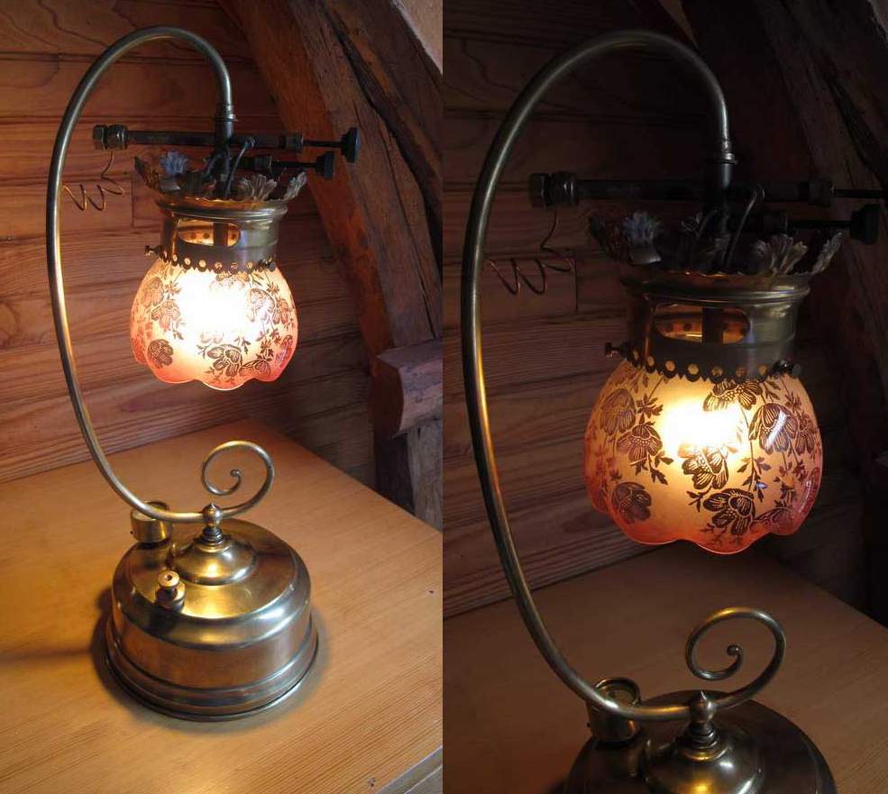

    hello all,
    Here is the lilor in its original configuration with a "bec LOR" burner.
    Unfortunately, I have not been able to light it because the fuel line is clogged.
    A little effort is needed, but we're getting there
  24. Conny C
    Conny C Sweden Subscriber
    774
    Michel, what a beauty :thumbup: ! Looks better now with an all Lilor configuration. That lamp is now high on my wish list!
    /Conny

  26. Michel
    Michel Subscriber
    Jan 26, 2011
    1,182
    56 France
    thank you guys
    But nobody deserves to die for a lamp, even for this beautiful Lilor;-)
    Now I'll try turning on the beauty to show you the flowered lampshade
  27. Michel
    Michel Subscriber
    Jan 26, 2011
    1,182
    56 France
    I was lucky, the wire was only clogged. Some acid and a syringe have done the job !
    here is the light :-({|= and the flowers
  28. podly
    Dec 9, 2012
    106
    It is awesome! I really hope to find similar one some day :)
  29. norf
    Feb 29, 2012
    280
    beautiful lamp, never seen one like it ,thanks for posting.
  30. Claus C
    Dec 18, 2012
    1,788
    Very very cute :thumbup:
    Claus C
