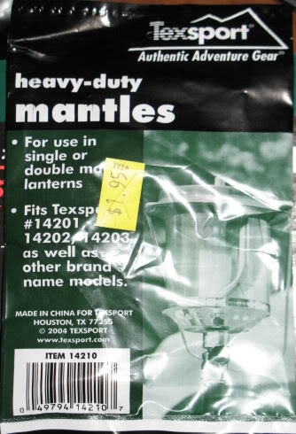

  2. Doron Papo
    Doron Papo
    Dec 2, 2010
    258
    Use Coleman #21 for that
    or any 300cp mantles.
    I use texport brand and they are quite good as a coleman #21 replacements

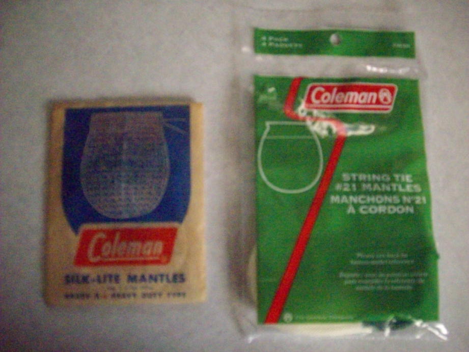

  4. furry flivver
    116
    Ariz.
    Hi all: I use 21's on on all Coleman lanterns and lamps except the small backpacking verity. (and kero Coleman's as I have never owned one.) This post aroused my curiosity as I have used the 21 style mantle on my Coleman lamps and lanterns since the late 50's as a boy. I went out to my mantle stash and examined "nos" mantles in their original packaging from the 20's to a package I bought three days ago.( the modern package list both single and double mantle Lanterns/lamps as correct for the #21) They all are the same size as the modern 21's and the older ones 60's back to 20's do not have a model number on them, apparently in those days Coleman thought one size fit all before the advent of the small backpacking lanterns and the in-between sizes made since. I recently saw a post on this site regarding thorium (radioactivity) in older mantles. I have long been aware of this but never tested mine. I shall do so and post it on that thread as soon as I get my ancient Geiger counter running, apparently after years of non use, unlike old Coleman products it refuses to run. Mike...
    old(50's?) and just purchased
