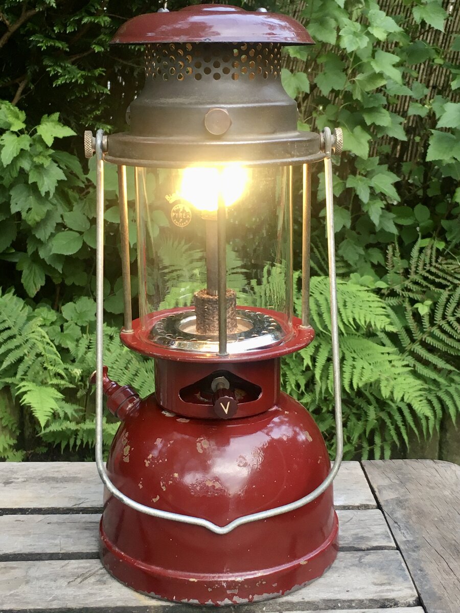

    Not so grand a ‘time capsule’ find as Jeremy’s house clearance Primus 1050 but this Bialaddin had immediate appeal as unrestored, put away and forgotten about maybe, but dry stored and not decayed.
    ‘Honest’ is the term often used to describe a bygone in this condition I think.

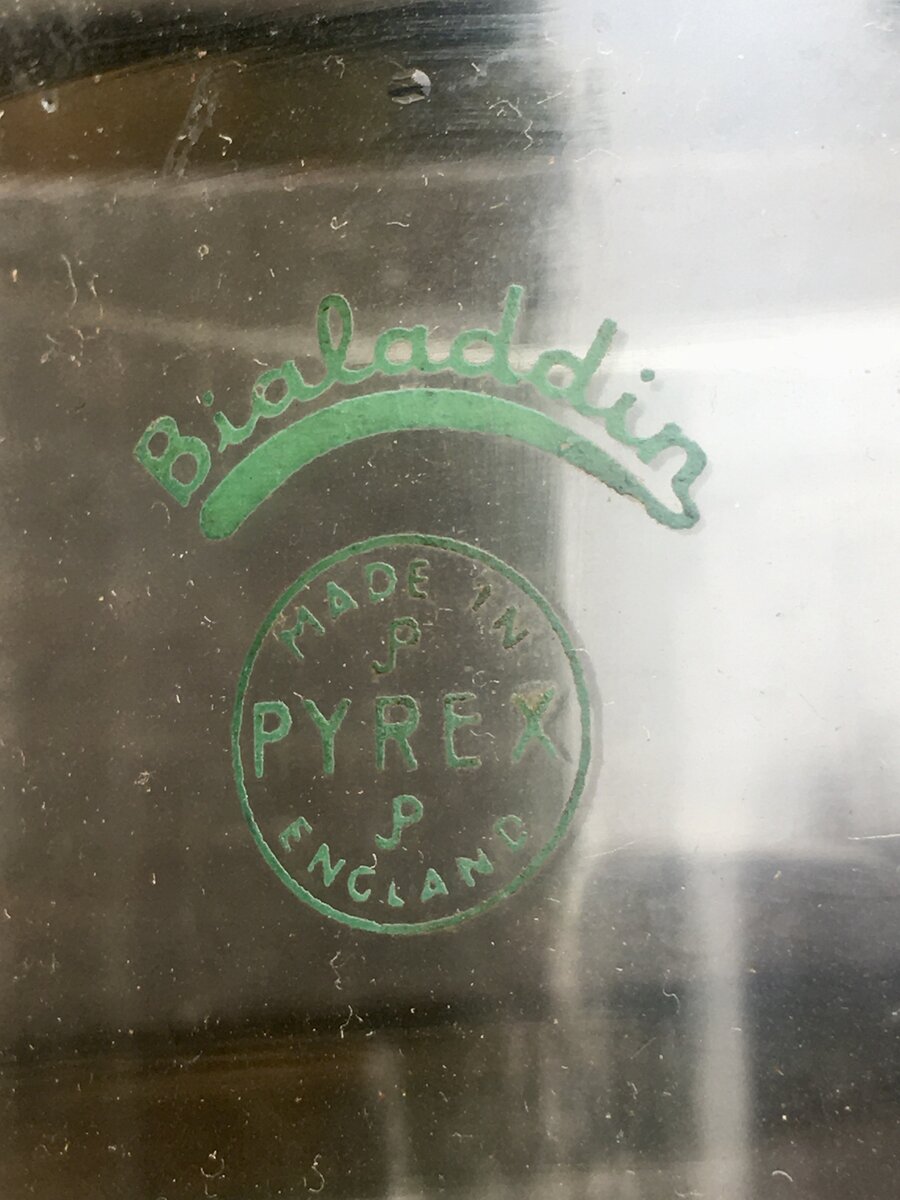

    Globe is sound and original.

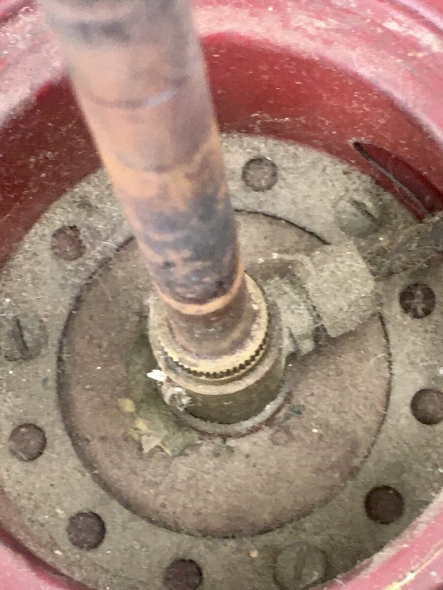

    Dust, cobwebs, screw slots not mangled - encouraging details.

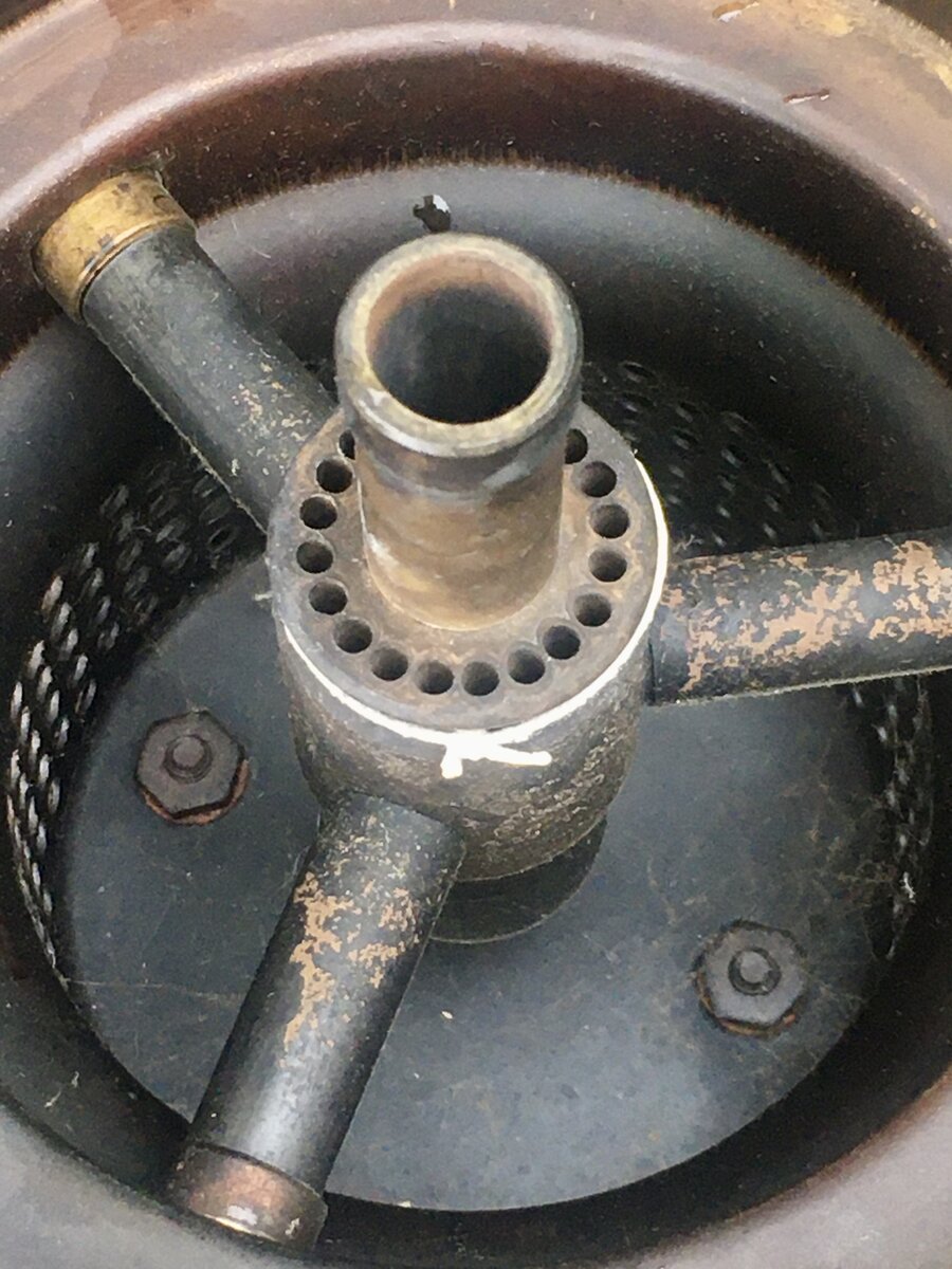

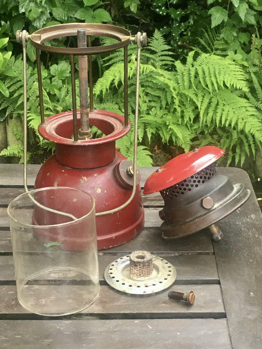

    More dust and cobwebs. Those nuts are going to unscrew, no bother. The hexagonal air buttons unscrewed effortlessly. Remains of its last mantle still present.

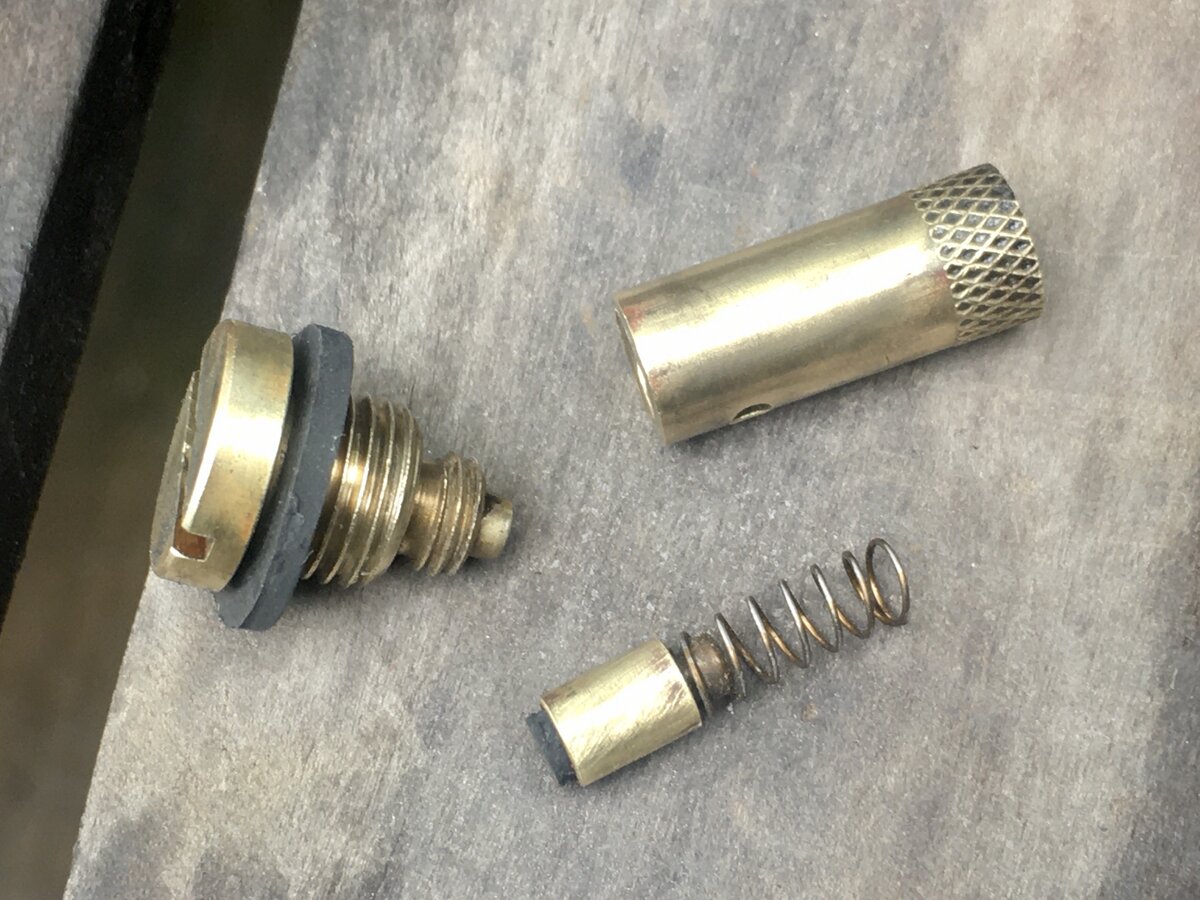

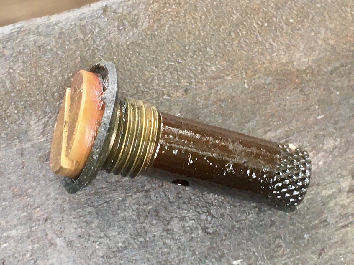

    Non-return valve covered in varnish.
    I cleaned that off, but more importantly off the internal bore of the NRV and the seal ‘pip’ holder to ensure free movement.

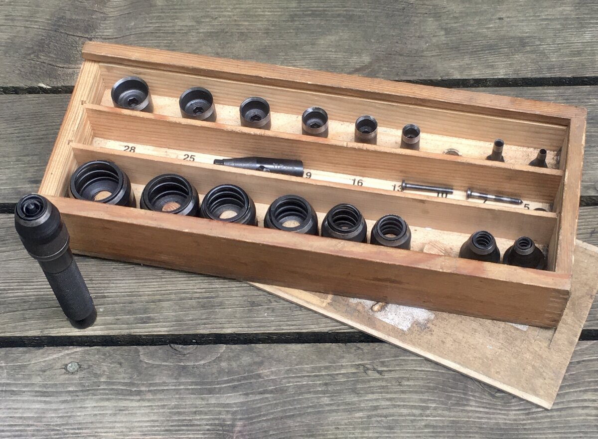

    New NRV-to-pump seal stamped out of viton sheet, a job for my Måby punch set.
    New NRV pip too.

    A fine fettling project!:thumbup:
  3. Gary Waller
    Gary Waller Subscriber
    Apr 3, 2018
    508
    The hood looks really good, probably not had a lot of use.
  4. ColinG
    3,443
    That's a very satisfying find! Lovely to see the original paint in such good condition!

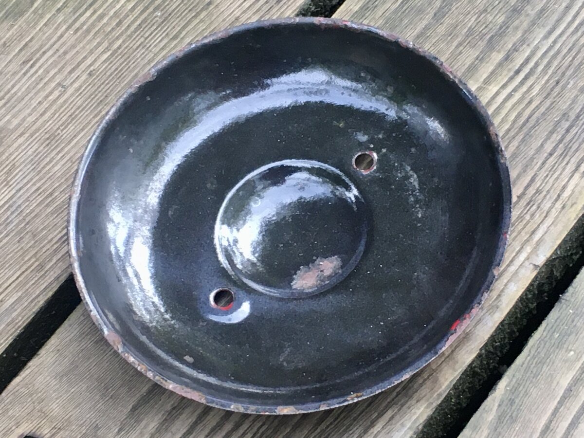

    Yes, pretty good, a patch of enamel gone though.
    Good backing enamel.

    Fettle completed HERE, lantern posted in the Stove Reference Gallery.
  7. podbros
    1,824
    Wirral
    Nice!
    I had an idea that these were black on the inside/underneath so that confirms it :thumbup:

    Great job John, and a reference for me when i get that maroon fount version of mine sorted
  10. Henry Plews
    1,947
    The orientation of the needle control and handle is not only practical but adds symmetry as well. I find it very pleasing to the eye.

    Yes, they're about still...

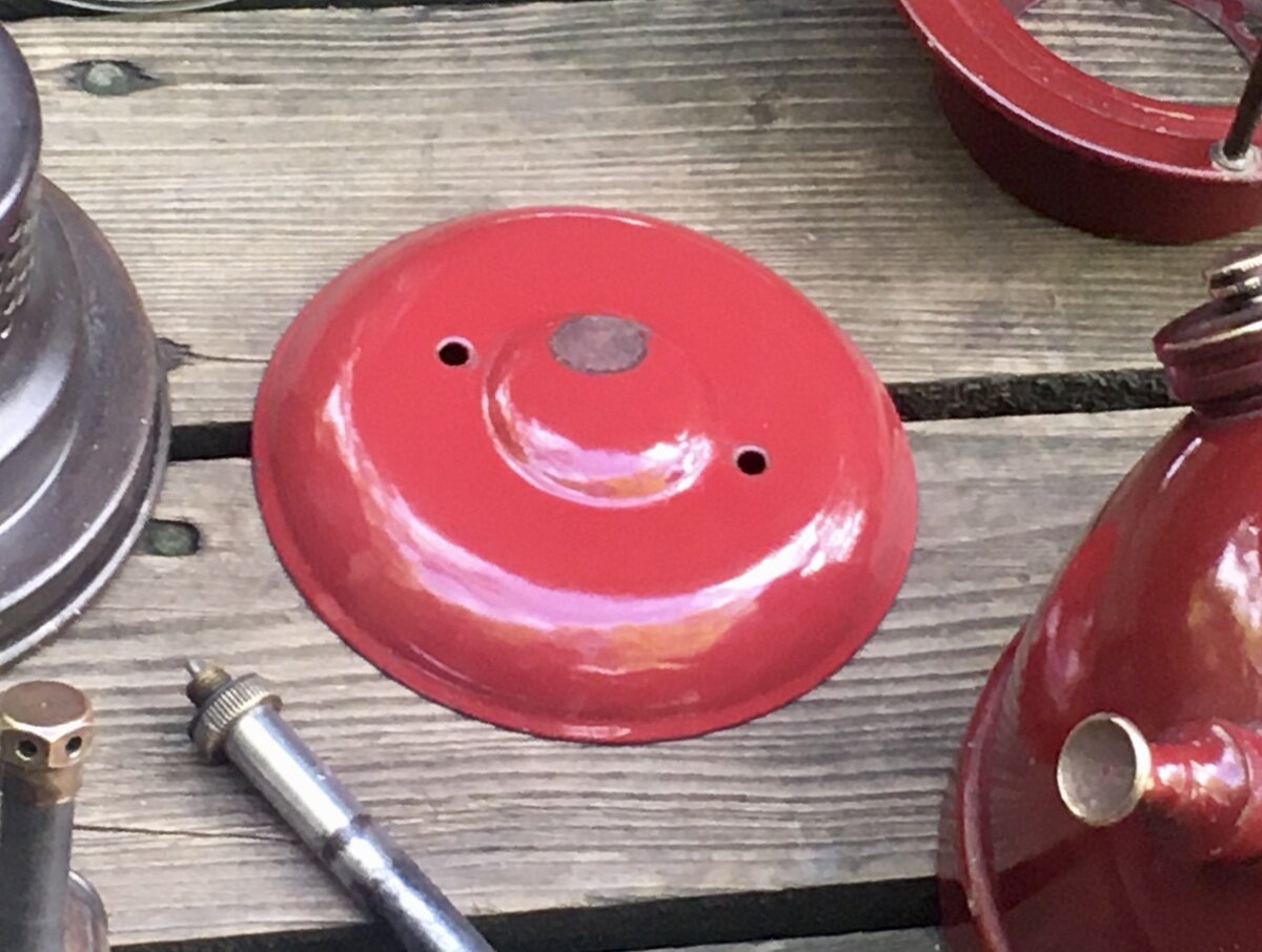

    1946-51 Bialaddin 300X
    ...even if the seller wasn't quite as honest as the lantern! :doh::)
    John, are the two patches of enamel loss on either side of the hood in the same place? :-k
  13. presscall
    619
    Lancashire, UK
    @Gareth Shepherd Thanks Gareth!
    @David Shouksmith Yes, I’d previously read your post on that one and the use of a shagpile carpet by the seller to mask the loss of paint around the font base rim!
    Correct, David. I suppose a breach in the enamel top surface allowed water penetration and rust taking hold would lift more enamel top and bottom.
    I’m tempted to seek a better colour match of enamel powder than the red I already have and have a go with the tripod-and-blowtorch enamelling technique. Not so much for the appearance, but it’d be good to weatherproof the patch. Should be easier to do the detached cap, if only for access, than the caps of the one-piece hoods I’ve ‘torched’ so far.
    John

  20. David Shouksmith
    8,074
    I thought of two other possible explanations:-
    1. There was some impurity/inclusion in the metal there, or;
    2. surface contamination of the metal e.g. the hood top fell on the floor and someone picked it up with bare finger and thumb
    Either of these -as well as your explanation, of course - might result in the enamel failing to adhere to the metal substrate
    Whatever, it's strange in my experience to have enamel loss at exactly the same place on both sides of the metal...
  21. podbros
    1,824
    Wirral
    Could it have had an impact that was enough to crack the enamel but not enough to show?
    But a few light ups later...?
  22. David Shouksmith
    8,074
    Thanks, Tony. That kind of thing is ubiquitous on Bialaddins which have the two-piece, welded hoods. I presume the weld metal and substrate metal have different expansivity (is that a word or have I just made it up?) so when they heat up they expand by slightly different amounts which sets up stresses in the enamel. This then cracks, water gets in, rusting starts and the enamel comes off. I suspect that's why W&B went on to using (true) one-piece hoods...
    IIRC, one of my less-than-superb Superbs has four such areas... :doh:
