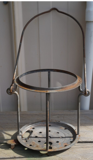

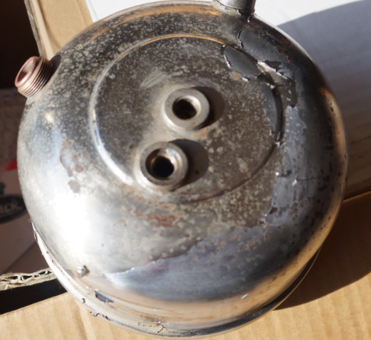

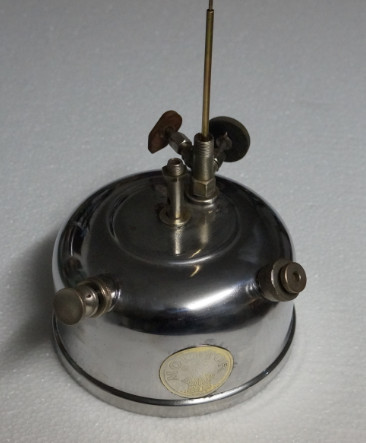

    I had to do something with this lantern as it was looking in very rough shape. Being mostly made of steel meant that rust was becoming problematic. I'd previously fettled this lantern some 18 months ago and I was quite shocked at how far it had deteriorated since that last fettle. I kept the lantern as close to factory as I could when doing the previous fettle but this time, I had to cover the steel surfaces such as the cage and bail arm. I chose silver metal cover paint that is heat resistant to 320F for the cage bottom and top. To break up the gaudy silver paint I used a glossy black metal cover paint that is also heat resistant to 320F.
    I decided to remove the chrome from the fount. It was in very poor condition with lots of bubbling and some spots were missing the chrome. I wire wheeled the chrome off and as I was sanding with 240 grit wet'n'dry paper, it dawned on me that the fount steel was of high quality. I decided to polish the steel and after a lot of work, 240, 400, 1,000 and 2,000 grit paper then the bench polisher, it ended up looking more than decent.
    The hood was as black as it could be with burnt on grime. 3 soaks in full strength vinegar with 0000 steel wool polishes inbetween and after, then some Mothers polish, the hood came up incredibly well. I didn't think there was much hope of salvaging the nickel but with such a good job that was done at the factory it made it possible to still have a shiny nickel plated hood.
    I didn't take too many photos prior to the fetlle which is a shame because the difference between then and now is stark. I think it was a good choice to paint the bail arm and cage supports black because it breaks up the bright silver paint. Yes I know that isn't how it left the factory, I was just doing the best I could.
    All in all the lantern turned out to be a most satisfying result.

    Matt, that fount has been polished to mirror finish, and the vent came up superb. A fine restoration indeed. Well done,

    Yes, it did have prior to fettling now it is positive shut off. :)
    It would need a jet reduction to run on petrol. The Model 100 is a petrol lamp, that has much the same burner.

    Malcolm, it certainly is amazing how well the fount came up. I have purposely not sealed the tank because I want to see how well the metal copes. I'll end up re-polishing the fount then clear coating it. I am intrigued to see just how good this metal is.
    Martin, correct, it looked very shabby. I found it interesting that both chrome and nickel was used in the construction of this lamp. There were telling differences between the quality of nickel plating too. I simply don't believe all the parts were manufactured under the one roof.
