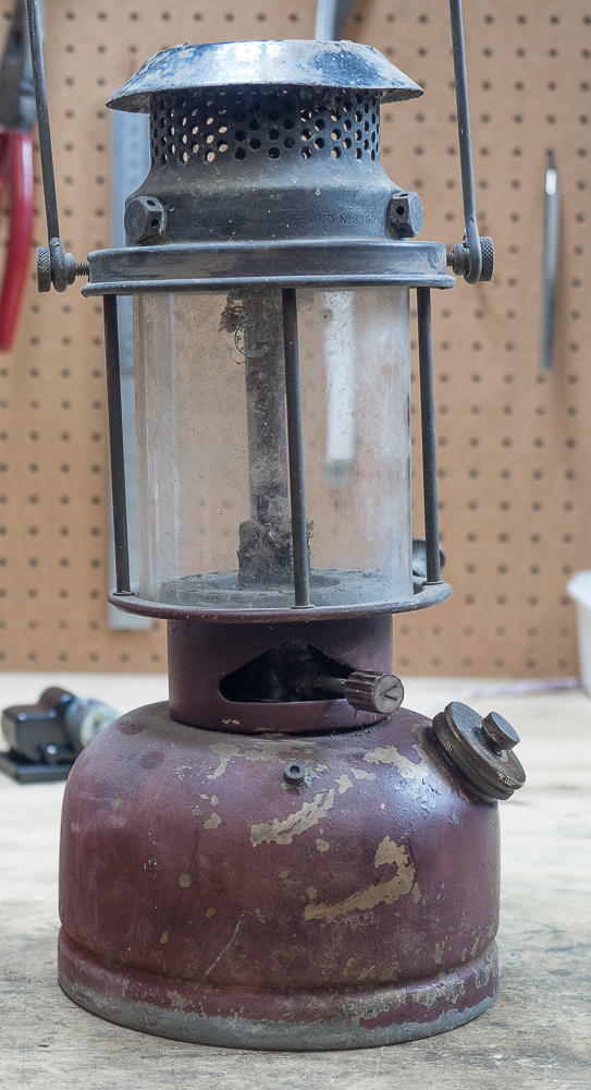

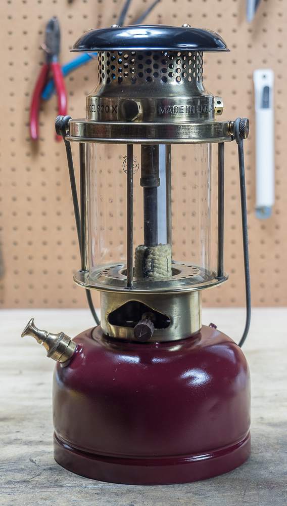

    I reported the acquisition of a Vapalux 300X.
    Well, it is very nearly sorted so the before and after shots are below. I know someone will point out the (incorrect) replacement hood top, but that is a temporary feature until I work out the best way of saving the original. It is of course stove enameled but rough, so I propose to abrade it to provide a key then spray it with VHT exhaust paint. Has anyone tried this? If so what was the outcome?

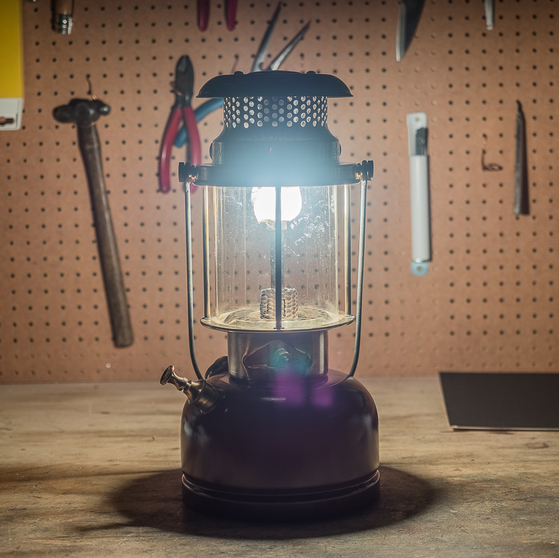

    This is its first firing in over fifty years.
    Only one issue after pressurising; a leak from the control cock spindle. Now sorted and all well.

    Beautiful job!! Looks like you swapped the top on this one. (?) :D/:thumbup: Am I seeing things?:-k

    Not seeing things. As said in my post above, the original top is in a bad way cosmetically. I want to restore it by abrading the stove enameling and spraying with VHT exhaust paint. Any idea if this is viable?

    I'm not sure if it will work. You can imagine the heat buildup on the factory made top with the enamel coating. They won't last, so it's hard to say if the top would hold up if painted with high heat paint. :-k

    As to VHT paint, and even the paint used on disc brakes may not make the grade. I have tried a VHT paint on a Tilley hood and it deteriorated after only a few uses.
    In my experience, the only permanent solutions are either restoring the original enough to get by, finding another original or a reproduction hood top perhaps from our Korean friends on the bay of evil.

    R100, congratulations on this very nice - and tight - looking lamp. Given the new finish, the new black top blends in rather well without sticking out, and since enamelled, could be used in anger.
    Mind, soon this rounded top became a familiar profile, so your lamp has a classical correct look, even if not fully period correct.
    The advantage of these simple tops is that they are temperature stable unlike the spotwelded two-part tops.
    There are many 'heat resisting' paints but none are 'heat proof' when it comes to these tops.
    Best to keep the painted ones for static display.

    No paint can survive the temperatures pressure lamp hoods have to endure no matter what they might say on the tin. A new original (if you can find one) or a modern repro are your only real options... or living with the original and enjoying the aged look.
