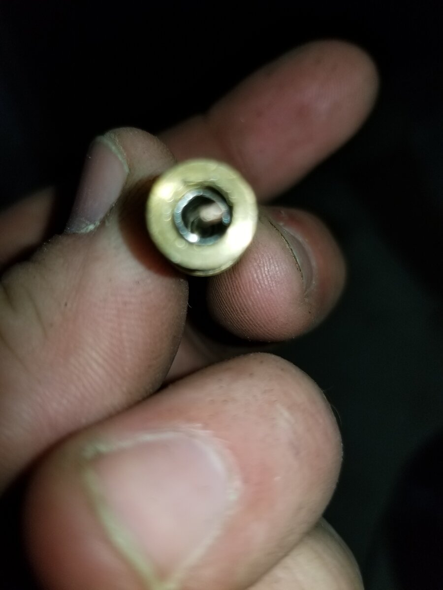

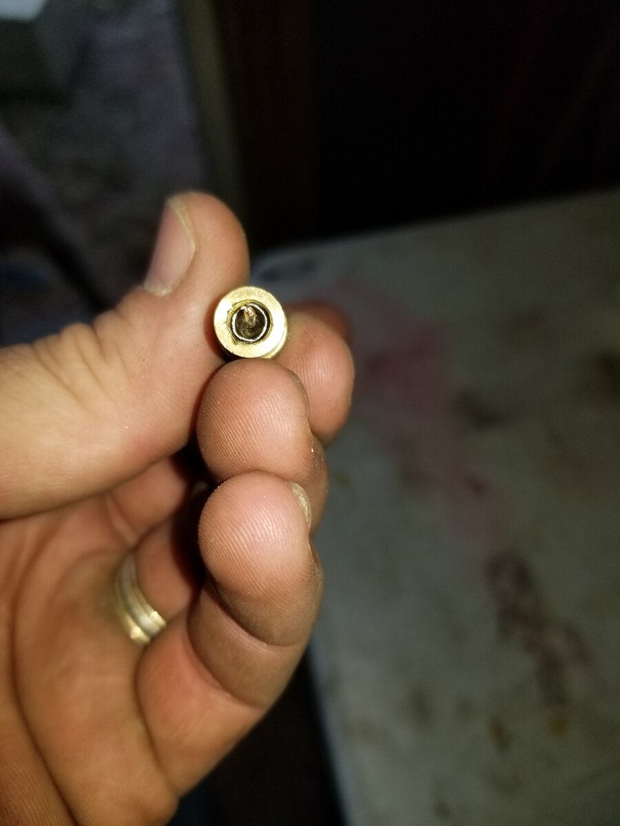

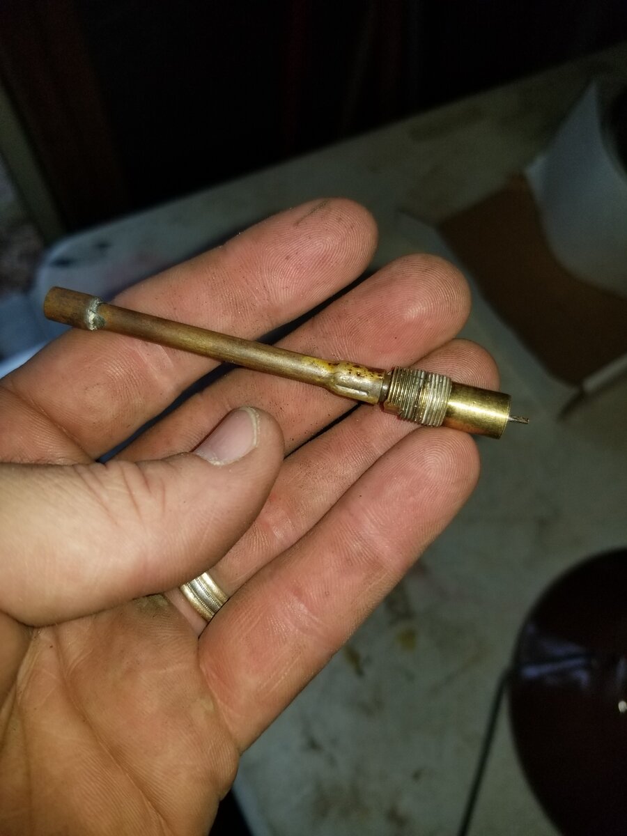

    I'm still having trouble getting this a part. Is the Schrader valve down in there. Hopefully you can see in the pics.

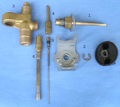

    Not sure if this helps: (found via search engine)
    Also - If you do not have a schrader tool, one might be helpful ?

    Part #5 in @Fireexit1's image is what you need to remove.
    If you haven't bought the replacement part yet it's available on www.oldcolemanparts.com. Search for valve core.
    If you heat up the fuel/air tube with a small propane torch that valve core should be easy to get completely out.

    I actually have ordered replacement parts however I did heat the unit up last night and got it out. Replaced the Schrader valve but still had no fire. I spend much time cleaning the generator which I believe was the main issue and I finally got it to work. I have a refurbed generator coming so I think I have it in the right direction. Thanks for the help and advice.
