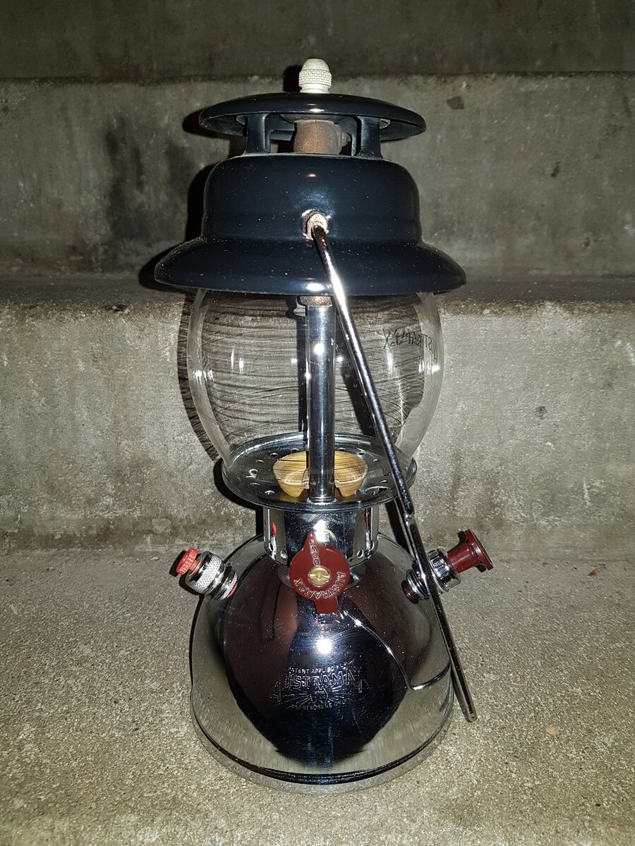

  4. Guenter Germany
    Jun 10, 2021
    5
    Thank you for your quick response! Here are two pictures from my Austramax.
  5. Tony Press
    7,573
    Guenter
    As discussed, I will go through my spares on a Sunday.
    Thanks for the photo; it’s the new type.

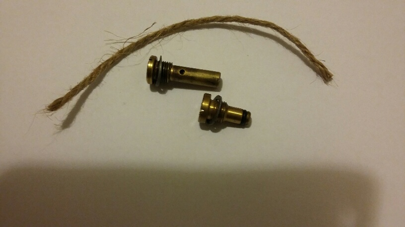

  8. Graham P
    Graham P Australia Subscriber
    Mar 3, 2012
    951
    Albury area NSW AUstralia
    The one I got out was the same late model as yours but has slightly earlier metal pressure release screw Pump non return valve is the screw with "O" ring type, appeared to be sealant paint (no washer) on mount
  9. Graham P
    Mar 3, 2012
    951
    I would think a couple of turns of (PTFE)

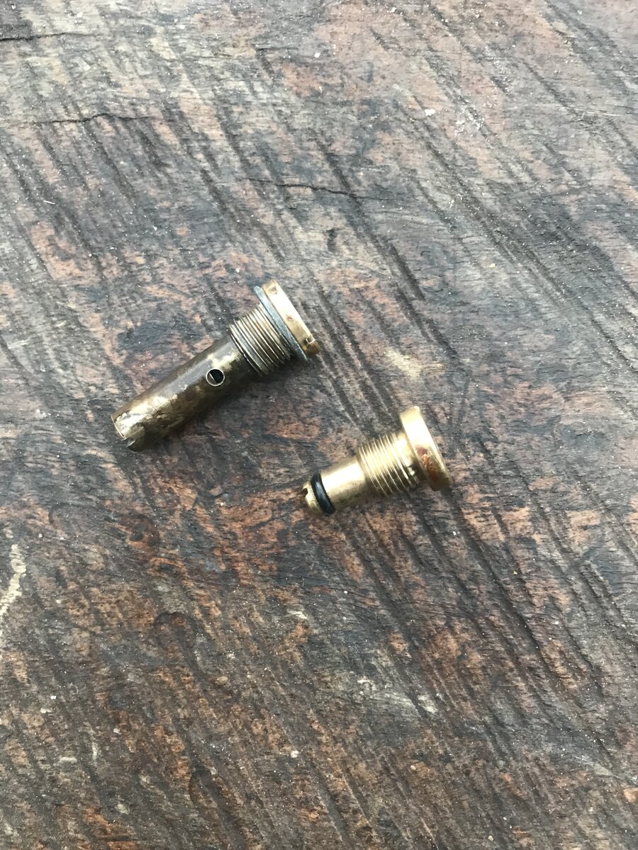

  10. Paul Aslanides
    Feb 9, 2020
    155
    Ferntree Gully, Melbourne.
    Austramax NRV.jpg Graham P Graham - With respect, may I point out that a few turns of tape around the thread won't do. That screw is well made - it has a thread 'runout' machined under the head, so that the inner face of the head will butt up hard against the face at the bottom of the pump tube, and not have the screw threadbound with a gap left between the end of the thread and the shoulder of the screw.
    If PTFE tape must be used, the trick is to cut a length, say 3, 4 inches, lay it flat on a clean surface and roll it across its length, with the palm of the hand, to create a 'string', or cord, which can then be wrapped around the runout groove. I've tried it, and in this application it doesn't work. So when you go to remove the nrv, the torn pieces of tape, small slivers of it, can disappear into the fount, with the potential of blocking the pickup tube etc.
    The lead washer used here is approx. 13 x 9.40 m/m and is a tight fit over the threads - it has to be screwed on until it drops free in the groove.
    Here's a pic of the old and the new valve, as appears above.
