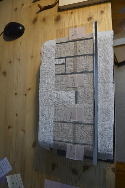

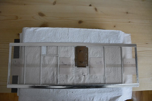

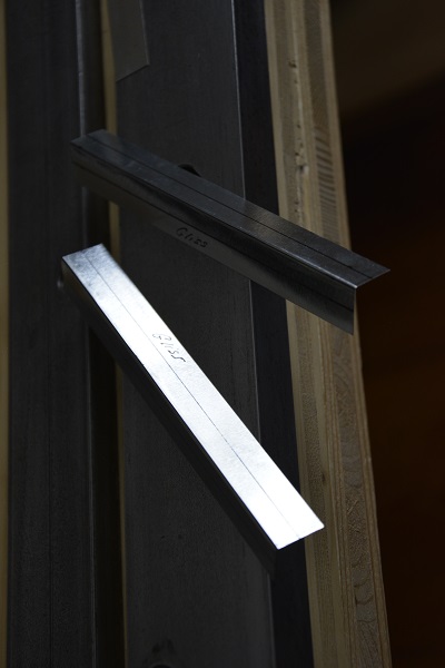

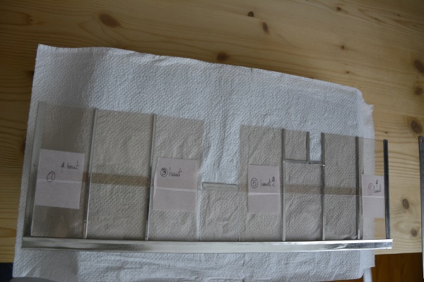

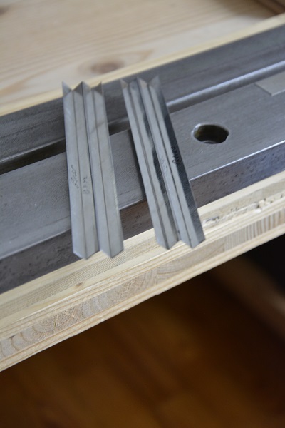

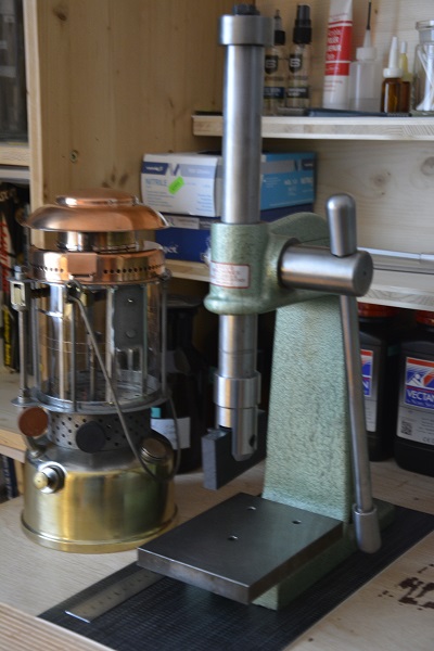

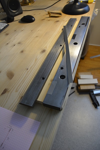

    A "new" handmade mica-globe for my 1934 Aladdin model A.
    Regards,
    Titoo. _DSCd299.jpg _DSCd298.jpg _DSCd297.jpg _DSCd296.jpg _DSCd295.jpg _DSCd294.jpg _DSCd293.jpg _DSCd291.jpg _DSCd290.jpg _DSCd289.jpg _DSCd288.jpg _DSCd287.jpg _DSCd286.jpg _DSCd285.jpg _DSCd284.jpg _DSCd283.jpg _DSCd282.jpg _DSCd281.jpg _DSCd280.jpg _DSCd279.jpg _DSCd278.jpg _DSCd276.jpg _DSCd275.jpg _DSCd274.jpg _DSCd273.jpg _DSCd272.jpg _DSCd271.jpg _DSCd270.jpg _DSCd269.jpg _DSCd267.jpg _DSCd266.jpg _DSCd265.jpg _DSCd264.jpg _DSCd263.jpg _DSCd262.jpg _DSCd261.jpg _DSCd260.jpg _DSCd259.jpg _DSCd258.jpg _DSCd256.jpg

  13. Titoo
    Titoo France Subscriber
    Jul 23, 2016
    454
    FRANCE: 25 Franche Comté
    Hi all,
    Many thanks for your interest.
    I will try to answer all questions.
    But i must express my strong feelings for this Aladdin Model A kerosene lantern.
    I bought it is a kind madness in the technical drawning lantern.
    I looked at Neil's Aladdin Model A in CPL gallery for a long time, then i hunted this Aladdin Model A kerosen lantern for several years......
    The day i found it was in the middle of the night around AM 3.00 and two weeks later it was on my desk....
    What a strange feeling to see her near me now.
    Answer to questions:
    I bought in the United States of America an old stock of mica for several globes.
    The color of this old stock is smoky gray brown with an incredible aged discoloration look it completes the soul of the lantern as on the first day.
    It should be noted that the old mica sheets is expensive around 90€ for one globe.
    The frame is made of mid steel tinned with 99,9 % pure tin for a thikness of 0,20 mm or 0,008" the sheets of 300 X 500 mm per set of 10 sheets.
    The supplier is here:Feuille de métal 500mm x 300mm x 0.2mm | RS Components

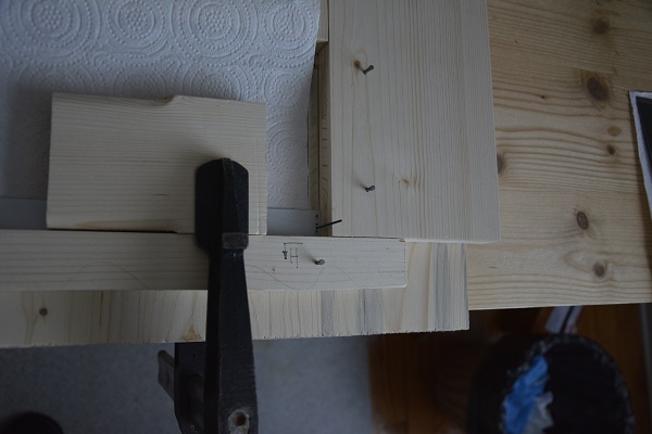

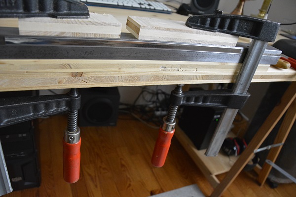

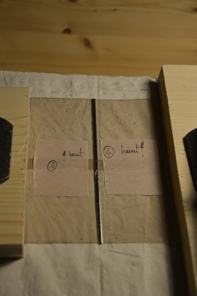

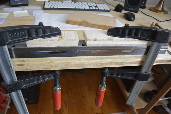

    Prepare the plan of the globe to rebuilt with great patience and delicacy, using the appropriate homemade tools.
    Regards,
    Titoo.
