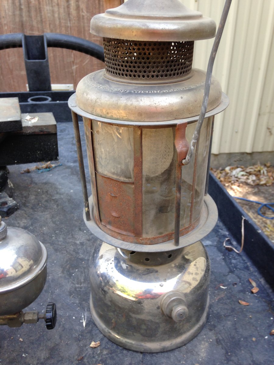

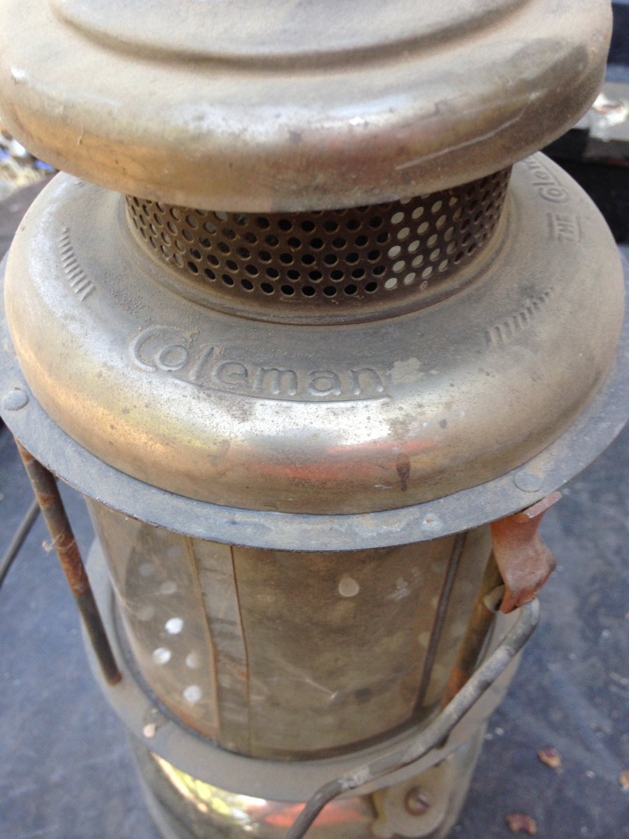

    I am new to this forum , crossed over from the stove side. This lamp is newly acquired. I would appreciate any and all info and advice regarding it. Lantern fettleing is new to me. Thanks in advance

    That's a fine old Coleman lantern which is well worth restoring and the link below shows relevant information.
    L427, LQ427, 2LQ

    Nice lantern. A 427 of some sort as the others have stated. Perfect as a buddy for an old stove. I've fettled a few of those you'll have lots of fun! :D

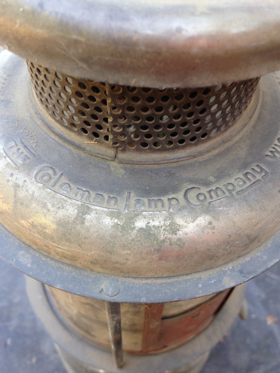

    I love the embossed lettering around the rim of the hood, it's an elegant touch!

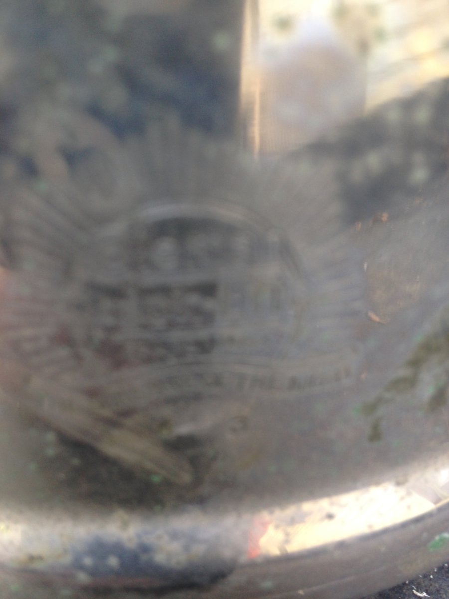

  13. Mackburner
    5,442
    Hard to read the date stamp but it looks like 6 3 which is March 1926 and would be correct for a later LQ427. Perhaps the best lamps Coleman ever made. Almost no moving parts so all it wants is a clean and then maybe a new pump leather and perhaps a generator and it will live again. If the steel base plate is not rusted they almost always fettle and work. ::Neil::

    N.E. Oregon, USA
    Thanks Neil, i oiled up the pump leather, it's still soft. it does need a new seal at the filler cap, I can't pump it up to enough pressure,but that's all I see it needing at this point. You are right, it's a great lamp!

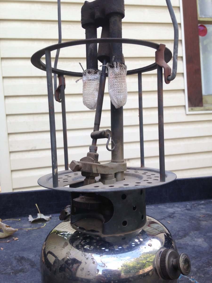

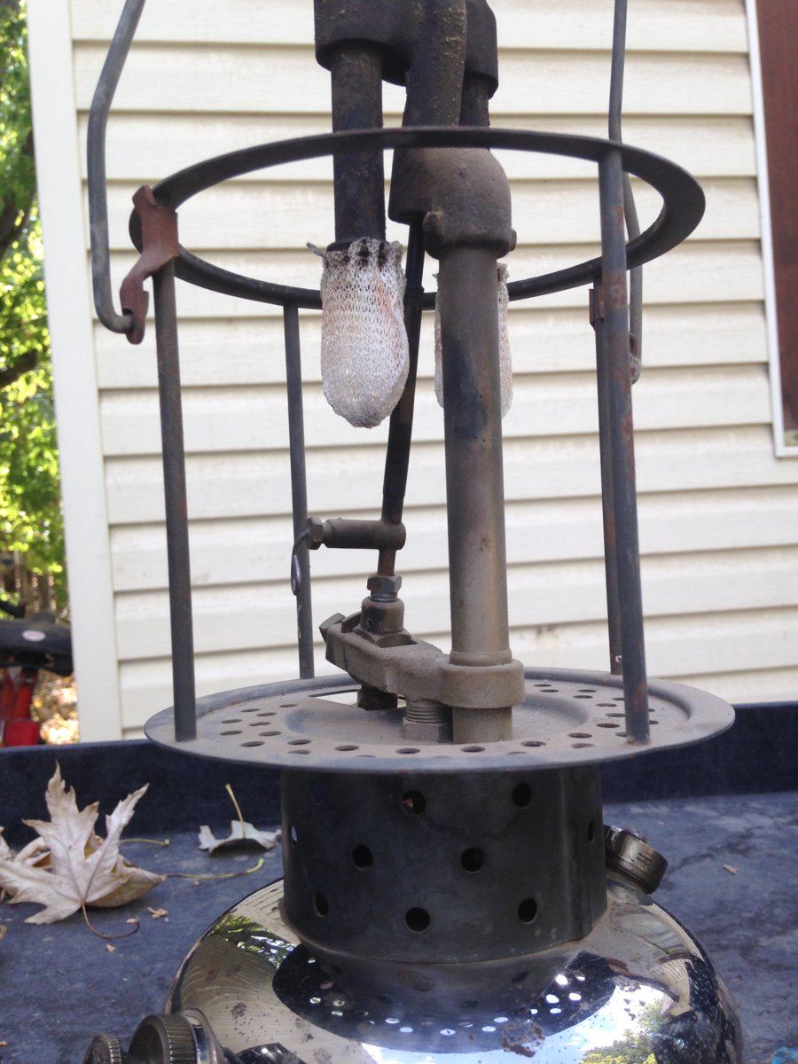

    is this not a slant type burner and frame support with an earlier vent? Hard to tell from the pics.

  17. IvanN
    IvanN Subscriber
    May 27, 2017
    19
    N.E. Oregon, USA
    @dwillie , I can get some better pics. I am not familiar with the differences. If you describe the angles you want to see I will try to get clear pics to post.
    Ivan
  18. Tony Press
    3,762
    @IvanN
    If you post photos from different angles of the lantern with the hood (vent) and chimney removed, you’ll answer @dwillie ’s question.
  19. IvanN
    IvanN Subscriber
    May 27, 2017
    19
    N.E. Oregon, USA
    Does this show?

  21. george
    438
    Probably L220, first of the instant lite types.

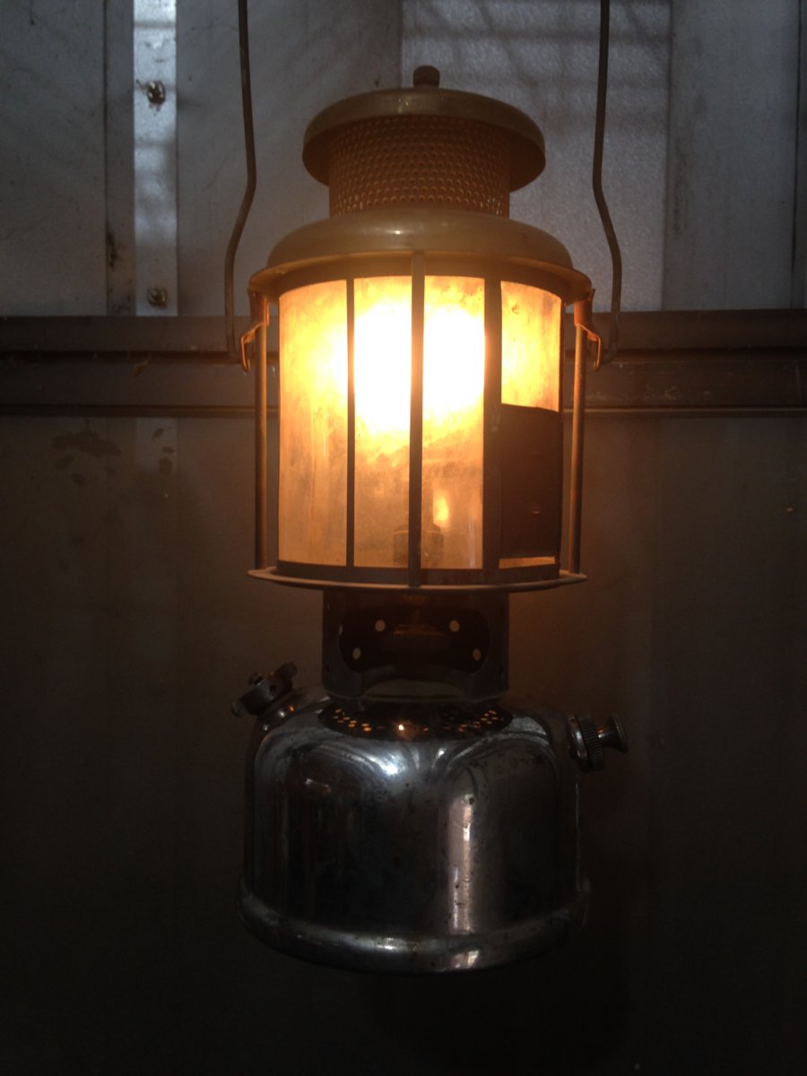

    With a new cap seal!Still needs a good cleaning:clap::clap:

    A slant? SWEET! Boy you jumped right in head first. That's a keeper and now with light! Very well done! :)
  25. Tony Press
    3,762
    Excellent, @IvanN!
    :thumbup:
  26. JonD
    JonD Subscriber
    Apr 15, 2014
    585
    Hertfordshire, England
    Something about those Mica panels and diffusion of the light.
    We like.
  27. Reese Williams
    Sep 5, 2012
    87
    Go to the Coleman Collectors Forum and do a search on "slant". These are essentially a transition lantern from one lighting style to another and are different than what came before and after. They have their own peculiarities with parts not seen in any other models. Well worth a restoration.

  29. Mackburner
    5,442
    Nice and uncommon thing. The slants were only made for maybe three years. Coleman model number was L220 or later just 220 but either way a great find. It is an odd burner/fuel feed and they can be temperamental to light. I remember Fil Graff and I running a table lamp with this burner some years back and it took about half an hour before it settled and ran correctly. Sweet thing though in the end. ::Neil::
  30. Akeepsake
    Akeepsake Subscriber
    Jan 11, 2016
    161
    From what I know yours is the earlier L220 as it has the finely ribbed valve wheel
    These were made to hold the automatic tip cleaning rod which came with correct T88 generator
    When the valve was closed the pricker did its job in the jet an when it was open it cleared the jet
    T88s are not made anymore but there are substitutes
