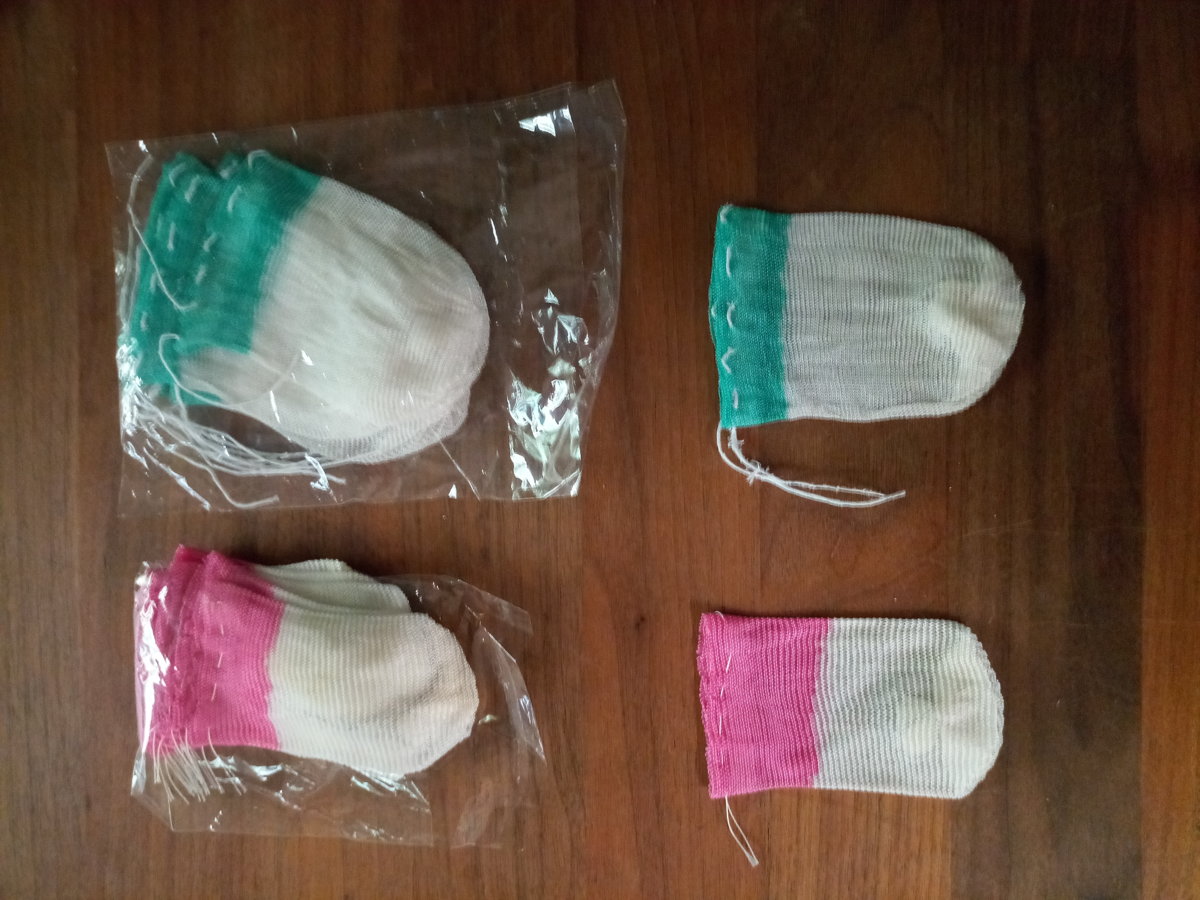

    hi everyone.
    A new style of 'Fabric lantern mantles' are now available on eBay. They're Chinese made and 'cheap as chips' as we say in the UK so of course I have ordered 20 to test. Here's what they look like...
    [​IMG]
    [​IMG]
    [​IMG]
    The ones I found were roughly £3.50 for 20 in postage. When they arrive I'll give them a go on a couple of different lanterns, both kero and WG and post the results.

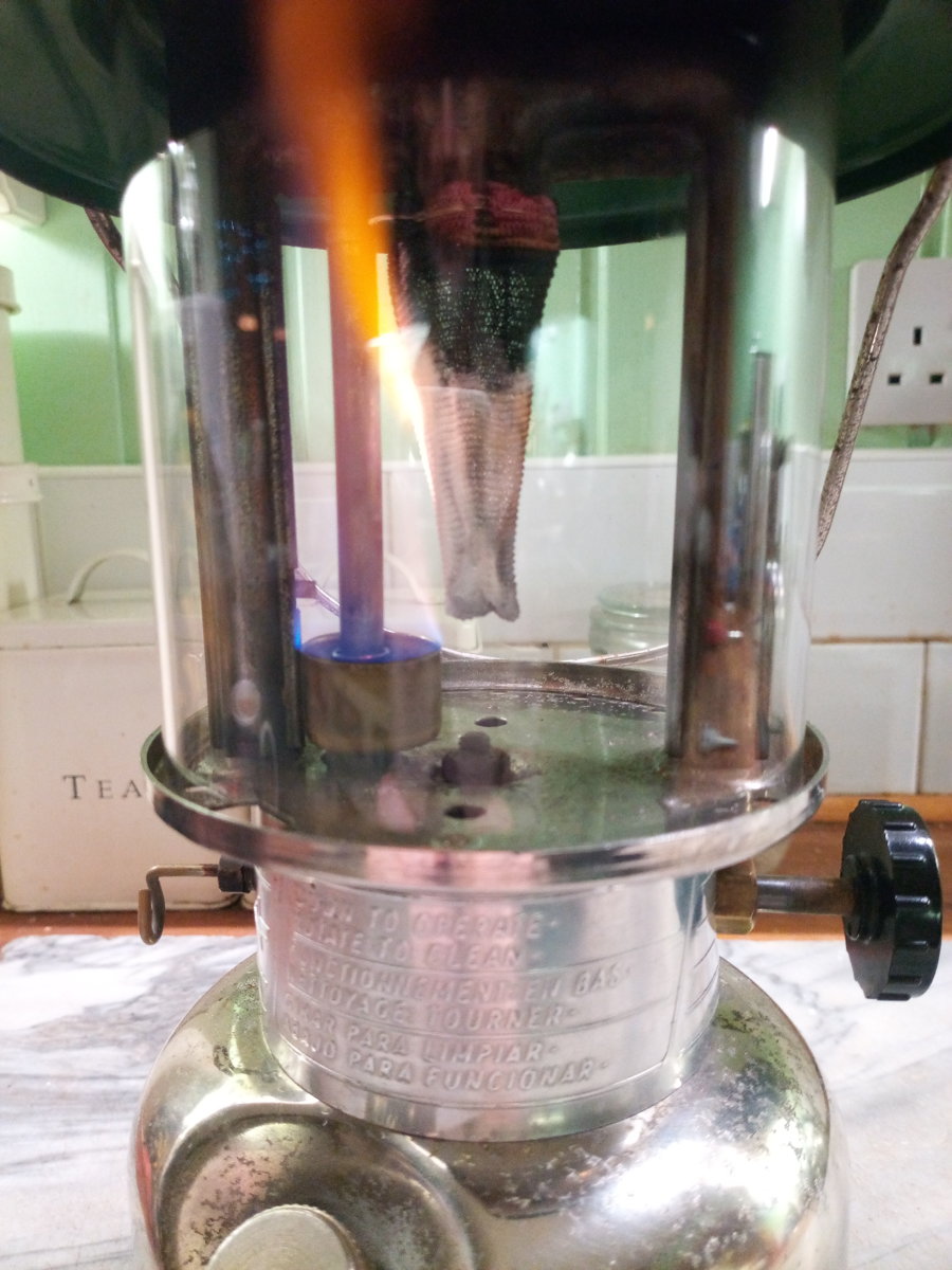

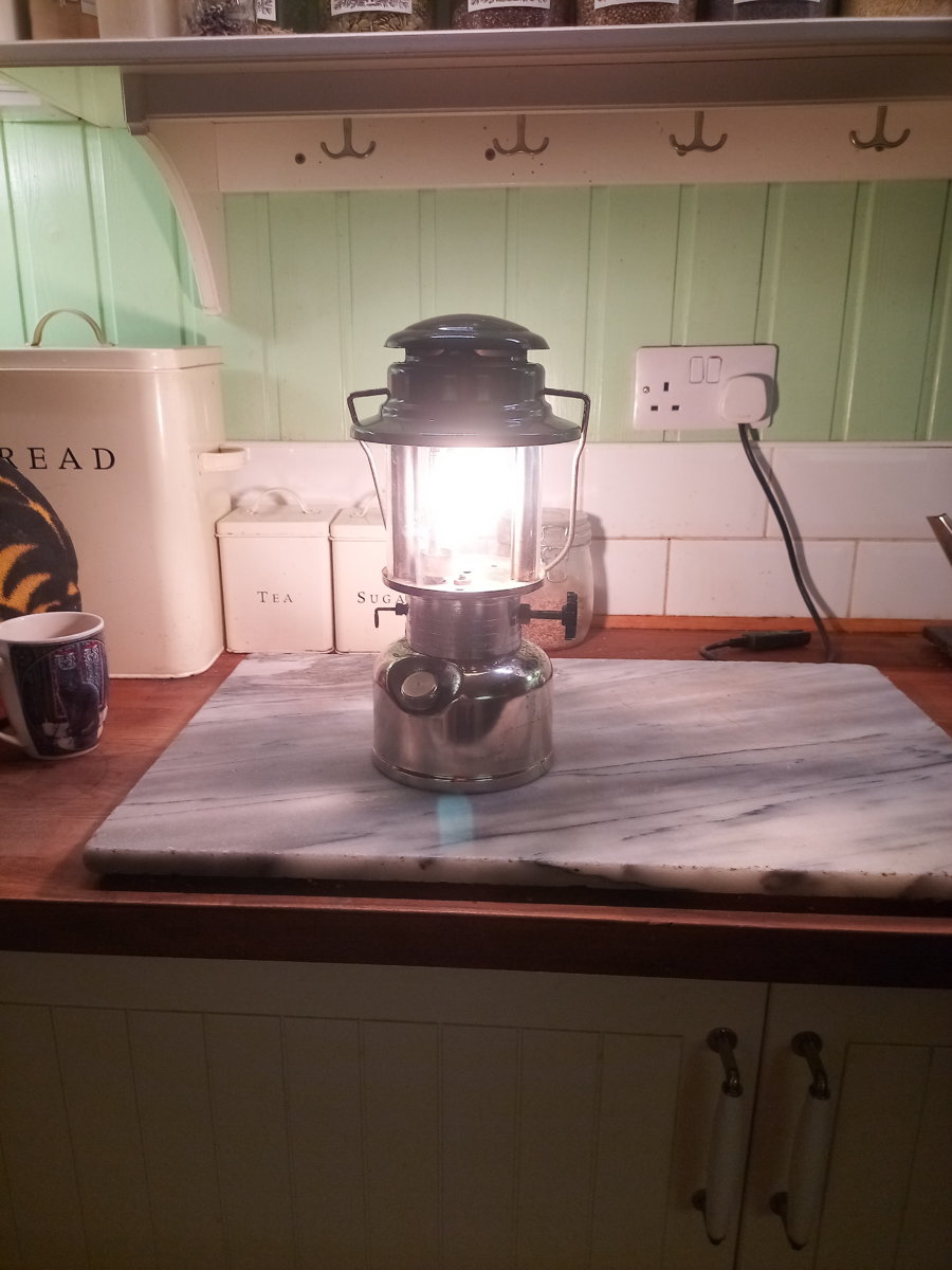

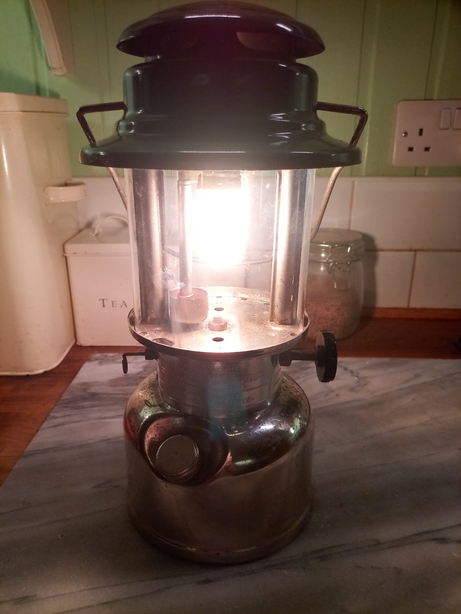

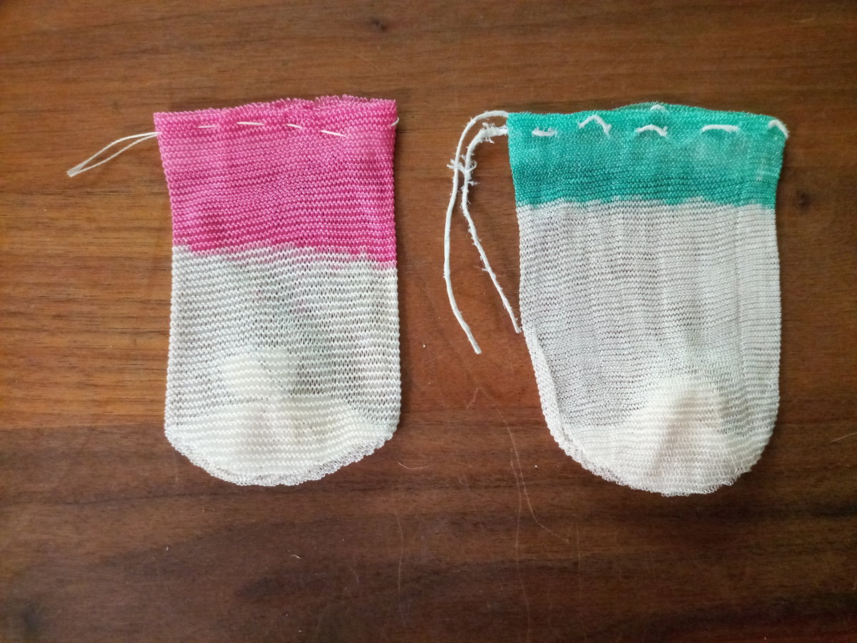

    *UPDATE*
    The new style Chinese mantles arrived today.
    These were the pink topped ones at the bottom. I have showed the previous green topped Chinese mantles for comparison.
    They are maybe 10% smaller, with a much thinner, stronger tie cord.
    I decided to fit the new mantle onto a 335 (339 conversion) that had been working very sucessfully with a green top.
    The thinner tie was harder to fix on but much stronger.
    I used the meths (denatured alcohol) to burn in the mantle and added 30 pumps to pressurise the fount.
    With roughly 1mm of meths left I opened the control valve to inflate the 'sock' and then slowly opened the valve. These are bright mantles!
    They are smaller than the green top variety but no less bright although I would say the illumination has a slightly more yellowish hue.
    One small hole is visible in the weave but it doesn't seem to affect the burn or the light output.
    After a short while I opened the valve all the way.
    As you can see, the new pink top mantles work well and would probably suit the smaller, one mantle lamps such as the Coleman 200, 249 or 282.
    Overall I'm very pleased with them.

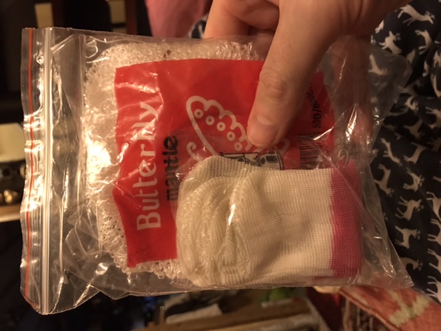

    0630A90F-1DFE-4D30-B3BB-8867BD11B37C.jpeg I spotted these too a while ago and they arrived today from China after about 3 weeks from ordering. It takes that long to get them. In the packet I also found some huge ones called ‘butterfly mantles’ - see photos. Look at the size of the buggers! Does anyone know what kind of lamp they’re meant to fit on? Street lamps perhaps! 1B2E34B0-51B6-412B-B0B1-CD3D74C82511.jpeg
  25. Hanzo
    Hanzo Subscriber
    Feb 2, 2016
    275
    Alex
    It should tell you on the package what size the mantle is. Looks like from the photo it says 500-600 cp? Then its for a Petromax type lantern.
  26. ColinG
    2,664
    Hi Alex, I have 'quite a few' (ahem - hundreds) of those Butterfly mantles and they work very well. They are rated 500/600cp but I keep them for use as double tie mantles on Bialaddin, Vapalux and Tilley as described in this post here. I created a diagram about how to tie double tie mantles here.
    The pink top 'fabric mantles' from China seem to be somewhat similar to the Coleman #21 and would probably work well on lanterns that take the smaller type of 'sock' design.
    Hope this helps.

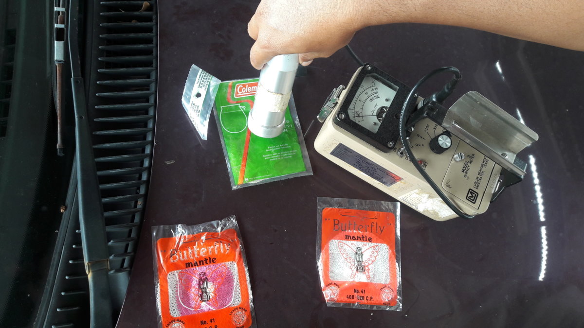

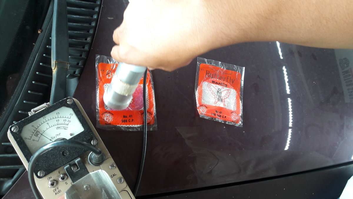

    Those mantles, much like a lot of mantles coming from China are very hot. They made my Geiger counter sing, much more so than Thoriated Peerless mantles did. Either the Thorium they are using is very old and a large amount of daughter isotopes are present or it is poorly refined and contaminated with other radioactive isotopes.
    I had a quantity of these, but they have been disposed of as even when in a metal container which was stored inside a cardboard box I was still getting a significant CPM rate from them at three feet.
    Use them at your own risk.
  29. MYN
    1,315
    Well I've tested some of the radioactive U-shaped green ones as well as the other more bulbous types. They're not exactly the same with each other. Here are some pictures of my actual tests a taken a couple of years back:-
    20180105_142316.jpg 20180105_142321.jpg 20180109_192122.jpg 20180109_192154.jpg 20180105_142331.jpg
