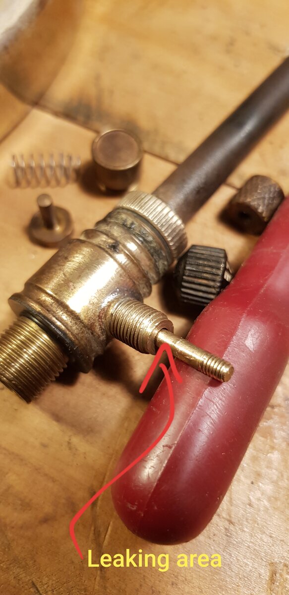

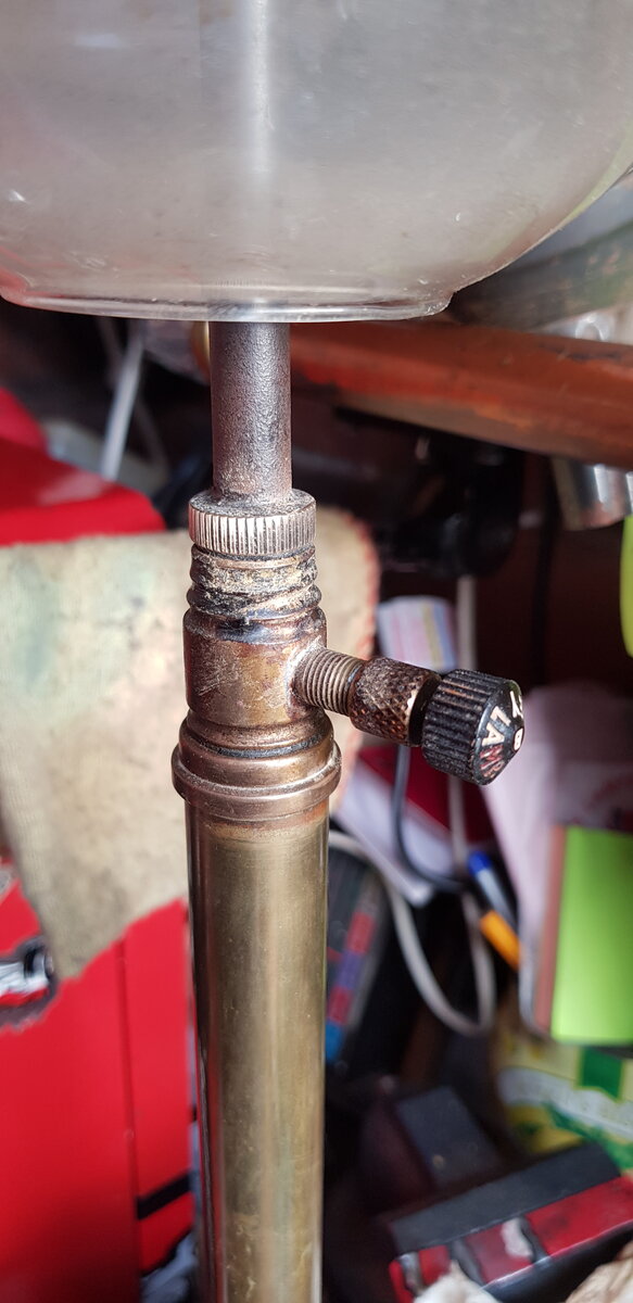

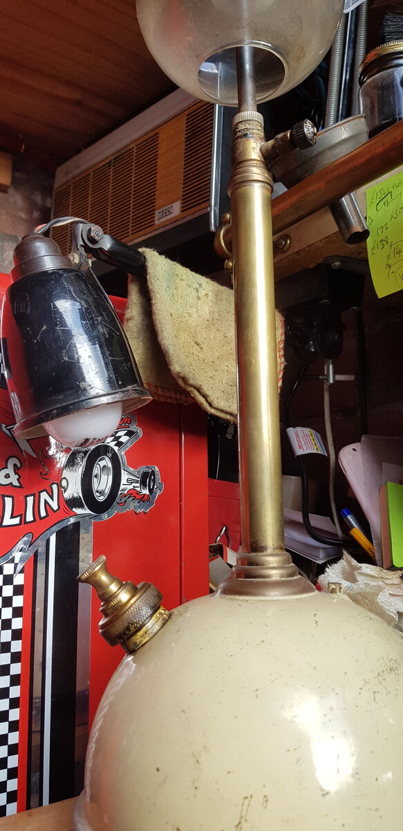

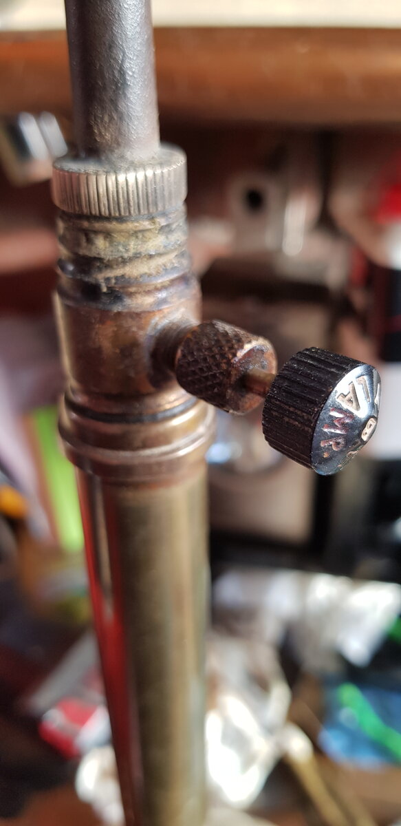

    Hi, I think I have a X246B lamp judging by the wire cage around the glass. The control cock is aluminium but the vids I've seen on youtube are for the earlier model.. How do i service this - well can i dismantle the control cock to replace washers and cup? Mine is leaking but the ali is welded to the body of the cock so i'm not sure if I get a spanner on it, it will just round off the 'nut' and I've broken it, can i actually get the knob shaft off the control valve at all. Is heating any good. Any help would be great!!! Thank you
  2. Mackburner
    6,211

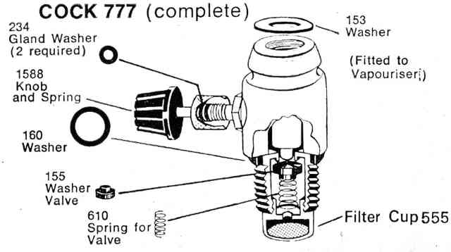

    That hex nut is indeed welded in so does not remove and you don't need to anyway to service this part. Just a new O ring seal for the gland is all you need to do. There is a spring loaded valve under the gauze filter and that filter cup unscrews if you want to fettle the valve. Mostly I wouldn't bother bcause that NRV is a redundant feature of a Tilley so if the fuel flow is OK you can leave that alone.
    These are aluminium cocks so you should not heat with a blow lamp. Ally has a lower melt point than brass and it's all too easy to damage the threads. Better to soak in an easing oil for a while to free things off. ::Neil::

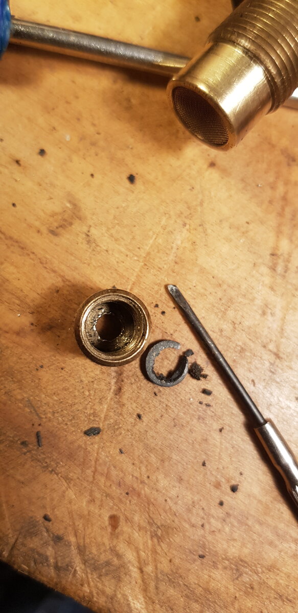

    You can get to the rubber seal for servicing this way.

    Have you checked the little aluminium cup to see if there is an old washer/seal still in place? Sometimes they hide in there, it's not always easy to spot them?
    Hopefully it was the gland seal leaking and not the welded alu nut?

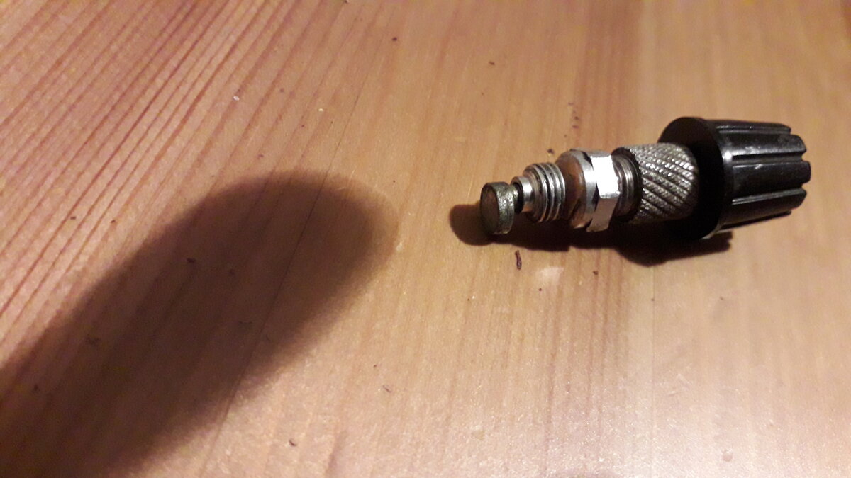

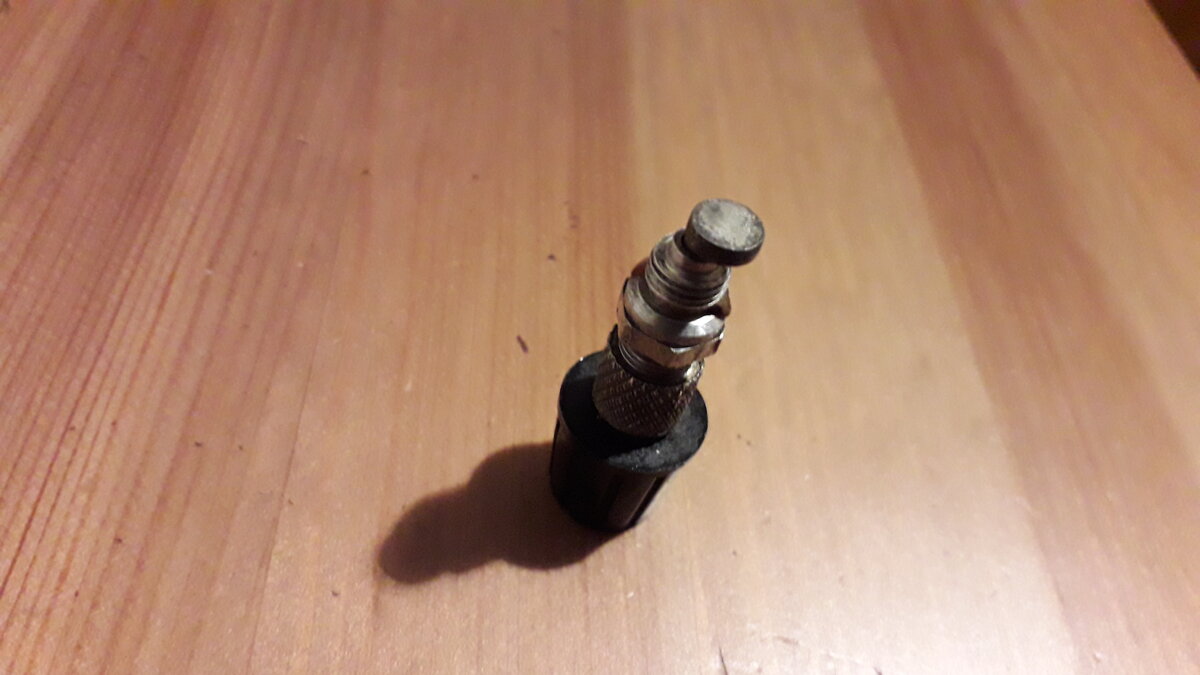

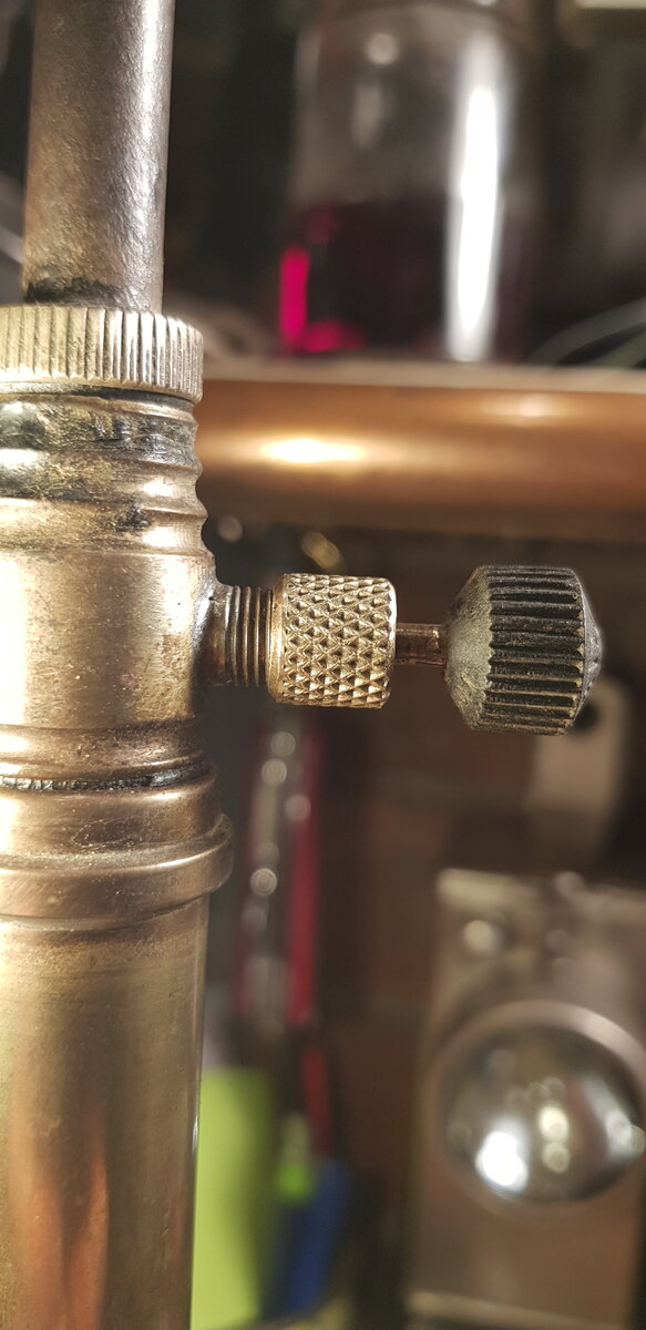

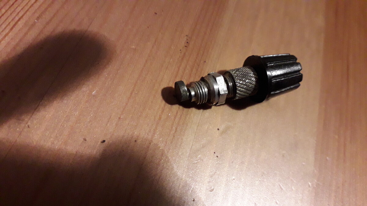

    The control black knob pulls off the shaft. There should not be a set screw holding it in it literally pushes back on.
    Grip the shaft with molegrips using cloth, leather, or whatever (i use a small strip of sandpaper) to stop it marking and give extra grip and wiggle the knob off , may need another pair of grips for this.
    The knurled round part unscrews as in the photo above, revealing an O ring type washer on the shaft, this is what will have been leaking, nothing more. Replace this and while you are at it do all the other seals in the lamp as its so worth it. Get a kit for late model tilleys from here on fettlebox.
    If the old seal in the knurled bit is stuck in there from age, heat the part very gently with the flame from a lighter, softening the old rubber, nothing more, and pick it out using a pin or similar, dental picks are excelent for this. It must all be out for the new one to work and must be clean in there, no residue.
    When re assembling you should not need to do anything up other than firm fingertight, especially the knurled bit on the turning shaft.
    Best!
