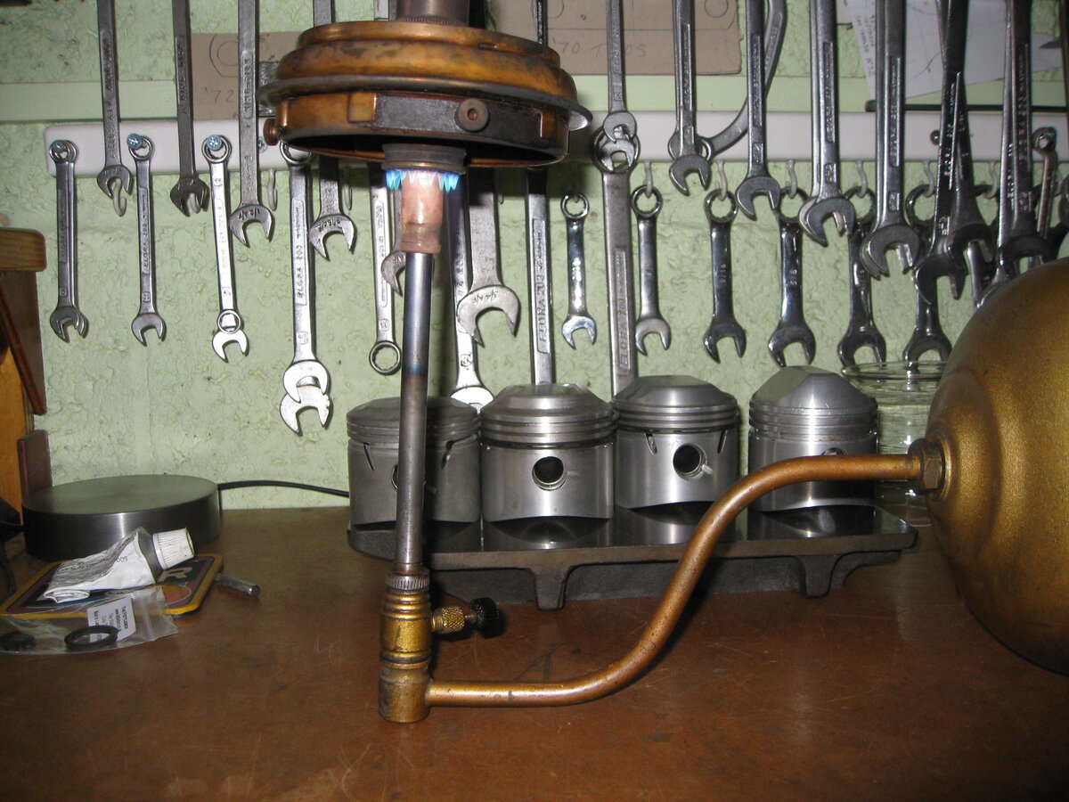

    Seal kit arrived this morning and fitted, Leak tests ~ none found.
    Started test burn outdoors, when it started to settle down, moved in to workshop.
    Initially quite considerable flame liftoff, stopped when I reduced the pressure, total flame envelope (not visible in photo) 3" length. There is a degree of pulsing (correct pressure will come with practice). Flame doesn't look as good as the one "signposted" above.
    Considering I picked up the majority of the lamp 42 years ago (just gone suitably red with embarrassment !) with the encouragement / guidance of you guys i'm remembering "the Hiss" of 50 years ago ~ within 8 days of finding this Forum.
    Thanks ~ again.

  30. ROBBO55
    2,278
    The flame looks good to me. Your making progress :thumbup:
