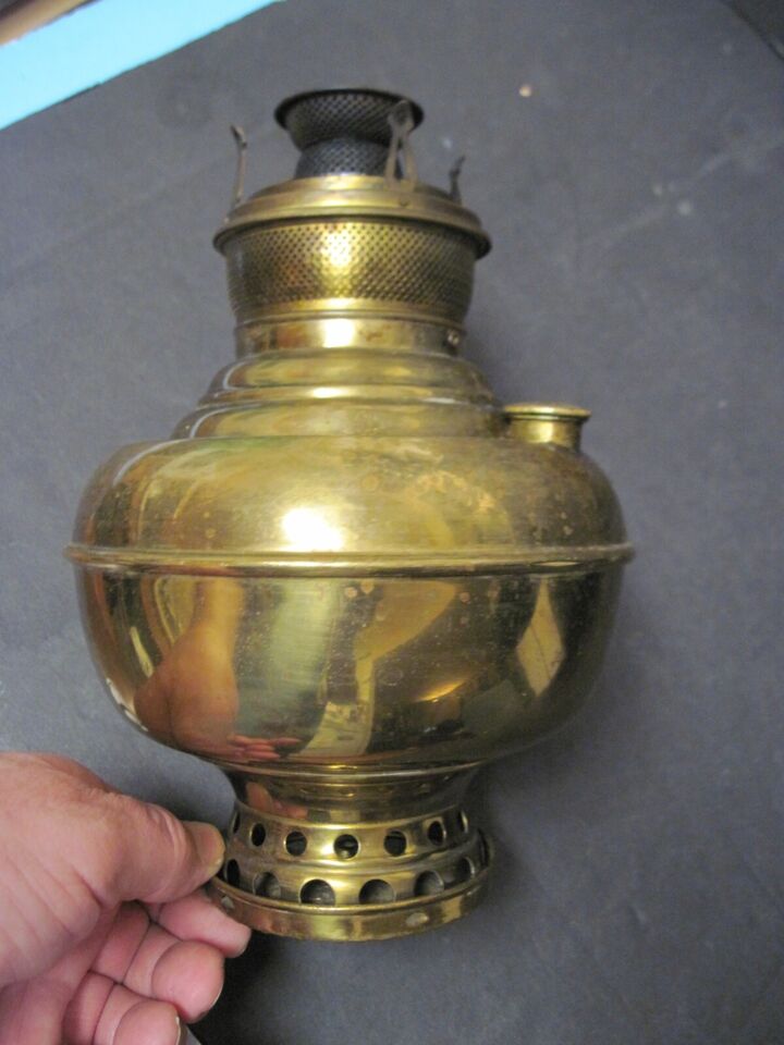

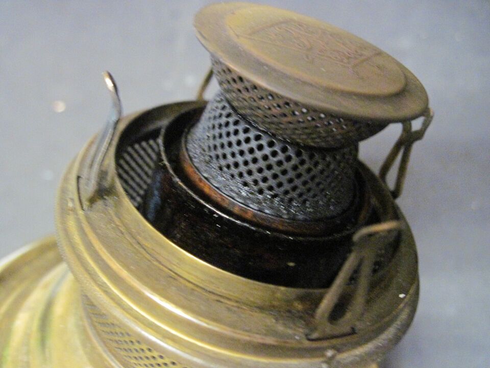

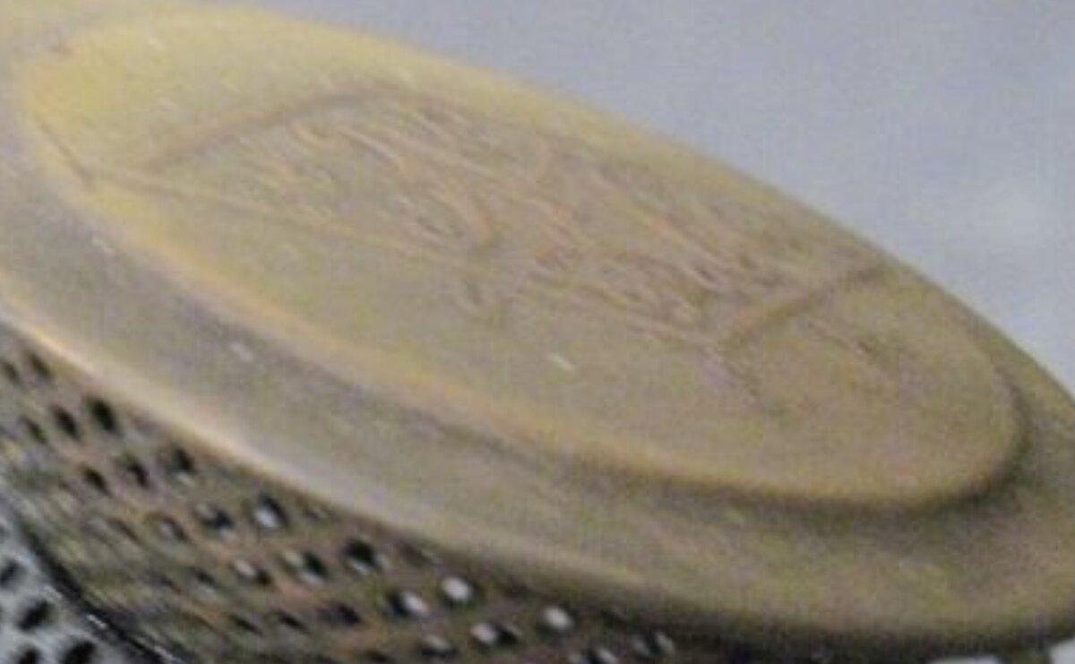

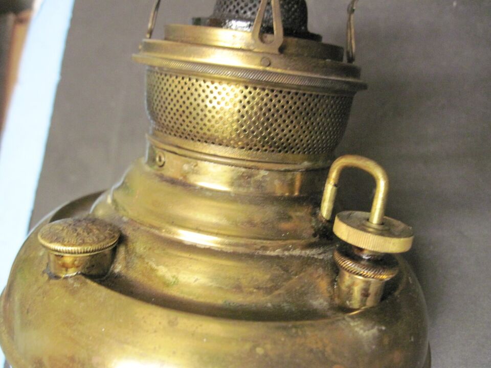

    Thank you all for your encouragement and advice - much appreciated! Here's another question: I'm considering buying the lamp shown in the attached 3 pictures. Am I right to assume this a pressurized kerosene lamp (versus an oil lamp). I don't see any wick, so I'm assuming it's a pressurized lamp, and a mantle would be installed over the perforated steel burner. It that right? Is this type of lamp worthy of repair?

    It looks like a kerosene lantern that uses a tubular wick.
  12. podbros
    3,425
    @Sooty Tilley
    @Fireexit1 is right.. I think it’s a Miller caboose lamp maybe for a harp type set up?
    maybe an ornate ‘M’ on the top of the burner?
    looks in good condition.. it may need a wick
