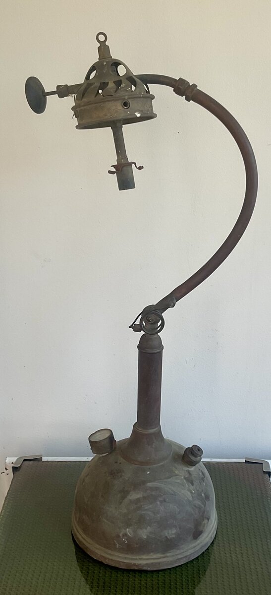

    I never thought I would find a Lilor and wonder how it came to be used in a blacksmith’s shop here in deepest Aberdeenshire. @Michel need not be jealous, this must be the plainest, crappiest Lilor lamp possible. I’ll clean it up a bit but am quite certain that anything else will be beyond me.

    A nice find which won't look too crappy when it's been cleaned and polished.

    Good find and it looks like all parts are there.

    Thanks, lads. Do you really think it’s all there @WimVe?
  7. Conny C
    Conny C Sweden Subscriber
    937
    Hi Jean,
    Welcome to the "Lilor Lamp" family. Good catch! Exterior wise it seems fairly complete,
    but it misses the outer cowl head with shade holder. Check the steel bottom plate, often
    pin holes and also problems with stuck controls. GOOD LUCK!

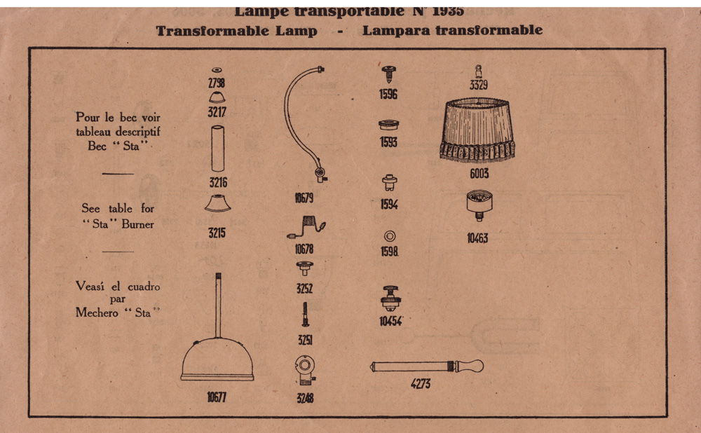

    ca. 1930 Lilor "Transformable" model nr. 1935 lamp
    /Conny

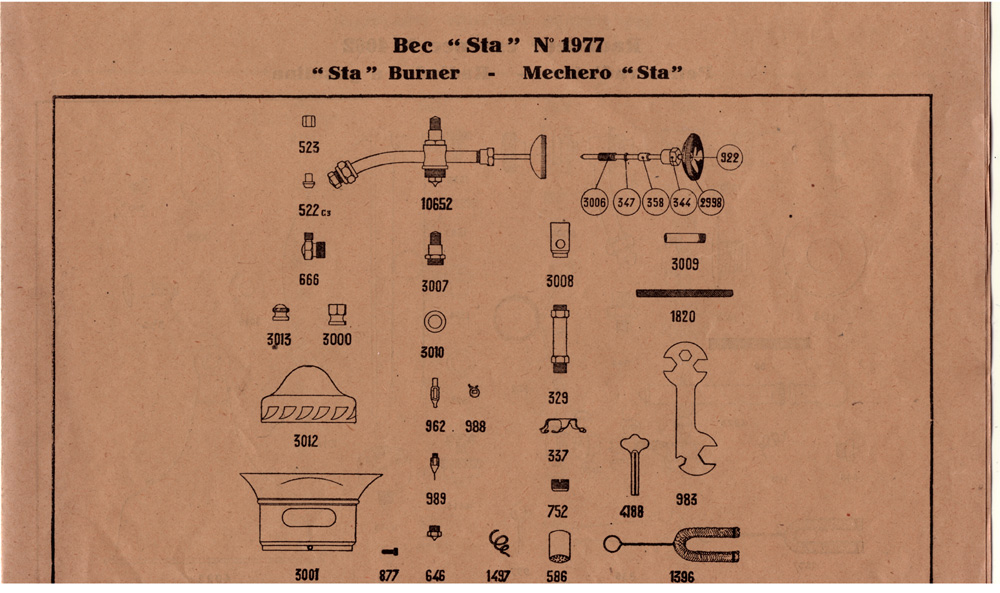

    This lamp seems complete or almost complete to me and it should work after a good cleaning and disassembly.
    The lower part of the burner, on which we attach the glass tulip or the globe, seems strange to me but we will see better with a few photos when everything is clean
    The STA burner is very stable
    Good catch :D/

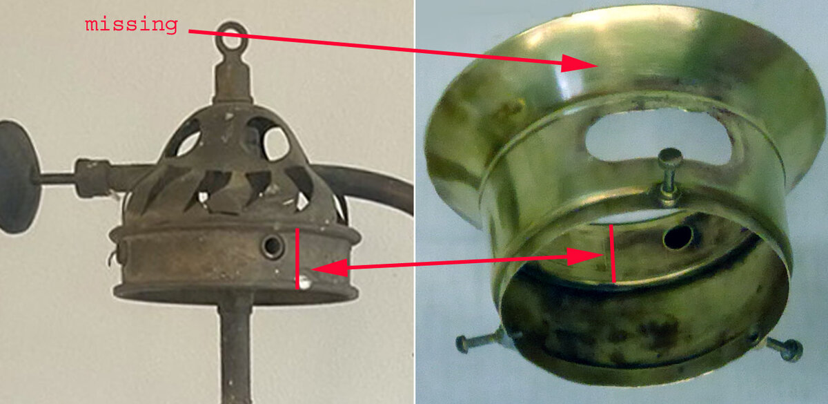

  9. Conny C
    937
    Jean, you can see what is missing here .... Maybe possible to reproduce. Pete?
    /Conny
