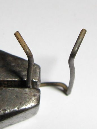

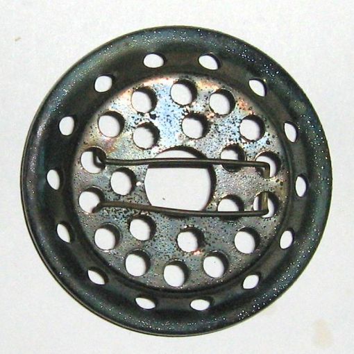

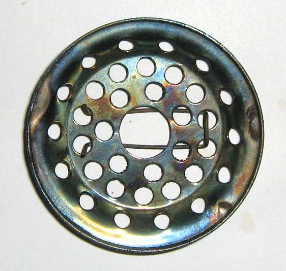

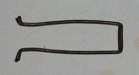

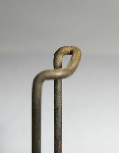

  21. Henry Plews
    879
    @MozzoSA
    The insect screen on your lantern is upside down and makes it difficult to get the pre-heater onto the vapouriser.
    The insect screen is held in place with a spring wire (1.04mm diam.).
    Henry.
  22. MozzoSA
    MozzoSA Australia Subscriber
    Oct 6, 2019
    45
    South Australia
    Ah thanks Henry. That explains things.
