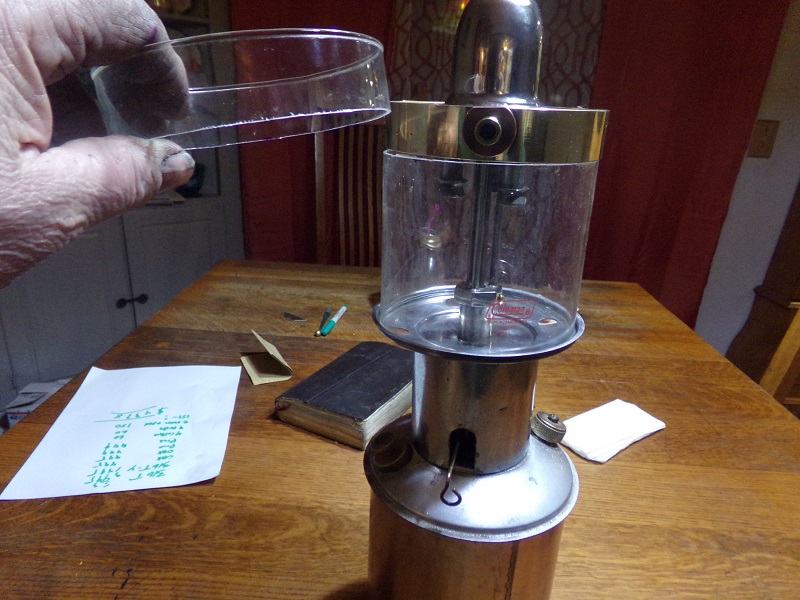

    an almost foolproof way to cut a glass globe with out breaking it! trim a globe.jpg

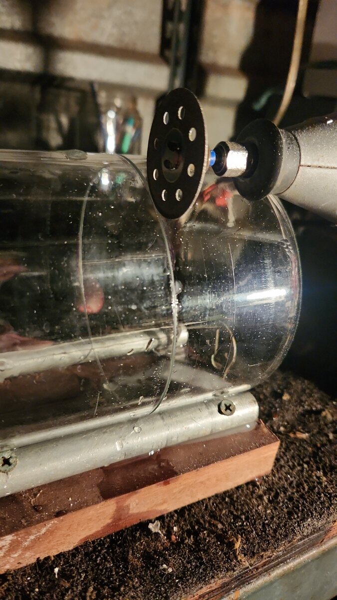

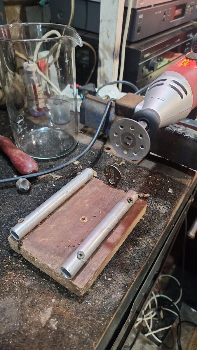

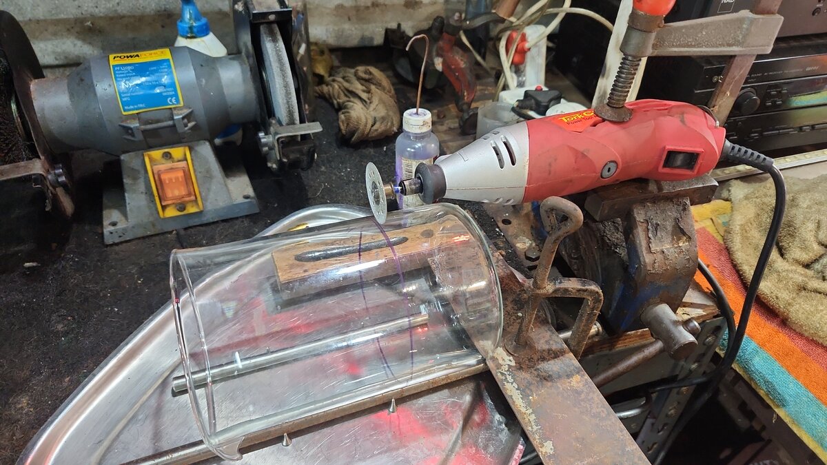

    I shall be sure to add to my homemade gig
    The gig then to go in the water bath
    Pretty rough
    Basic Plank plus 2 guide bars - and a key hole as a stopper
    Diamond cutting disc - fairly "loose' fitting in the vice
    This so left hand rotates the glass and right hand squeezing the water from a drip bottle as well as applying a little down pressure on the cut grove
    Angle of cutting wheel was good for splatter
    Will be sure to try next time with the whole lot in the bath

    @Warwick Beaumont ~~ thats a better set up than I had-- I like control of the cutting wheel-- I just hand held mine !

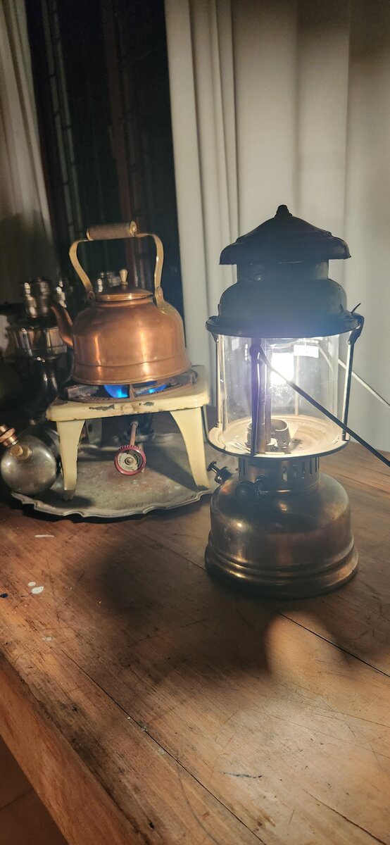

    Together we shall overcome :D/ 16787664564496390273660890138706.jpg
    Got loadsheding here in South Africa
    So great excuse to light up for a brew :lol:

    Here the glass I cut on a Radius 119
    Time for another cuppa
    So fired up the the Radius R10

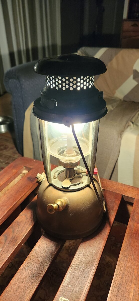

    Action pick is well a Primus 1020
    Also made up a glass for him

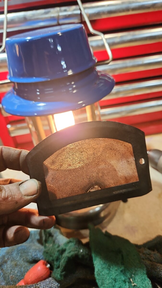

    Greetings All
    Today I was fixing a Beatrice stove
    Now we all know that mica screen is the first bit that gets poked out
    I managed to save one screen
    Looking about the shed to find something that would show some light
    Aha
    French press from the glass job
    The sieve makes a pretty decent screen for the stove
    :lol:
    It still needs a clean to get the fine grains out
    So 2 lamp glasses and 4 screens
    The centre has a pressed button that the plunger rod secures to
    Pretty easy to open
    Then just cut the metal sieve with a scissors
    Trim to fit the metal screen
    Drill 2 Locating holes and Bobs yr Auntie
