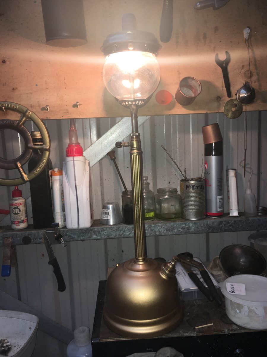

    5,265
    @Lampost1
    I just put a reproduction of a Tilley 182 onion globe on a TL10. :content:
    It worked fine.

    Hi Tony.
    That looks amazing. What is the ring part with the holes under the glass on the vaporiser? I don't have that. Is it essential?
  6. Tony Press
    5,265
    @Lampost1
    That is an insect screen. There is one at the top of the gallery as well. In Australia they are essential because suicide moths will ruin a mantle in a matter of minutes!
    On lanterns that I run often I replace the lower insect screen with a priming cup that is fitted so that the moths can't get in the bottom.
