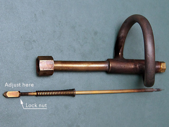

  13. Matti Kucer
    Matti Kucer Sweden Subscriber
    Mar 4, 2018
    31
    Thanks for your advise, found a pic from fettling section showing the spring opposite to how my spring was fitted, so that I must try.
    *edit: picture from this post.
    Yes, exactly my opinion. I will buy a clear one later on.
  14. Nils Stephenson
    2,107
    Yes, the spring should be as in the picture above. I hope that solves the sticking problem.

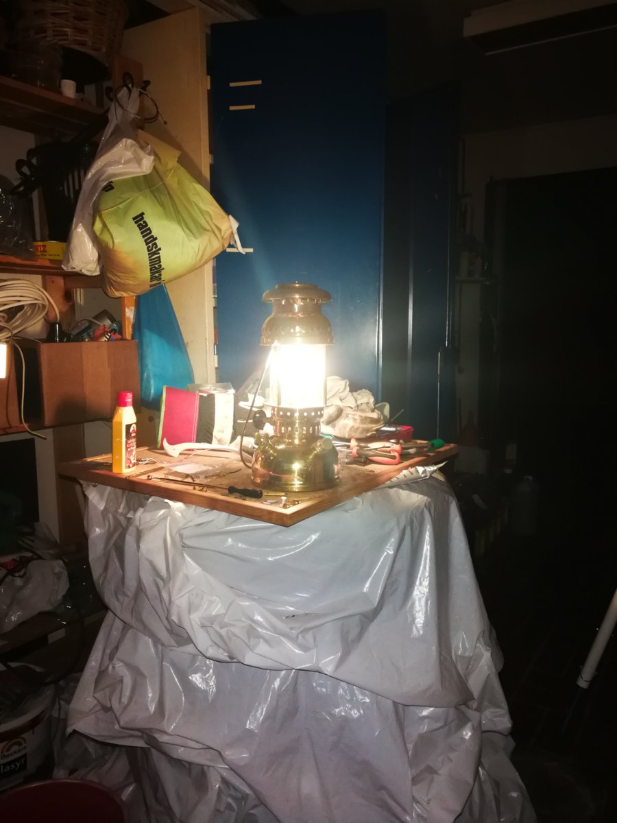

    Hi everybody!
    Summer vacation has started. To celebrate that, I have uploaded a pic of my first 1200. It works very good now, currently with Optimus 250CP mantles. I am a fan of the somewhat golden/warm light so I will try to find some other mantle brand.
