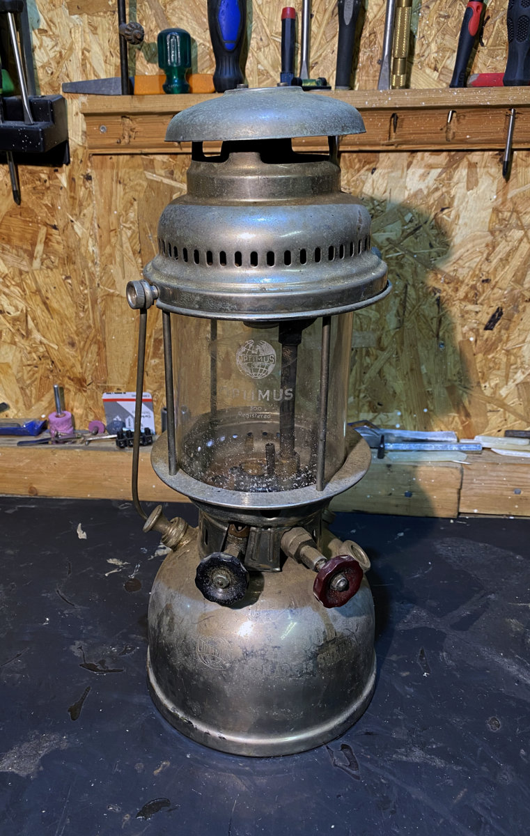

    Bought an early Optimus 1300 for ok money. It was really dirty on the outside but was surprised how nice it was on the inside. There was no coating at all.
