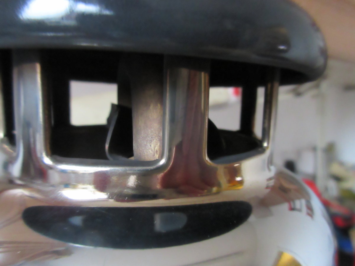

    Hello Gents. On my table now. The rivet is loose in fact, and I might stick a brass bolt through it one day. More frustratingly however, the tuning screw on the J-tube sits behind a support in the hood so you can't access it when it's fitted and running. I can get round it by fitting a hood off something else, but I'm not sure why they made a simple error like that. anyway it's a rather clean looking lamp so I'm more than chuffed. Had some security error problems uploading a picture, so apologies if I can't explain that better.

    Not quite sure what you are referring to...Not stuck, the cap wobbles on the hood as the stupid rivet has loosened off. My post above relates to the fact that the adjusting screw annoyingly lies behind a vertical support when the hood is placed down over the bail support blocks in its correct position.
  17. MYN
    3,161
    How many vent openings does the hood have? On the Petromax, its five. And if its fitted the other way round, that's what you get. If it has an even number of vent openings, it's unfortunate, but that's the way it is.
    Anyway, that doesn't matter too much as you'd only need to adjust that once.
