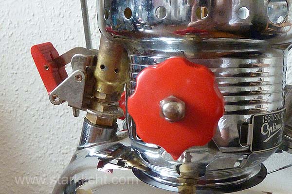

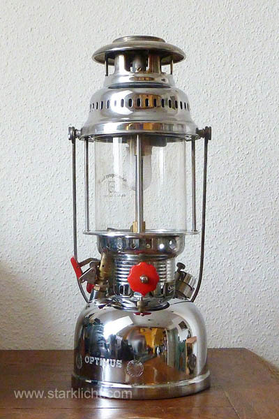

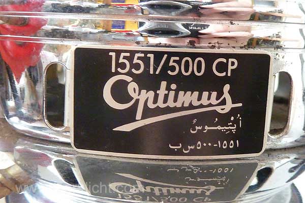

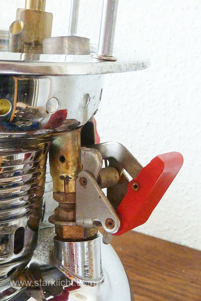

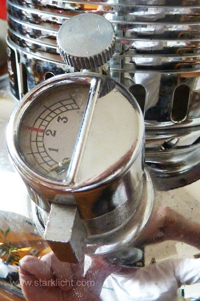

    Here is my nearly new Optimus 1551 with steel font, probably made in China.
    I expected the lamp beeing from lower quality, she seems to be not so bad, but not as good manufactured as the earlyer Optimus models.
    Does any one know from when on, the lamps were produced in China ?
    1338826177-P1160870_k.jpg 1338826194-P1160873_k.jpg 1338826207-P1160874_k.jpg 1338826223-P1160878_k.jpg 1338826239-P1160879_k.jpg

    I believe these started in the early 90s. It is not mentioned in a 1989 catalogue I have.
    I have one of these in fairly rusty condition that I lit for the first time earlier this year. After the usual change of seals and general once over, it worked like a charm. I usued alcohol to light it though so can't comment on the quick lighter. It certainly deserves the 500cp tag. Much brighter than other 300cp lanterns. Whether it's a 'real' 500cp or not is unknown.

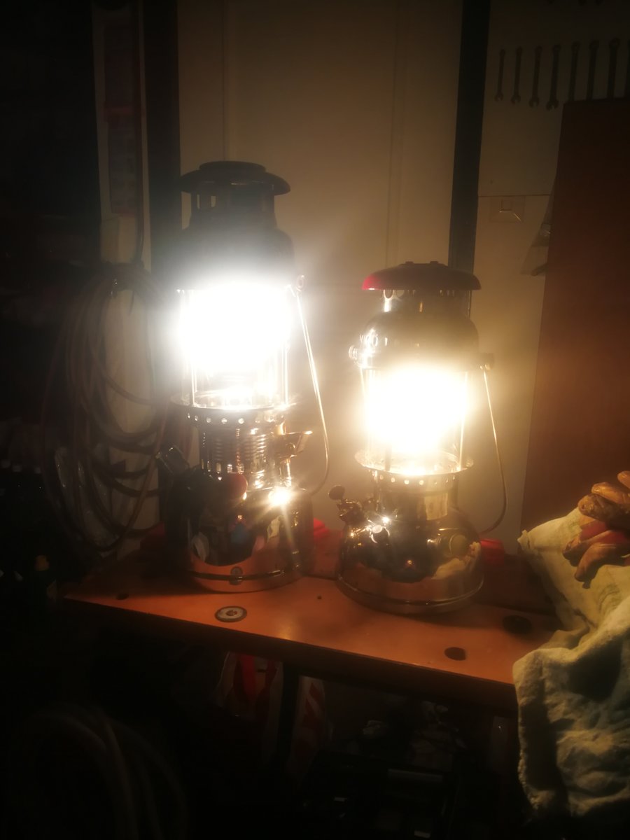

    Here is a picture with the 1551 to the left and a 200 to the right. Notice the difference in brightness.
  7. MYN
    911
    Sure made to look like an Anchor. Anyway, Anchor lanterns are decently well made and usually work well.
    @Matti Kucer ,
    You should be able to reduce some light output by replacing the jet, mantle and pricker needle.with smaller ones. Maybe some air gap adjustments to suit.
