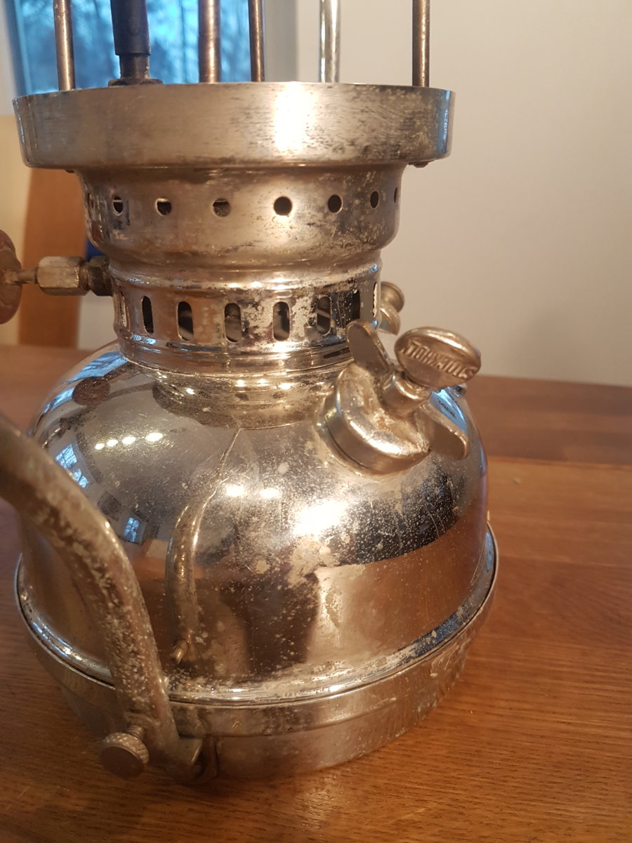

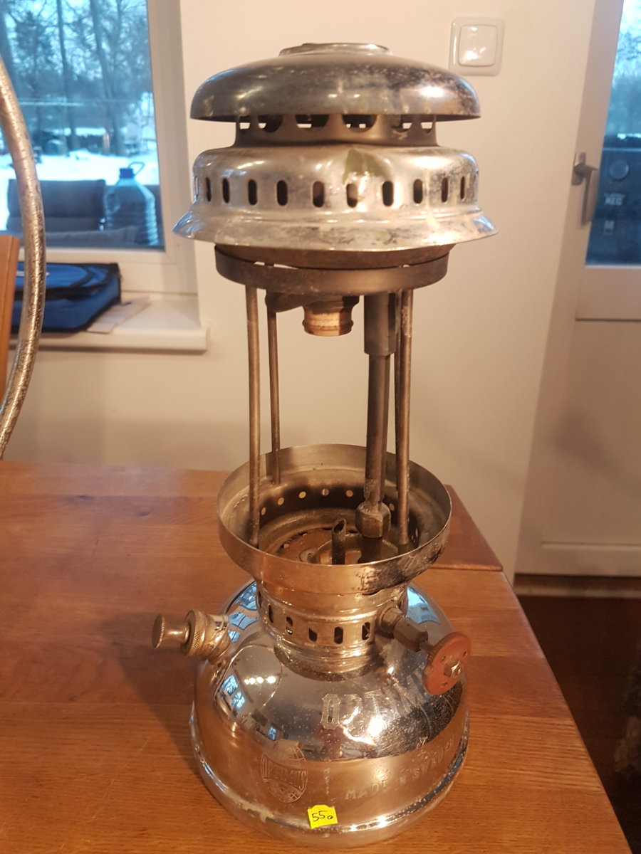

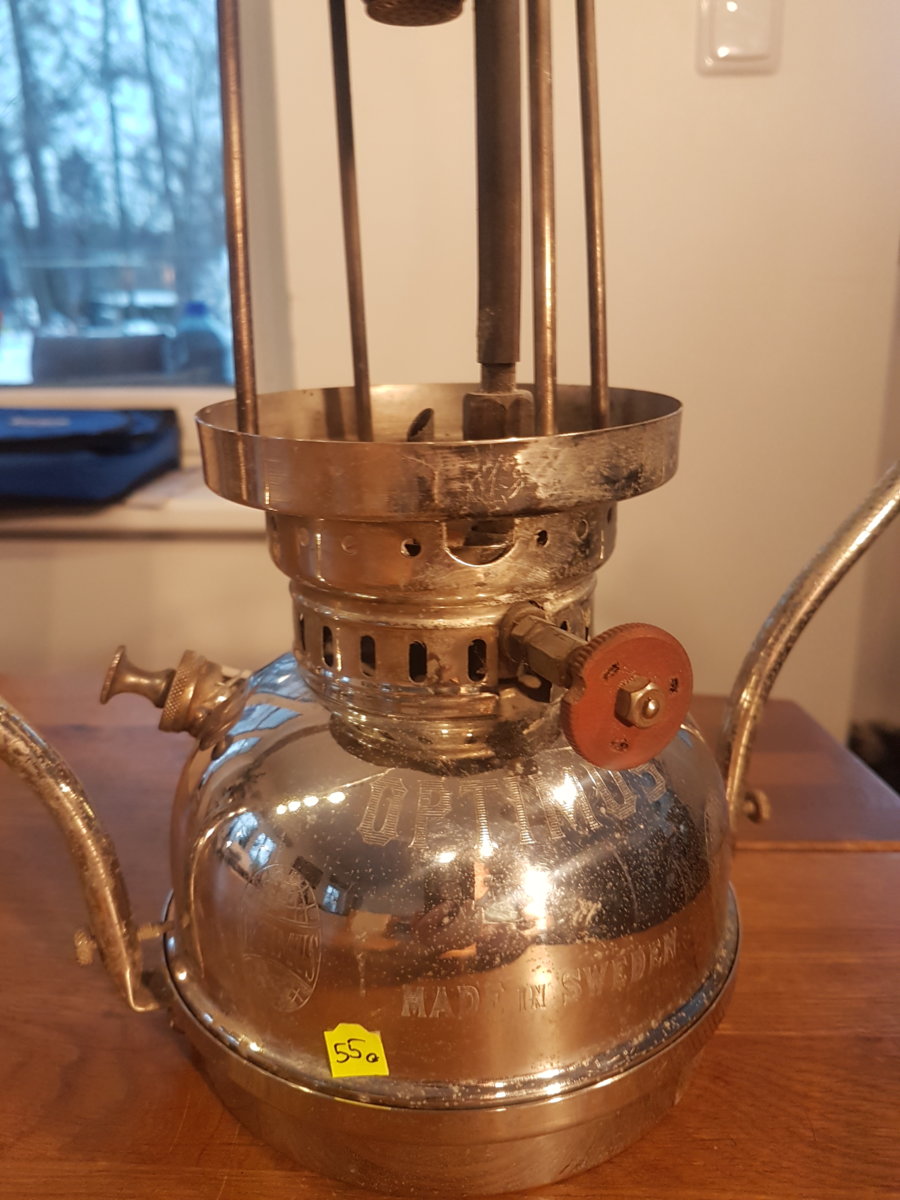

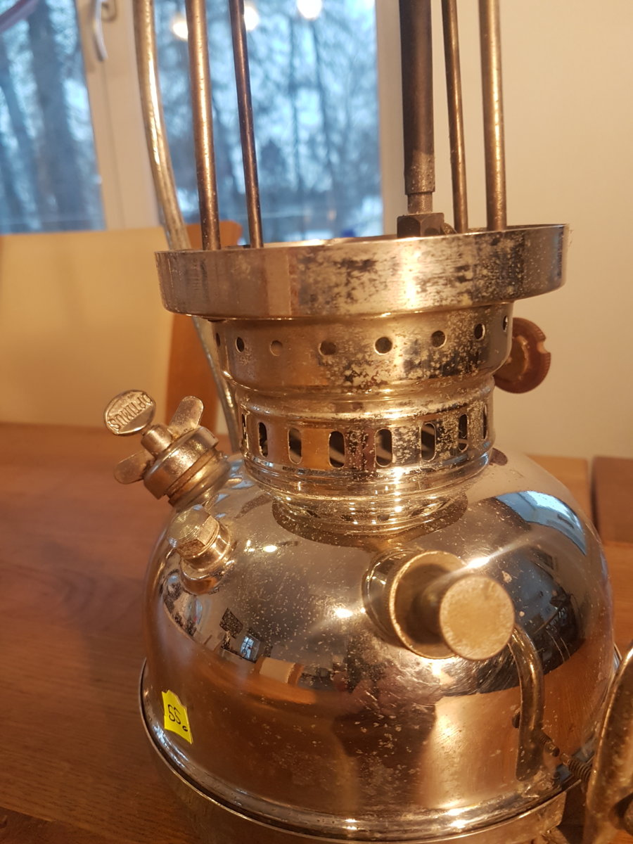

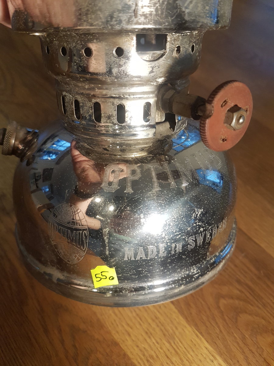

    Found this old 253 this afternoon.
    Bit batteted on top and missing the glass but I am guessing it is an early model based on the filler cap and pricker handle.
    The frame itself is also very plain

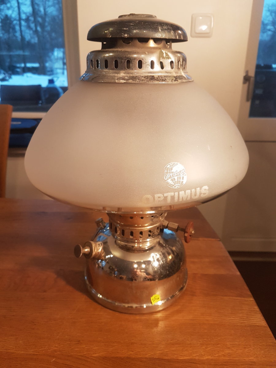

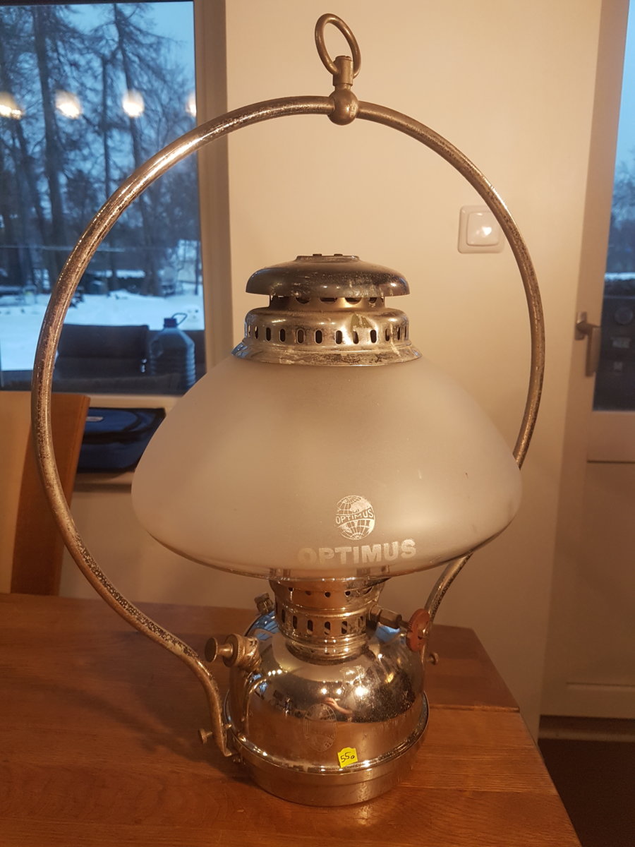

    With a 252A glass fitted just for fun

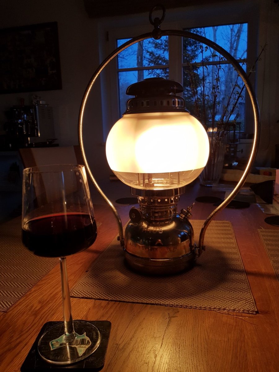

    Finally got her going nicely. Got a bit of black mantle but worked out it was a leaky seal on the fount. I assumed it was a too rich mixture but turned out to be opposite.
    Globe is of course non-original. Did a deal with a great guy in Korea (lovelantern2014). I swapped a lantern without a globe for it. Thought it was a great deal and so did he. Both winners in the end.
    Anyway here are some action shots. It has a mantle from hytta.de which gives a pleasant golden light. Original Optimus are much whiter as you will see later.
    We had it on the table for dinner. Romantic light and not too noisy.
    Hoop is ok to handle outside at 8 degrees but quickly becomes too hot to touch inside.
    It's a beautiful lamp and we are really happy with it. 50 euro well spent.

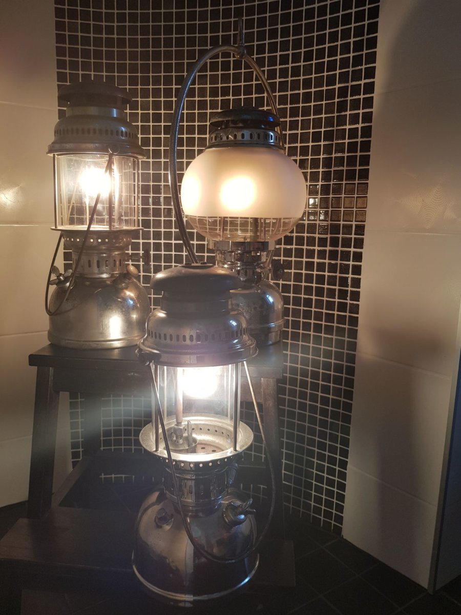

    With some friends.
    Optimus 300 lamps with optimus and petrolys mantles. White vs golden light.
    A bit difficult to see in the photos but very obvious when they are side by side.
    Picked up a 3rd 300 this morning, soon will have a really nice display

    Hello! Where did you find the glass for the Optimus 253?
    Thomas Lindblad, Stockholm
  13. MarkC
    MarkC Subscriber
    Feb 17, 2018
    278
    Tallinn, Estonia
    It is a repro globe from South Korea. I swapped it for another lamp.
