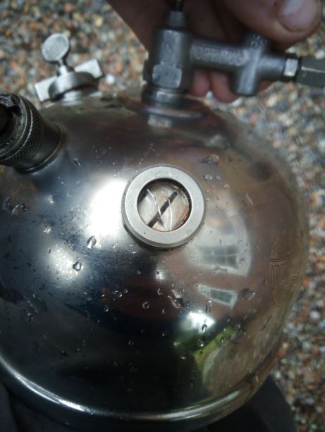

    Do you esteemed Gentlemen have any suggestions on a replacement glass for a Optimus 300 Fuel Gauge glass? The lantern won't hold pressure, it escapes via the cracked glass.

    I found some flat watch glasses on the Bay of Evil for a similar job. Curved glasses are also available.

    I recall someone was cutting replacements our of clear CD case covers.

    Is it the case then that a pressure seal depends on an intact glass sealed to the gauge casing? Sealed to the casing with what? I’ve only experience of pressure gauges on stoves and lanterns and a fuel level gauge on a Tilley FL6, where the ‘sender’ unit in the tank transmits movement to the gauge needle by magnetism.

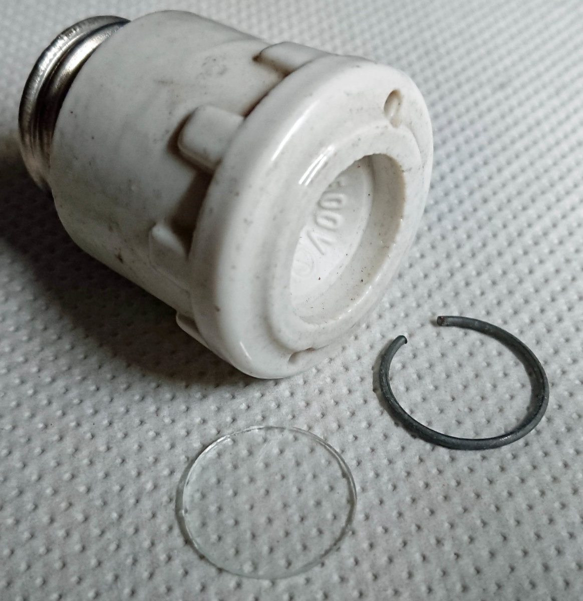

    I have used glasses from the ceramic holders of old fuses, as seen in this post on the same topic.
    I doubt that you had the same standard in the UK as we did with these, so probably you don't had this kind or size of the part.
    Just mention it in case you have a similar type.

    Link to post where this topic was covered answers my question, thanks. So the glass has to be provided with seals, unlike on pressure gauges.

    Gentlemen, thank you for your responses. Very helpful as ever. @Norman thanks for the link, I'd have struggled to find that. Ordered one last night. We will see how we get on.

    This's a great idea. Didn't cross my mind since I wasn't looking for a glass.
    In general, we don't use those here in the public (British Standard by tradition, adapted to local standards). However, they're commonly used in my workplace(plant), which is mostly German machineries and construction according to other European standards(DIN VDE, EN, etc).:). Great tip off.
