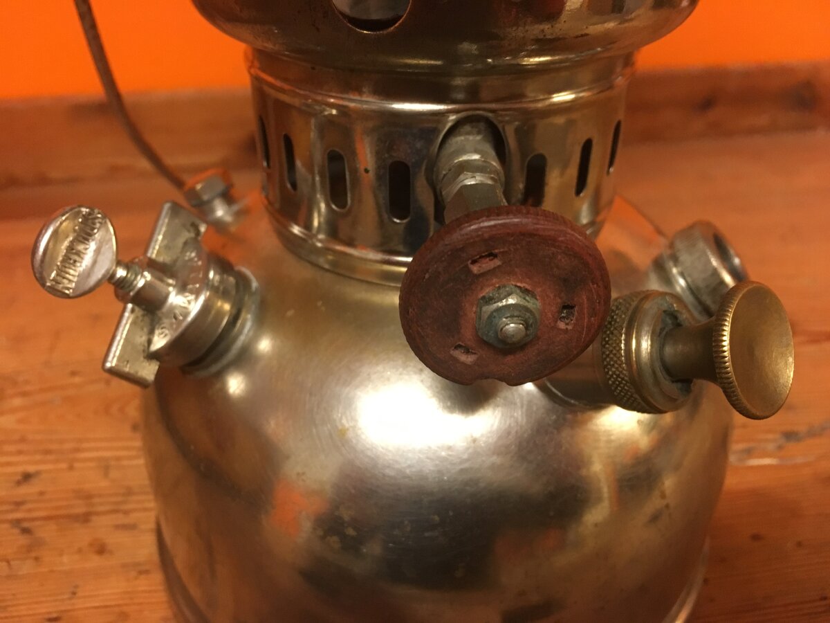

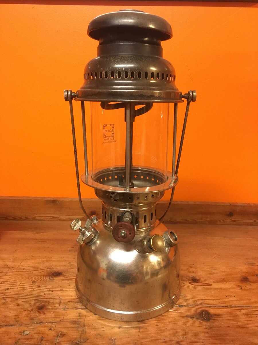

    I've just got (for free almost) Optimus 300 lamp, simillar to the one Nils has here: 1931 Optimus 300

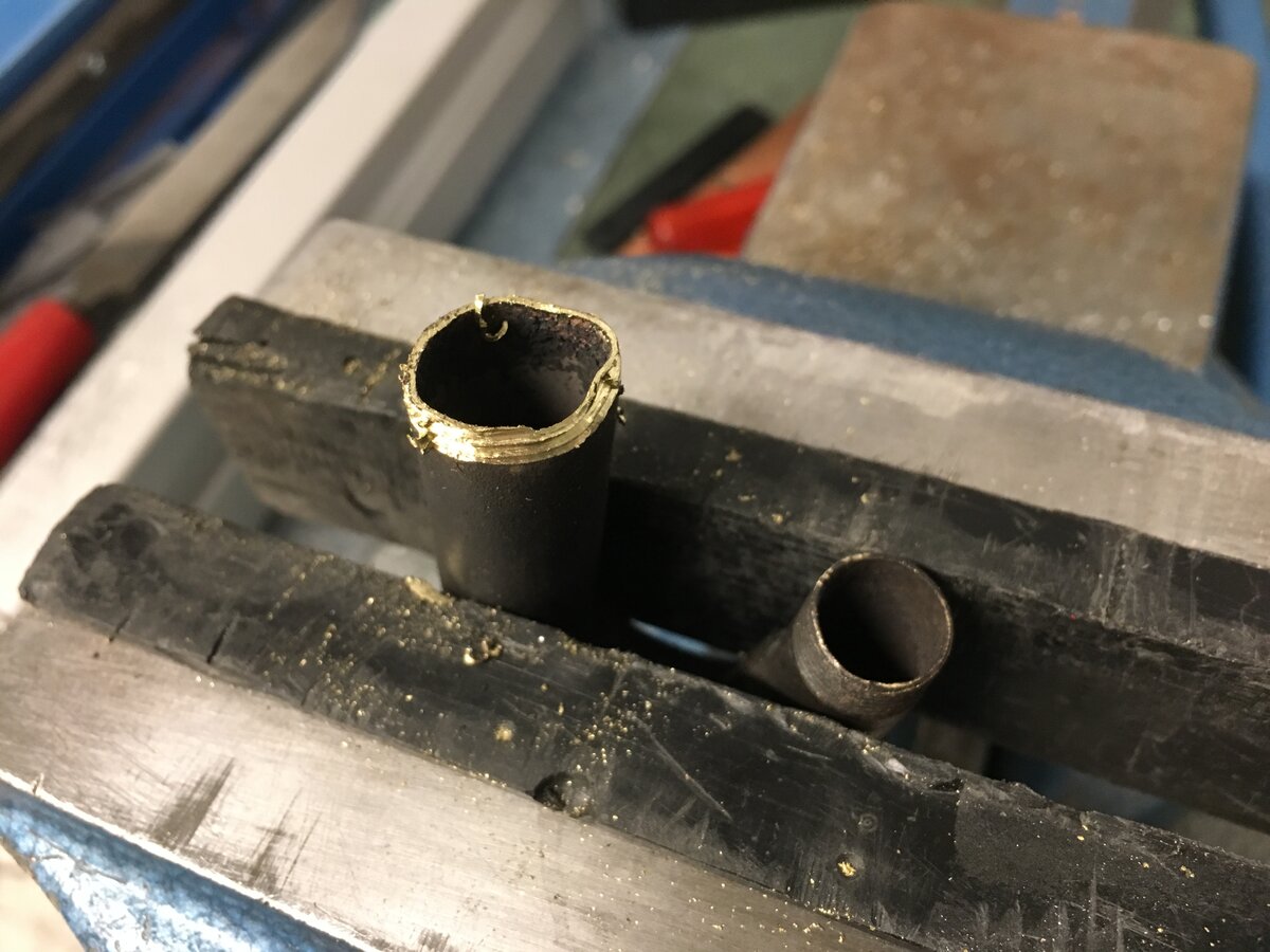

    I tried disassembling it before lightning. Unfortunately J-tube broke while trying to unscrew holding nut and mantle holder.
    I've managed to free these parts (holder and nut) from tube rests but now the tube is shorter by a good 12mm.
    I'm considering turning a brass extension/adapter to fill this miss but I'd rather replace the J-tube instead.
    Do you happen to know if any other lamp uses same size tube? I recall someone mentioned that it's a copy of Petromax (?) lamp but which model?
    Tried finding replacement in Fogas but they don't seem to have it.
    In the worst case the lamp will serve as a donor for the other 300 but it would feel good to resurect her.

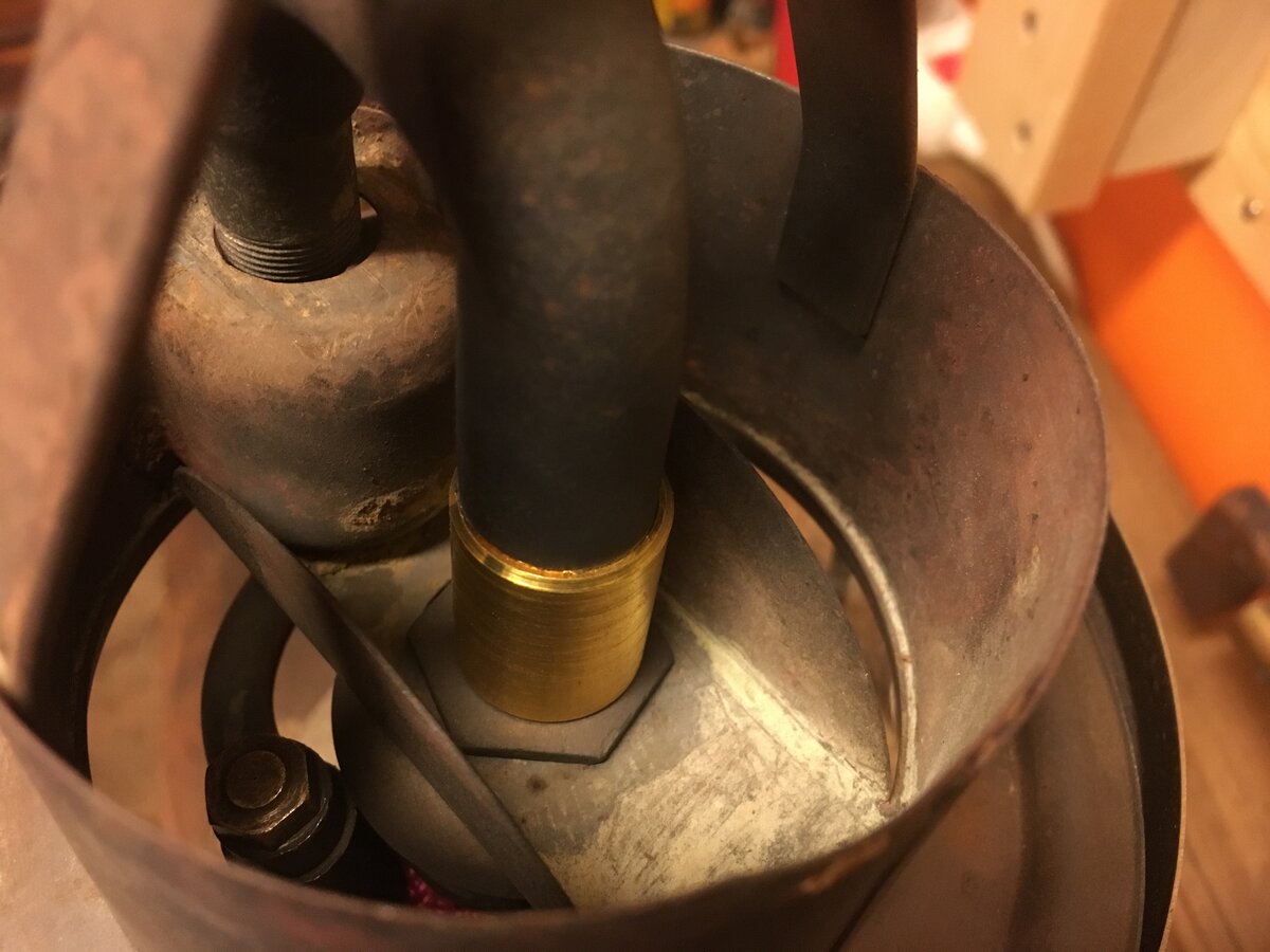

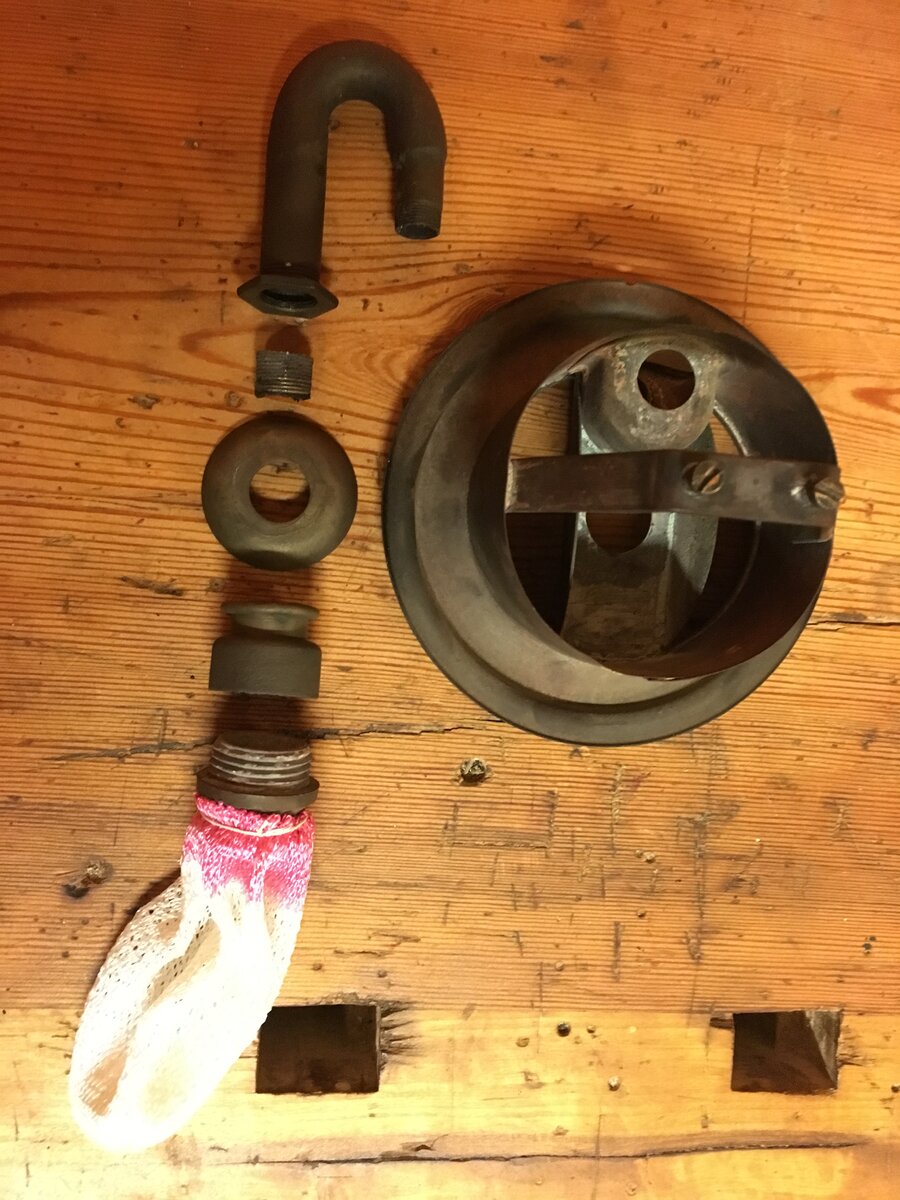

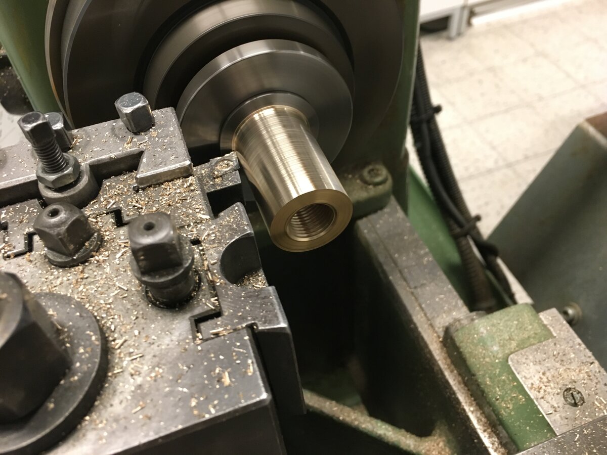

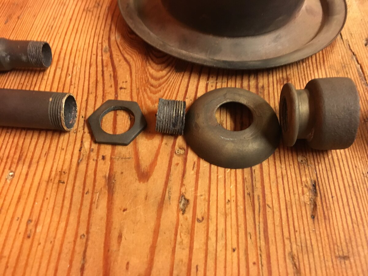

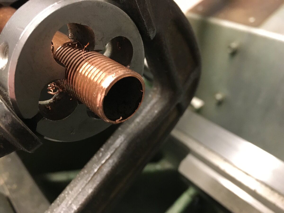

    It turned out to be quite an easy fix.
    I considered 2 options: brazing copper/brass extension pipe or making screwed-in adapter.
    I went for the adapter since the original J-tube is thin walled and quite weak. I was afraid that brazing could puncture it. Besides - adapter gave me an option to fine-tune the air gap since my Optimus 300 does not have any options to regulate that.

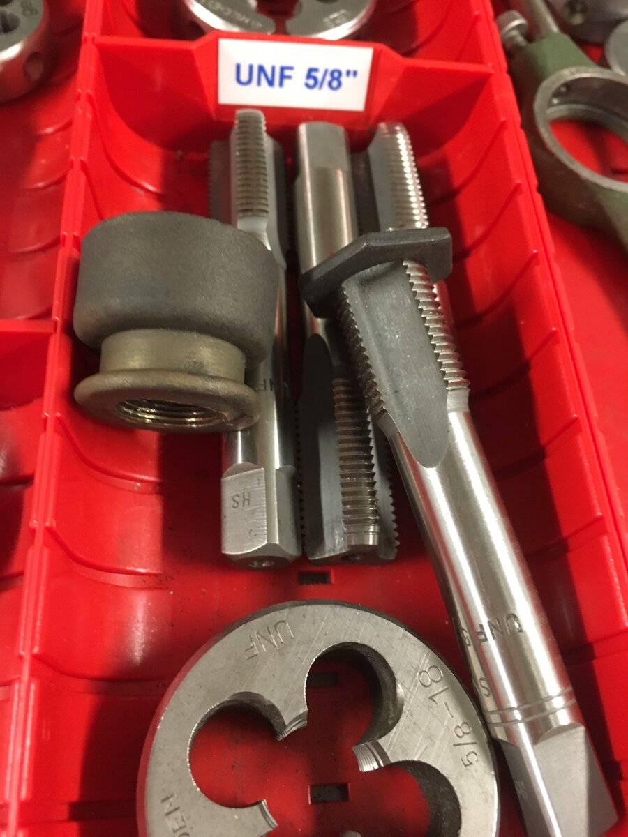

    I found copper pipe of adequate internal diameter. It turns out to be a standard dimension used in Sweden for most water/gas installations. I found mine in a pile of junk in my factory.
    Threading on the original J-tube was a bit of a mystery. Closest threads matching are M15x1 and UNF 5/8"
    Since the lamp was made in Sweden long time ago (when?) they definitely used imperial threads so I went for UNF 5/8".
    The original thread is so thin - and J-tube so thin-walled - that it was collapsing while I attempted re-threading it.
    After straightening the J-tube back to circular shape I've turned temporary reinforcement to add stiffness to the pipe.
    Threading went well then.
    The adapter is made from brass, it's simply an oversized nut.

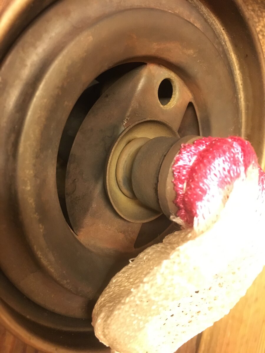

    After trimming length of both new components I could assemble the lamp.
    The adapter is hidden inside the hood, not visible if you don't disassemble the lamp.
    Internal diameters matching nicely.

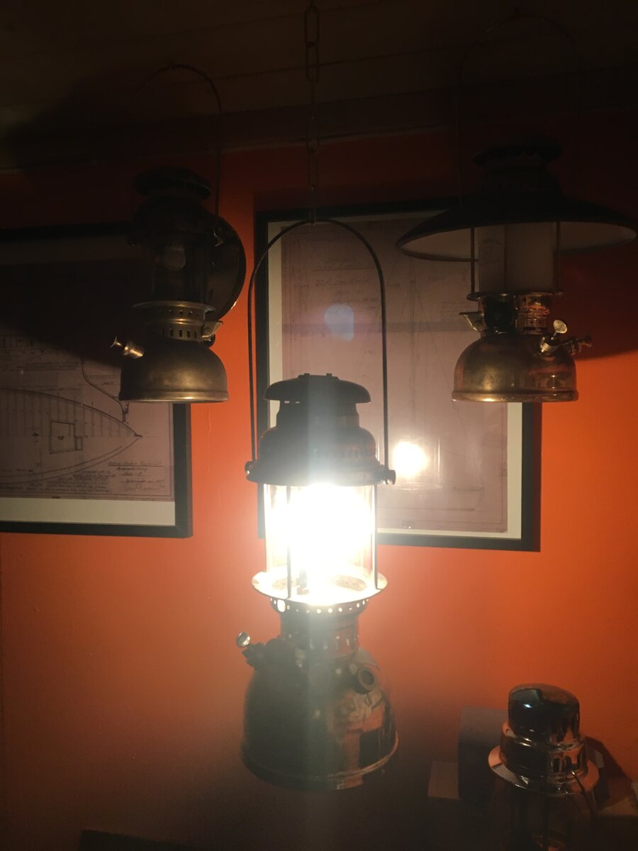

    Tried first time without the globe nor mantle - looked good enough for me to try with the mantle.
    And so she woke up!
    Compared to my other Optimus lamps this one is very silent - and probably the oldest of them all.
    After 1h of operation still all was good so now it's time to clean her and give her "living-room look"

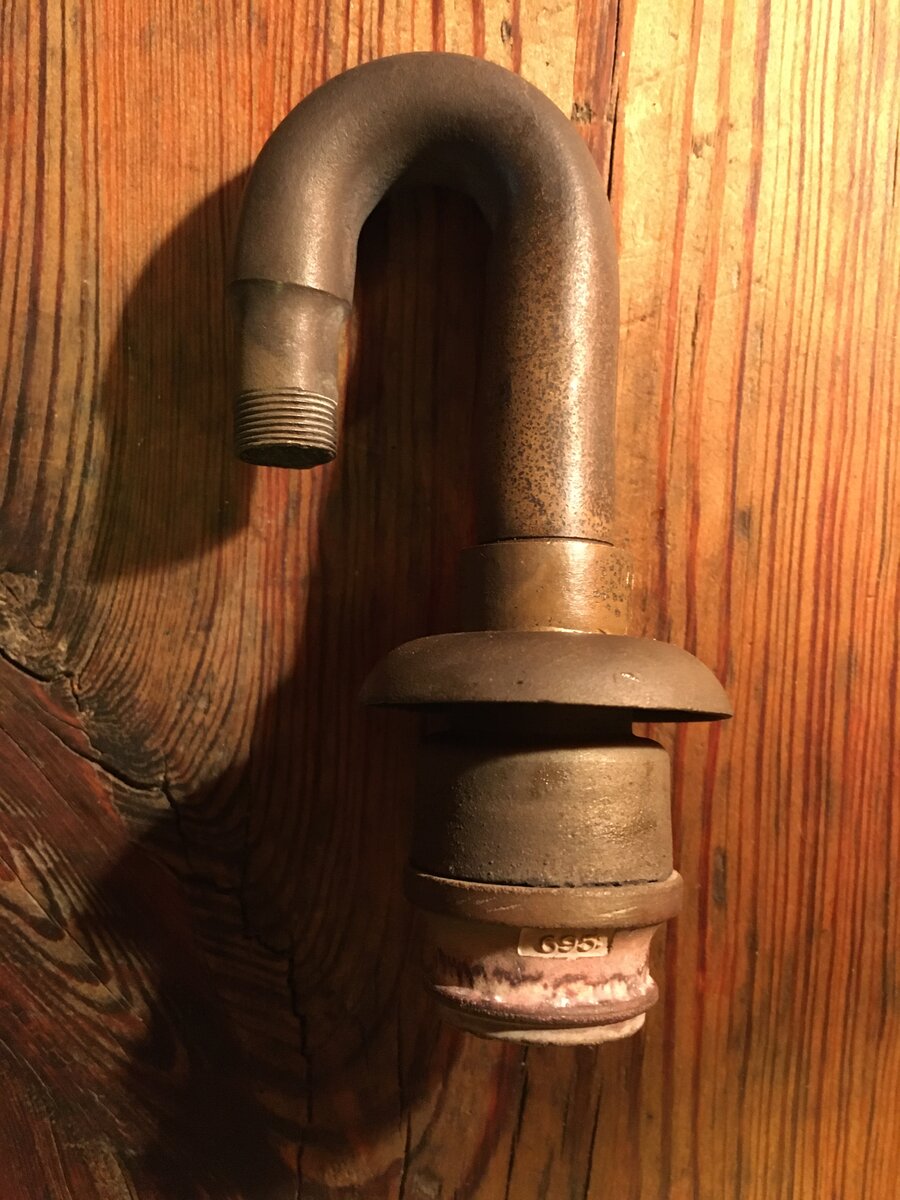

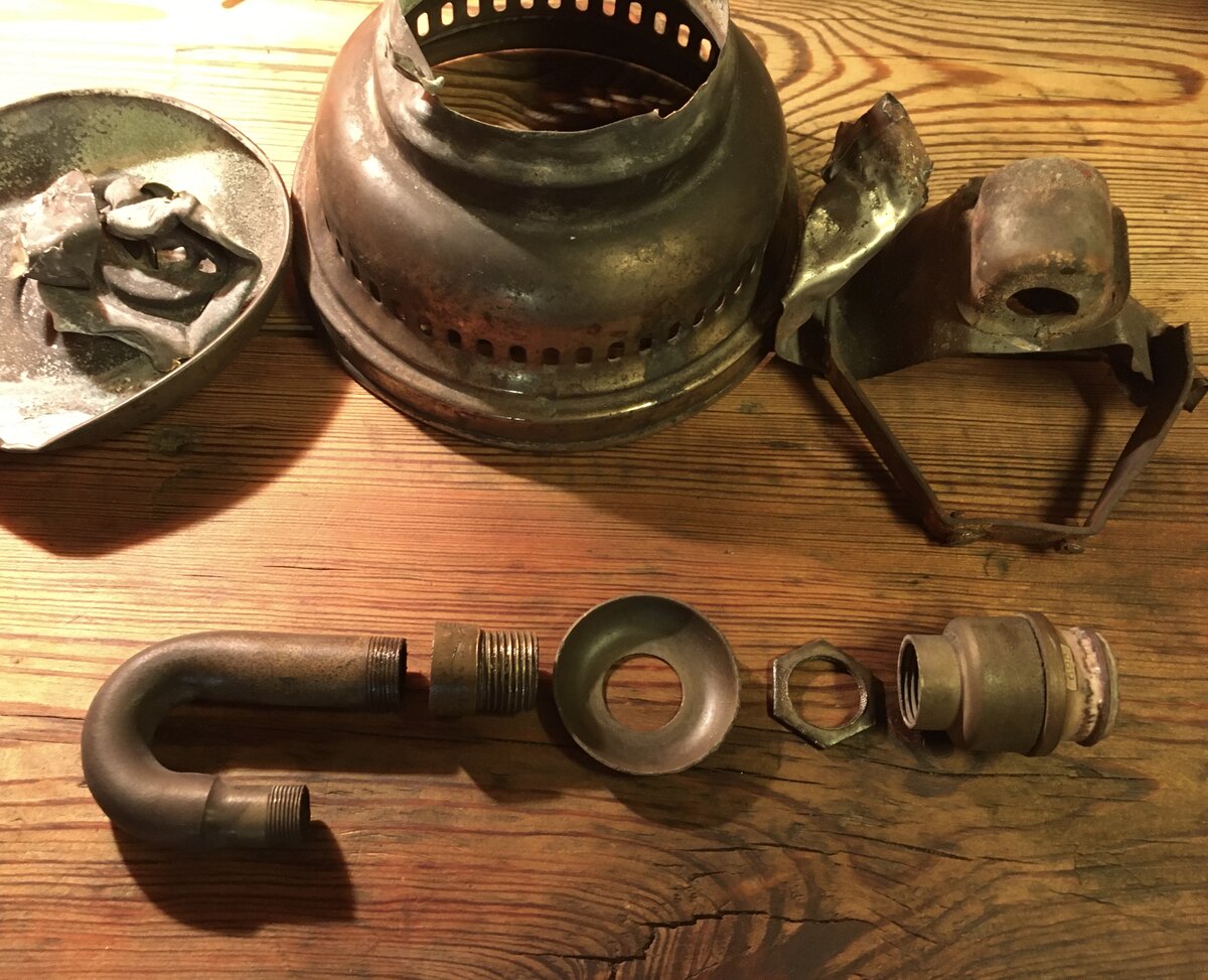

    Post scriptum to this adventure:
    I've recently bought another, slightly younger, Optimus 300 in really bad shape (bought it only to get a globe).
    Out of curiosity I disassembled the vent to see if I can extract J-tube, as a replacement to my adapter solution.
    To my surprise the setup is almost identical to what I have "invented".
    I had to tear apart the vent as someone used steel screws which galvanically corroded and welded all parts together.
    Exploded (literally) view below:
    After some cleaning the J-tube assembly back in one piece:
    It seems that Optimus turned into this construction to save costs: instead of variable-diameter tubing they used standard, generic tubes and thin-threaded adapters to connect all together.
    I'll probably substitute my J-tube with this original assembly.
    As a side note - this "heavily fettled" Optimus 300 is now one of my favourite workshop lamps. Probably due to all work which went into fixing the lamp (there were all kinds of problems, including punctured tank close to pick-up valve) I like it very much and it will stay in my collection. It acquired character, I guess.
    Too bad these lamps are so susceptible to wind blows. Not really storm lanterns - for heavy weather I take Radius 119 or Primus 981. Optimus 300 is an indoors beast.
    Does anyone know what is the purpose of that thread on another side of this J-tube? This is the side where vaporised kerosene enters the tube. On all my Optimus 300s there is nothing screwed here. I wonder if adding a "cap" will act as a silencer, like on some Primus lanterns?
  16. Nils Stephenson
    2,687
    This 2 piece J tube is seen on the early Optimus 300s. Why they did it is a mystery to me. It is a more expensive solution to make.
    The thread on the intake end of the tube is also a mystery. I have never found an explanation in any documentation, so all we have is guesses. I was wondering if it could be for attaching a restrictor for converting the lamp to alcohol. You would think that would be mentioned in a catalogue though, which it isn't.
