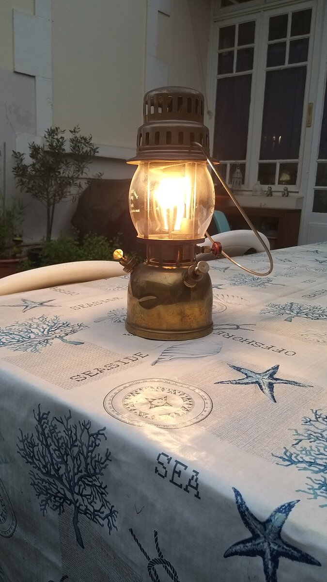

  11. Sellig33
    Sellig33 France Subscriber
    May 15, 2017
    944
    @Leo77
    My 630 run with this :
    And she run well
