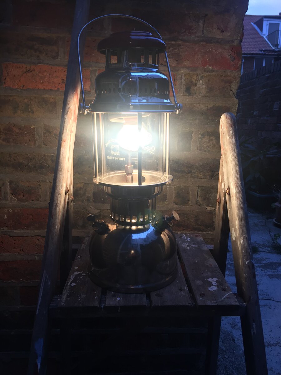

    Currently it will light but every time is a challenge of yellow flames, soot and frightened cats.
    I have fitted a complete service kit including needle and jet/nipple. There are no leaks. A .177 BB will go in one side of the preston loop and out the other. The jet is marked primus and is rated @350.
    When it does light it seems to be a bit gurgly. But no sign of fuel warming up or being pushed back through the NRV.
    Once it is going it also flickers more than I would expect it to. Paraffin when decanted through a filter is clean. The burner gap is 15.5mm so maybe a little more than it should be and the paddle is vertical.
    The mantle is from Juliands generic but seems OK and is rated at 350. The "J" tube (mixer) does glow cherry red.
    I am giving it 40 pumps and two cupfulls of spirit to heat. Once it is running the mantle settles down and there is no aura. But sometimes there is a green tinge to the flame as it settles down.
    I have reviewed the restoration of a petromax website (very useful) and followed advice given there.
    So if anyone has any ideas/experience to share I will be very grateful. Otherwise this is going on the shelf.
    Chris

    As luck would have it a second Optimus 350/350CP came my way. This worked well after adjusting the jet/j-tube distance. I transplanted the inner top to the original and it still misbehaved. Although the back burn had gone it still flickered and lighting was difficult. So two problems ? well I will share (for the benefit of others although it is a little embarrassing :oops:) that I had not managed to get the cock spindle in the correct part of the excentre (operating rod). This stopped the bottom valve from sealing properly, and resulted in the very sooty and orange start-ups. Furthermore I had not done the nipple/jet up tightly enough which was also allowing carbon to build up inside the vapouriser and probably also affecting the burn.
    It now lights up easily up with a single pre-heat, burns brightly and quietly and is flicker-free. Good as new !
    The old J tube has dents in it and is mis-shaped around the thread, no doubt resulting in a poorly performing gas chamber. A new one is on it's way. Hopefully I will shortly be a two Optimus household.
    Thanks everyone for the ideas and inspiration.
