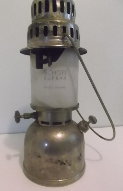

    Recenltly recieved this Optimus 930, the box was so small I couldnt reclose it, a few foam beans the only packing,
    No wonder the chipped glass didnt survive not that I cared, also the pump solder seam was freshly torn ,I think from transport damage .
    The lamp has cleaned up nicely a little solder job a spare Austramax un branded Schot globe, all that is needed to run is a porcelain nozzle, a spirit cup, & a new lead washer for tank - valve joint.
    Can anyone help with dating and parts .
    Graham

    I have always liked this lamp. Gratulation :thumbup:
    No fixed mixinghood and is stamped 300 cp so a wild guess is 1958-1960.
    With that wrapping, youre lucky. It looks beautifull.

  3. Nils Stephenson
    2,631
    This model was made for a long time so a precise date is not possible. They used exactly the same parts from 1957 until about 1980. Around the end of the 70's or start of the 80's they changed the filler cap and that was about the only change for the next 10 years. The best bet is to find out where it was used and what would be a likely period for when they bought it.
    Any Petromax style 250cp mantle holder will fit. The spirit cup is not so easy. The original was spot welded onto the base plate and it is not unheard of for them to break loose and get lost. A possible replacement is a spirit cup from a PEtromax style lamp agian as long as it doesn't have a tube below the cup.

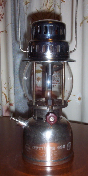

  4. Carlsson
    3,578
    Nils, does that filler cap look like the one on the brass 930 I posted last week?
    I assumed that my lantern was very late, and the filler cap look very strange to me. No Optimus markings, for one.
    Graham, I can see why you didn't bother about that straight glass it came with being broke.
    Pity nevertheless. It could have been used elsewhere.
    The Austramax globe does the trick just as well as an original Optimus globe (or an equivalent Coleman type). The important thing is that the lantern gets a bulged globe. :thumbup:
  5. Nils Stephenson
    2,631
    That's the one. The nickel version of the 930 continued for a while with this filler cap before they stopped that and only sold the polished brass version. That pointy winged filler cap was introduced on a few of their items at that time.
