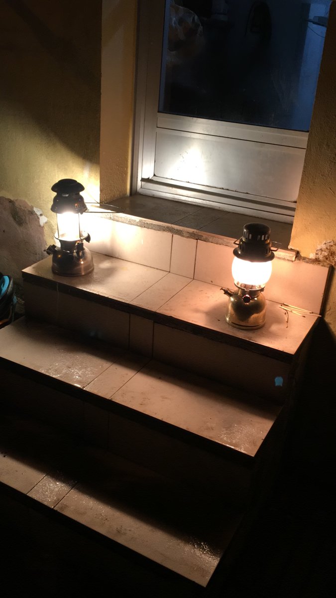

    yes, many times towards fire outside the manth, disassemble the tube j and tighten as much as possible all the parts of the burner and the jet, and I tried again, now it seems to be going well, but it needs a lot of temperature, at first when lighting it makes flames
    I think the problem came from some slack in the tube
    and here are my 2 lamps on, the optimus and a petromax 827
    Chers!
