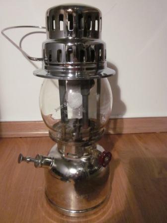

    I am trying to restore an Optimus 930. The lamp is in ok condition, but has not been used for many years. I have no former experience with pressure lamps at all. I have mounted a 300 CP silk mantle and changed the pump leather.
    I am still not able to pump pressure onto the kerosene tank and think the pump valve is the problem. Is it possible to fix the valve (loosen it and clean it)? Alternatively change it?

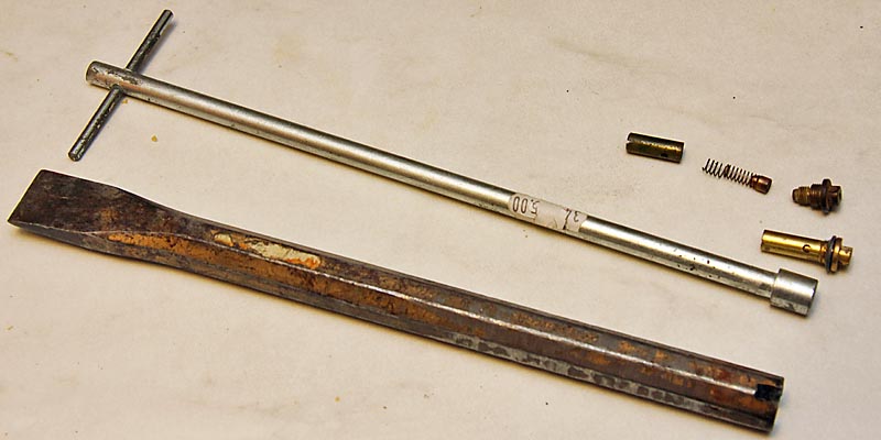

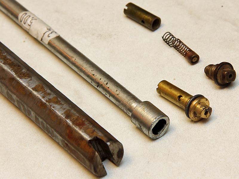

    Anyway, the NRV is removed (counter-clockwise) with a slotted tool that you easily make yourself out of some suitable metal part that fits snugly inside the pump tube. Look at my pictures below, and I hope you'll get the idea.
    The big thing at the bottom is an old cold chisel in which I cut a slot of the desired 5mm to fit on the head of the NRV.
    The weaker thing above is the original tool which I find to soft.
    Above that one you can see a new NRV, and above that one in its turn; a disassembled one.
    The best way for you to know where the air seeps out is to drain the tank completely, pump it vigorously, remove the pump and toss it all in a bucket of water.
    This will soon reveal the leakage, but remember that it probably will bubble out from the jet! This is normal due to the lack of a positive shut off valve.

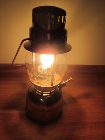

    I have never seen pressure lamps live and I am really impressed with all the light it gives off!
    Again: Thank you for good instructions and pictures!

    FMJ! I inserted your images into the post for you. (Just click "Fullsize" in the manager after you have uploaded your pictures. Just make sure the marker is placed where you want your images to show in the post. In some other foras you'll also get the option "thumbnail" to show clickable miniature images of your files in the post.)
    Your lantern looks great. The 930 gives out surprisingly much light considering its size.
    Just don't get too alarmed by the fact that it run pretty hot after a while. It's normal.
    I'm no expert on 930, so can't give you any exact production period, but probably around the mid-fifities or so. That control wheel was used on the first models.

    It says 300CP on the pressure tank. And as you state: It gets pretty hot after a while. I am amazed that the silk mantle survives the heat. I guess these would have to be replaced every now and then.
    I like the "complex simplicity" of the lamp. Interesting that there are so many different types registered on this forum.

    Yes the NRV is the same in both stoves and lamps. In fact a home made tool is better than the "Official" type. If you make one up from a bolt or whatever you will get a much heavier and better fitting tool which will do less damage to the valve. This is one case where the real thing is actually not all that good and you can make better at home. ::Neil::
