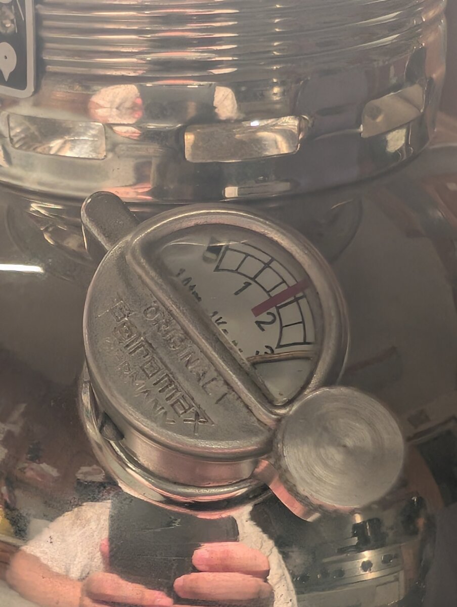

    I have an earlier Petromax 821 in great condition. When I light it, it starts off brilliantly white on a Peerless mantle. It does get hotter over a short period and then starts to go dimmer with overburn on the mantle.
    The burner and Preston loop gets red-hot (like on all my Petromax’s). The J-tube gets red as well.
    Is this because of too big or too small an air gap between the J-tube and the jet?

    You have a leaking jet, common problem with petromaxes. Tighten it up. Air gap on an 821 should be 7-9mm.
    As the lantern heats up, the loose threads are allowed to expand and kerosene vapor starts to leak and enriches the mixture.

    The only relation with amount of fuel versus light output/under burn is: air pressure.
    If you fill the tank the way it is designed for, with the blue plastic funnel you can't overfill the tank. In reality this is just under the filling opening.
    Let say this is 3/4 of the volume, then you are left with 1/4 of air space under pressure.
    This 1/4 will rapidly drop in pressure when using the rapid and normal use of the lamp.
    Do you fill 1/2, you have 1/2 of volume of pressurised air.
    Off coarse temperature is also a factor like air pressure but let keep it simple ;-)
    And how accurate is the pressure indicator?

    Hi all. I have tightened the jet, it had a small amount of play to fully tight. I also adjusted the air gap between J-tube and jet to 14mm, as per my other Petromax’s. This one has a little butterfly valve in the J-tube that was not completely “open”. I adjusted to open position. Lantern now running great! Looks like it was a combination of loose jet and air gap mostly. Not sure what role the butterfly valve has
