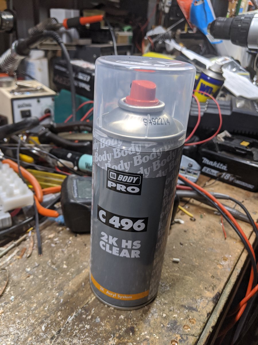

    I had the same problem protecting my Tilley fettle job. After four attempts with various I asked a guy at an auto crash shop. He pointed me to this stuff from bay of evil. It's basically a two pack coating in an aerosol Can. IMG_20200217_204339.jpg

    3,643
    @MozzoSA
    Very interesting, thanks for sharing.
