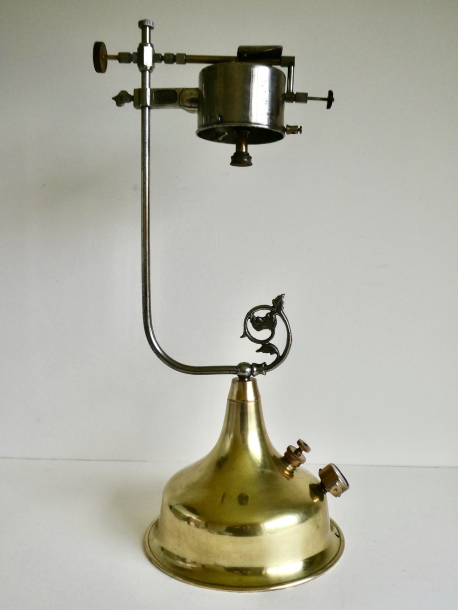

    This is a Pearl Light table lamp. It consists of an Australian-made Pearl Light hollow-wire burner especially mounted on a French Lilor heater tank.
    This lamp looks like it came out of the same lamp manufacturing environment as the Australian-made Gloria table lamps that used the Gloria No. 20 hollow-wire burner. The craftwork makes me sure that this was factory produced and not a home-made job.

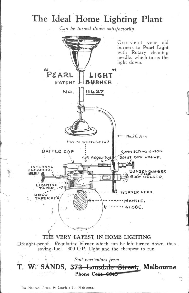

    The burner is that of a 1933 Australian Patent application by Joseph Swanson Doughty and Thomas William Sands (of TW Sands) shown here:
    https://classicpressurelamps.com/th...or-improved-burner-australia-no-11-427.11513/
    While it looks like a Gloria (and much of it is a copy of the Gloria No. 20 burner), it is a very interesting development of that technology. Below, I will post the parts against the Patent. I will discuss some of the features of the lamp and patent below.

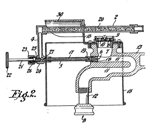

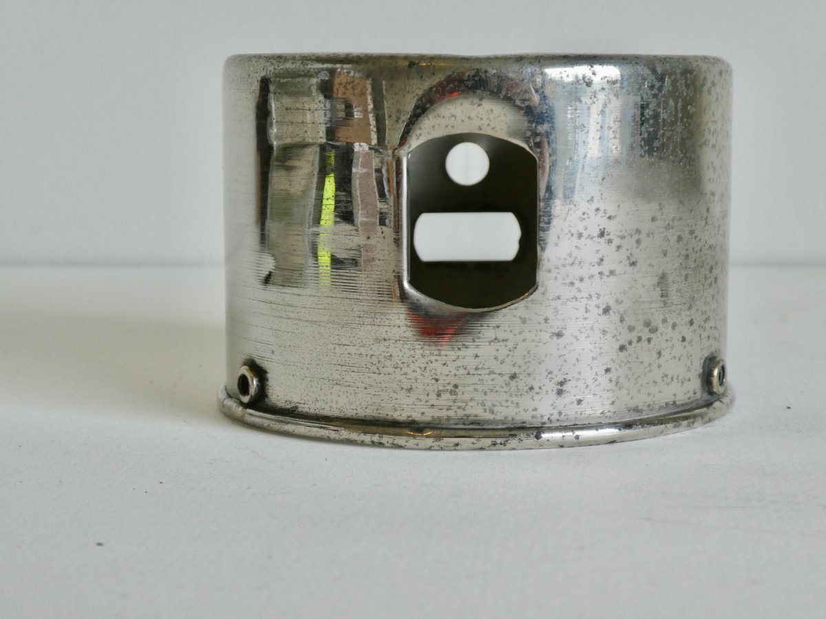

    Here is the Patent drawing with burner parts as a guide to the photos below:

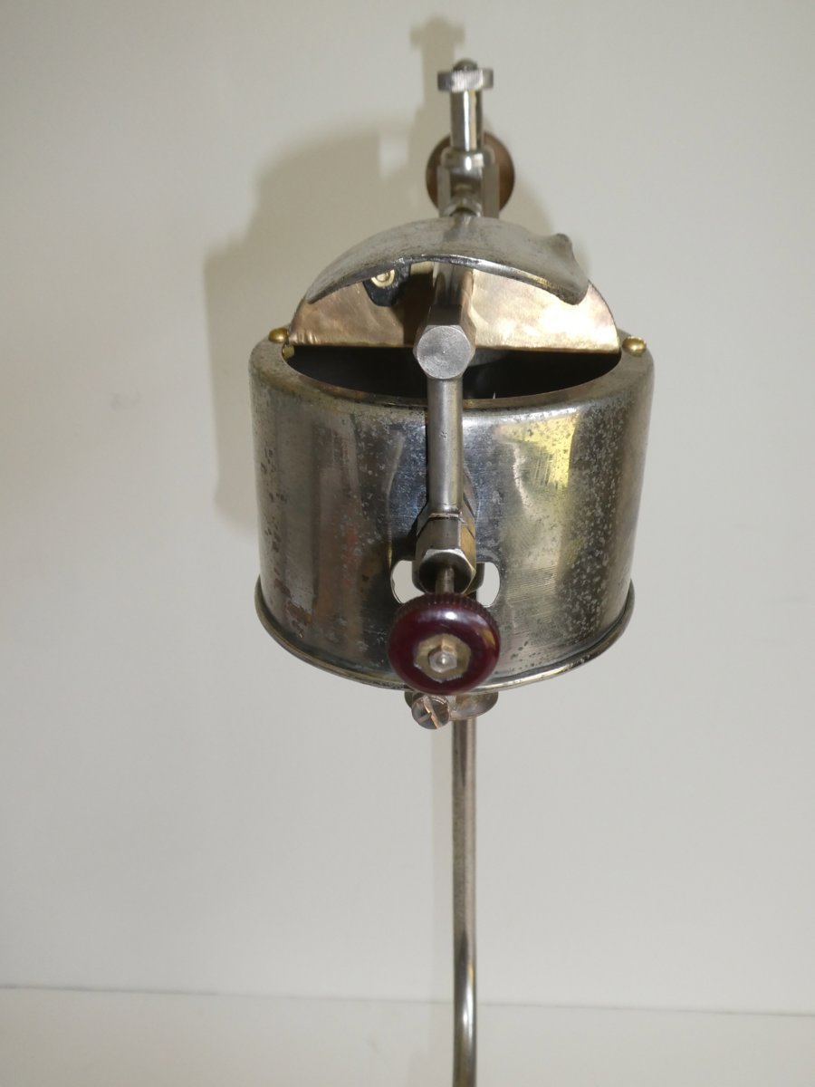

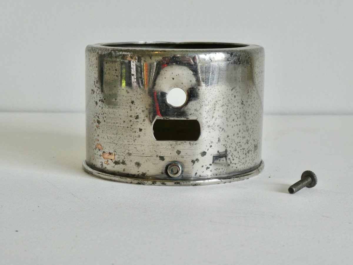

    The rectangular cut out is the portal for pre-heating the lamp. The patent says that the lamp is lit with a "taper".

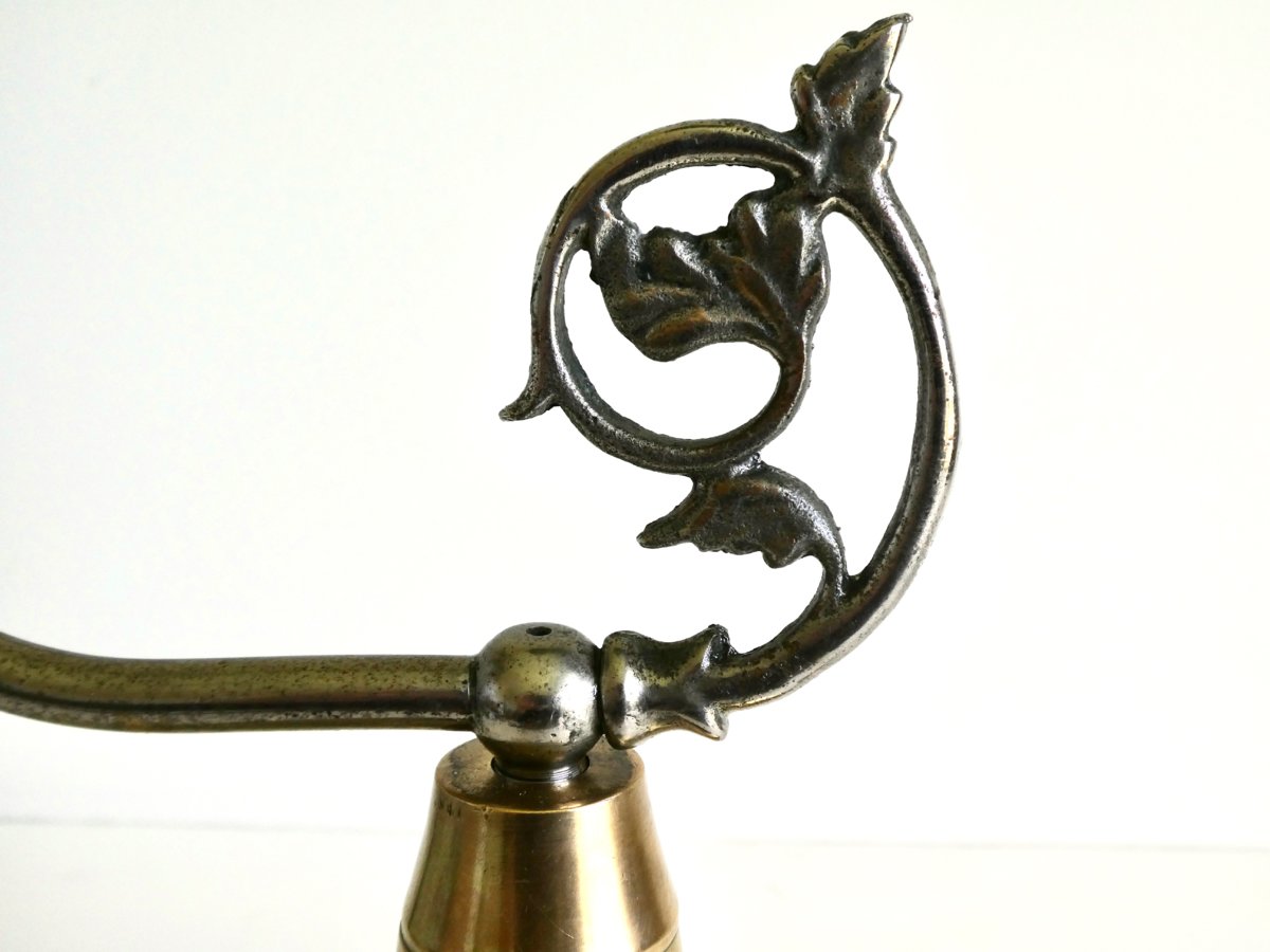

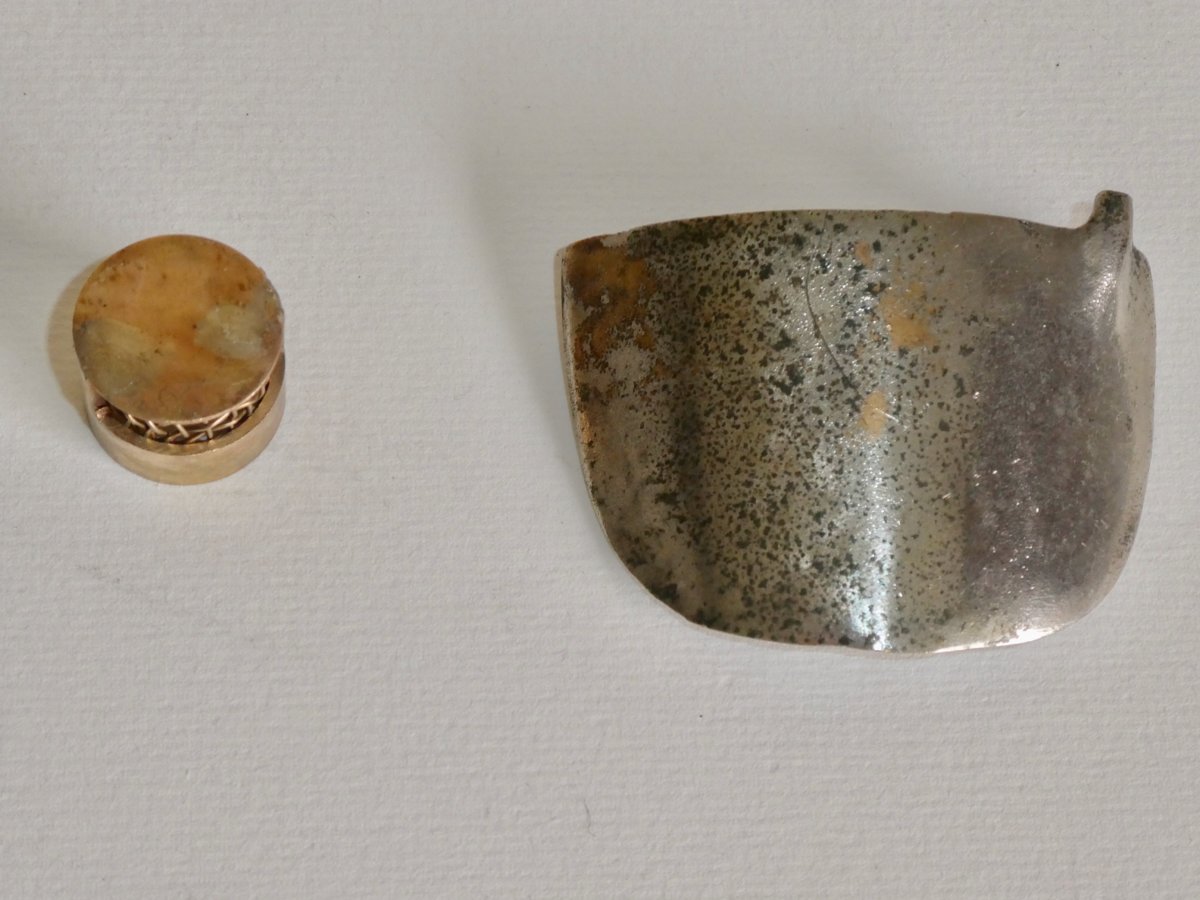

    The burner casting below is very heavy nickel plated brass. The grate on the burner cap is ceramic.
    The Pearl Light hinged hood cover is heavy cast brass, unlike the Gloria that is made of brass sheet.
    The Coleman-like filler cap and check valve.

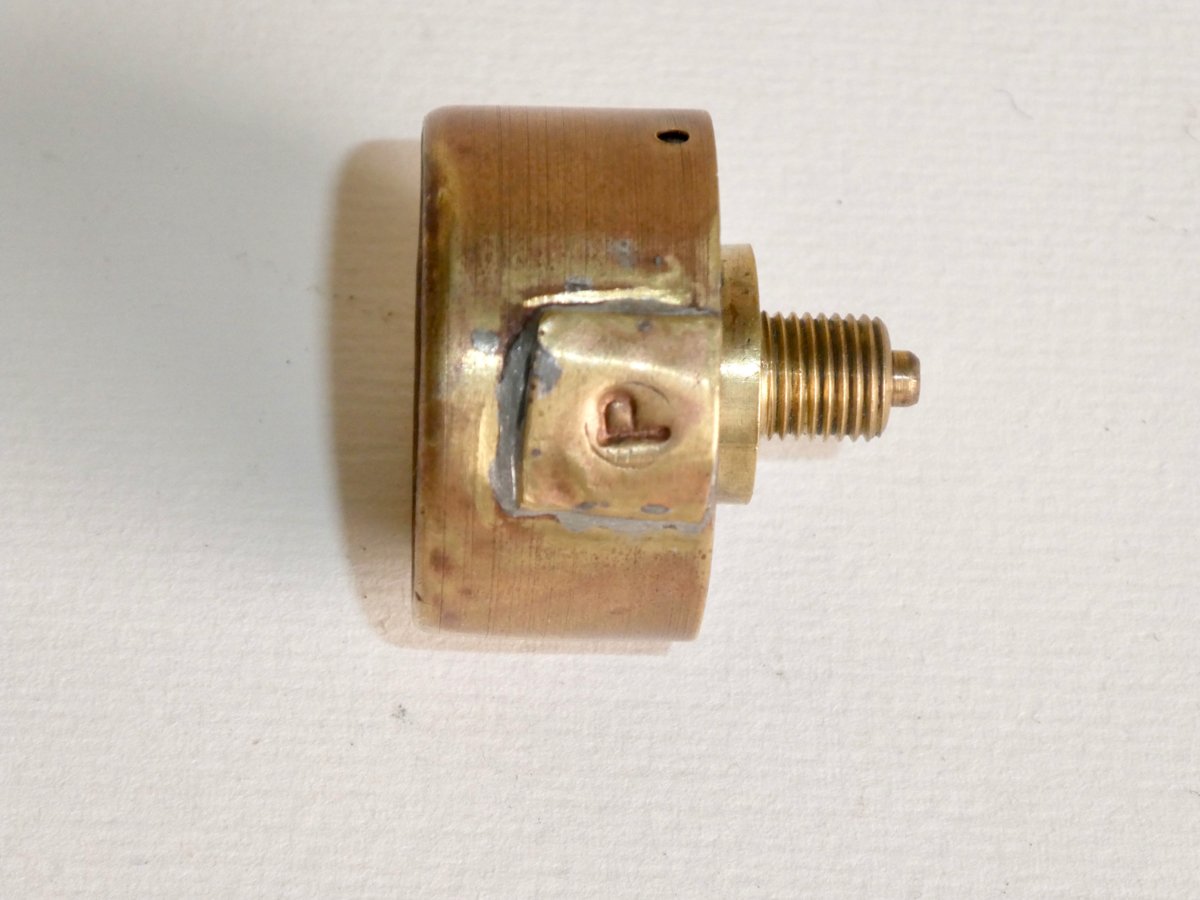

    The Lilor pressure gauge was pretty corroded, but I cleaned it up. It has a plastic "glass". I have a watch glass on order.
    The "P" is my mark on a repair I had to make to the pressure gauge.

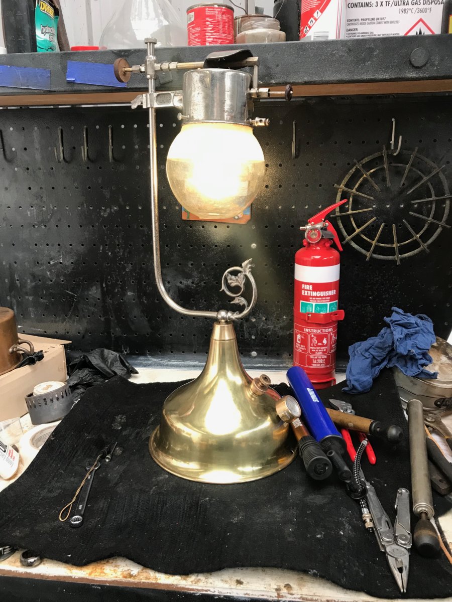

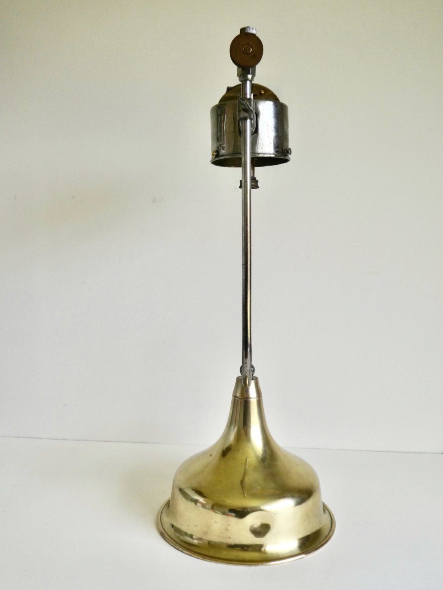

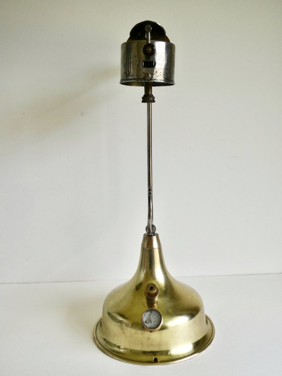

    As it came:
    Up and running:
    Studio shot at 15 psi.
    Full crank in the shed at 25 psi:
    The Patent

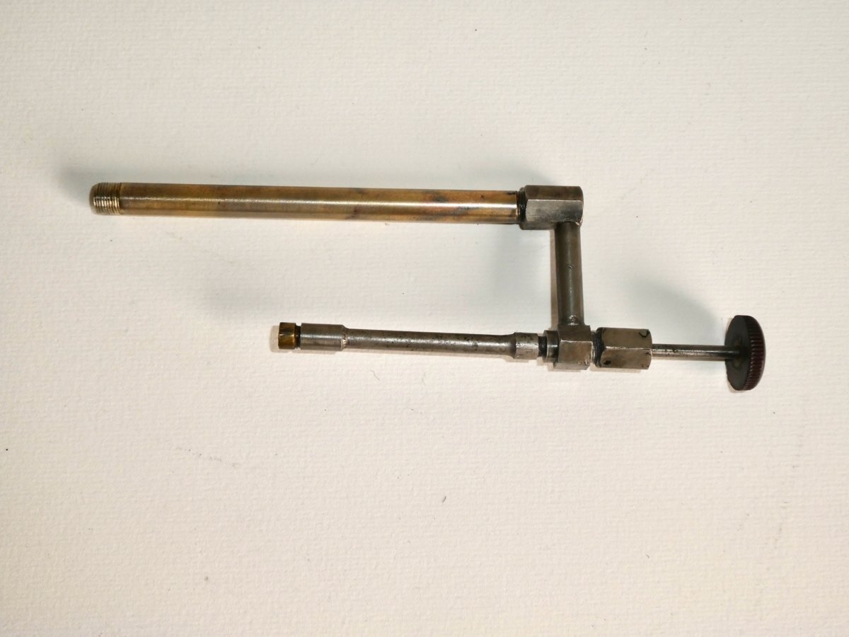

    One of the features of the Patent is the inclusion of two generators. The first (top) one is filled with asbestos fibre and it feeds the second (lower) generator:
    "Briefly stated the improvements comprise the employment of two generators resulting in improved vaporization of the hydrocarbon oil ... the generator pipe 2 is provided with a suitable packing 20 to increase the heating surface and prevent boiling of the oil. It will be understood by the foregoing description of one form of the invention that when a mantle M is fitted to the burner B and the latter lit, the heat plays on both generator pipes 2 and 5 and so ensures perfect vaporization of the oil. By means of this invention the generator can be set in operation by primarily heating same with a lighted taper subsequently used for lighting the burner so that the use of methylated spirits which is dangerous is avoided"
    (from the patent).
    The drawing above also shows the pricker needle and rod (17) that also acts as a dimmer for the light:
    "..the generator pipe adjacent the burner is provided with a needle valve for regulating the combustible vapour".
    Parts 8, 9 and 10 are simplified in my lamp (see photo above).
