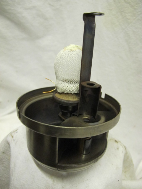

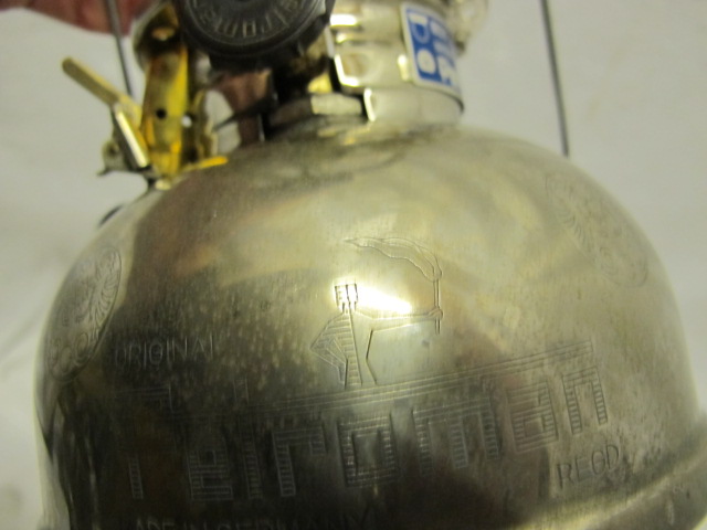

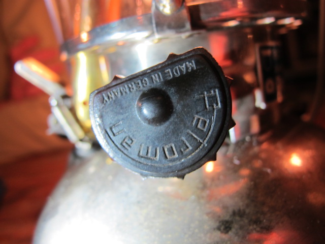

    Propably built at PETROMAX, Altena for the US market.
    300cp, gasoline
    Interesting details
    1325238170-IMG_0350.JPG 1325238185-IMG_0351.JPG 1325238202-IMG_0352.JPG 1325238234-IMG_0353.JPG 1325238255-IMG_0354.JPG 1325238272-IMG_0355.JPG 1325238298-IMG_0357.JPG 1325238320-IMG_0358.JPG 1325238354-IMG_0360.JPG 1325238396-IMG_0334.JPG 1325238423-IMG_0337.JPG

    Very interesting details. What is the filler cap made from? Is the quick lighter one of the Petromax variations?
  3. David Shouksmith
    Interesting - is that metal strip down the outside of the generator designed to prevent the mantle touching it and thus burning it out?
    Also seems to have quite an enlarged jet! - what's going on there..?
  4. Mackburner
    That metal piece looks like the adaptor to enable the use of a two tie mantle. Missing the ceramic block at the bottom and fitted the wrong way round. ::Neil::
  5. Mackburner
    The brand name Petroman was registered in 1954 to Graetz Aktiengesellschaft Hamburg (trade mark number 663242) and again in 1955 (trade mark number 669851). Therefore I assume any lanterns with this brand were made by Graetz KommanditGesellschaft (Graetz KG) in Altena alongside Petromax and Aida in the late 1950s and 1960s. ::Neil::
  6. David Shouksmith
    Initially, I wondered if that's what it might be, but it seemed over-long and IIRC, doesn't resemble the adaptor I've got around here, somewhere...
  7. karli
    karli Subscriber
    677
    The filler cap is made of a plastic.
    In German: Pertinax
    The preheater is not the like the Px construction.
    He has only one hole for the fuel from the tank.
    If you push on the knob of the cap, the tank
    looses his pressure very fast.
    A very good idea :thumbup:
  8. HighlandDweller
    Mar 9, 2014
    611
    Findhorn, Scotland
    I know this is an old topic, but the Petroman is a dual fuel Gasoline-Kerosene lantern and the metal piece on the generator is used to alter the fuel-air mixture. When fitted the lantern will burn gasoline and when removed it will burn kerosene.

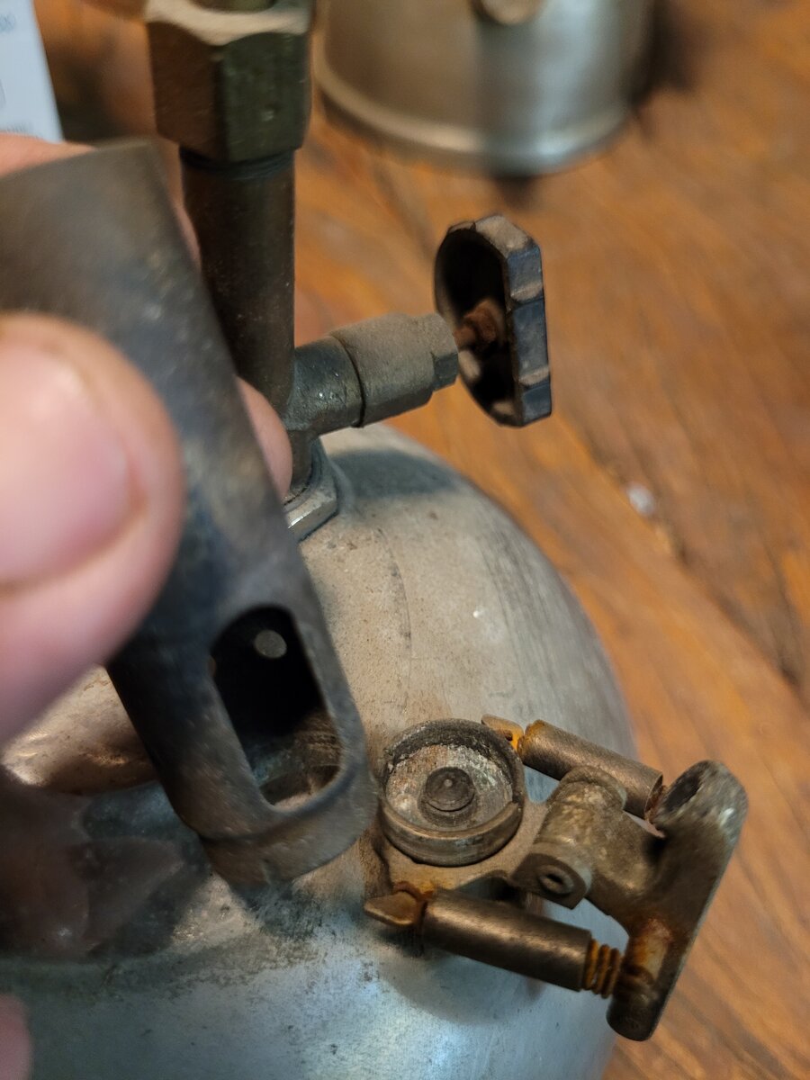

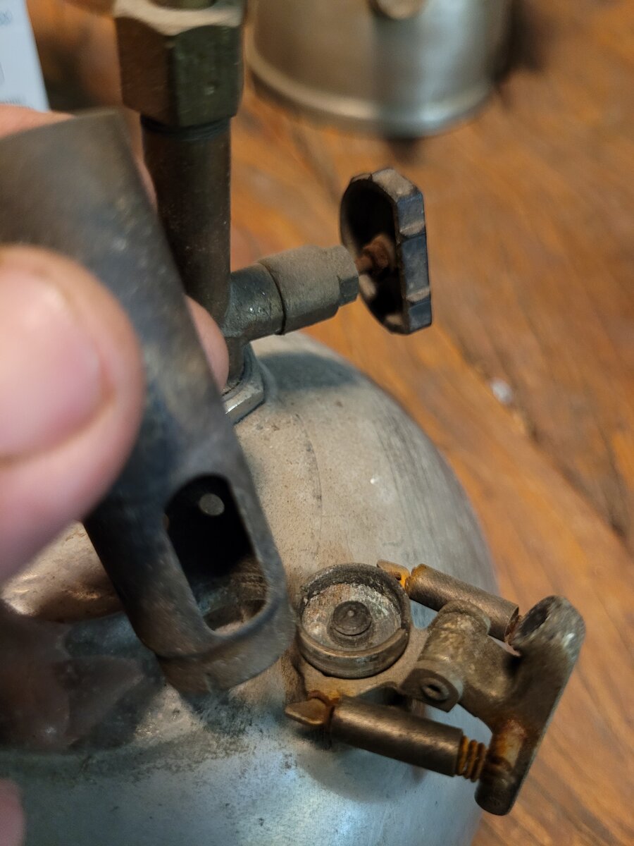

    Hello Karli, i know your post had a lot of years but if you still have the petroman can you post a photo of the torch? I have one but I dont know if it is complete or something is missing, thank you, best regards 20240926_224346.jpg
