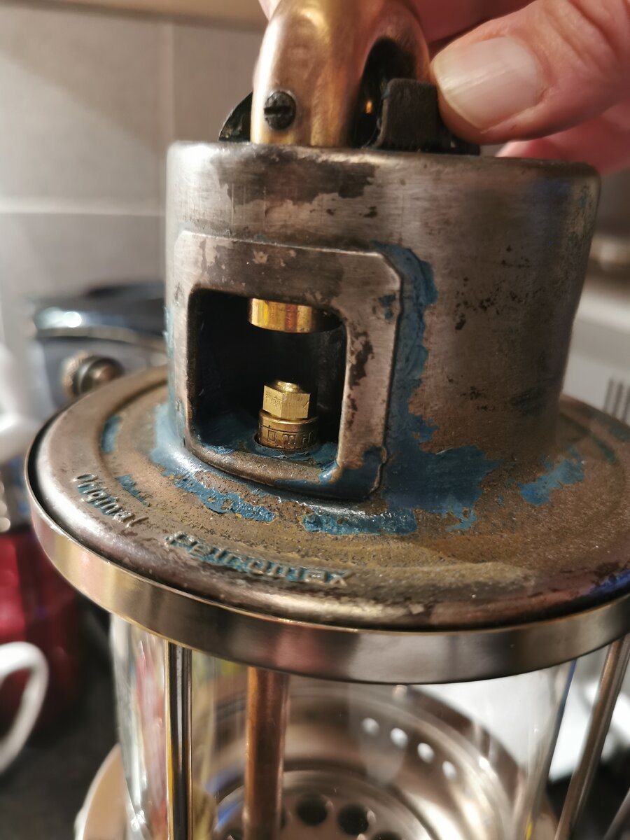

    Yeah I pushed it up but it still wasn't enough sadly
    Noooo we get these gorgeous lamps for the 500cp POWER don't we? Haha.

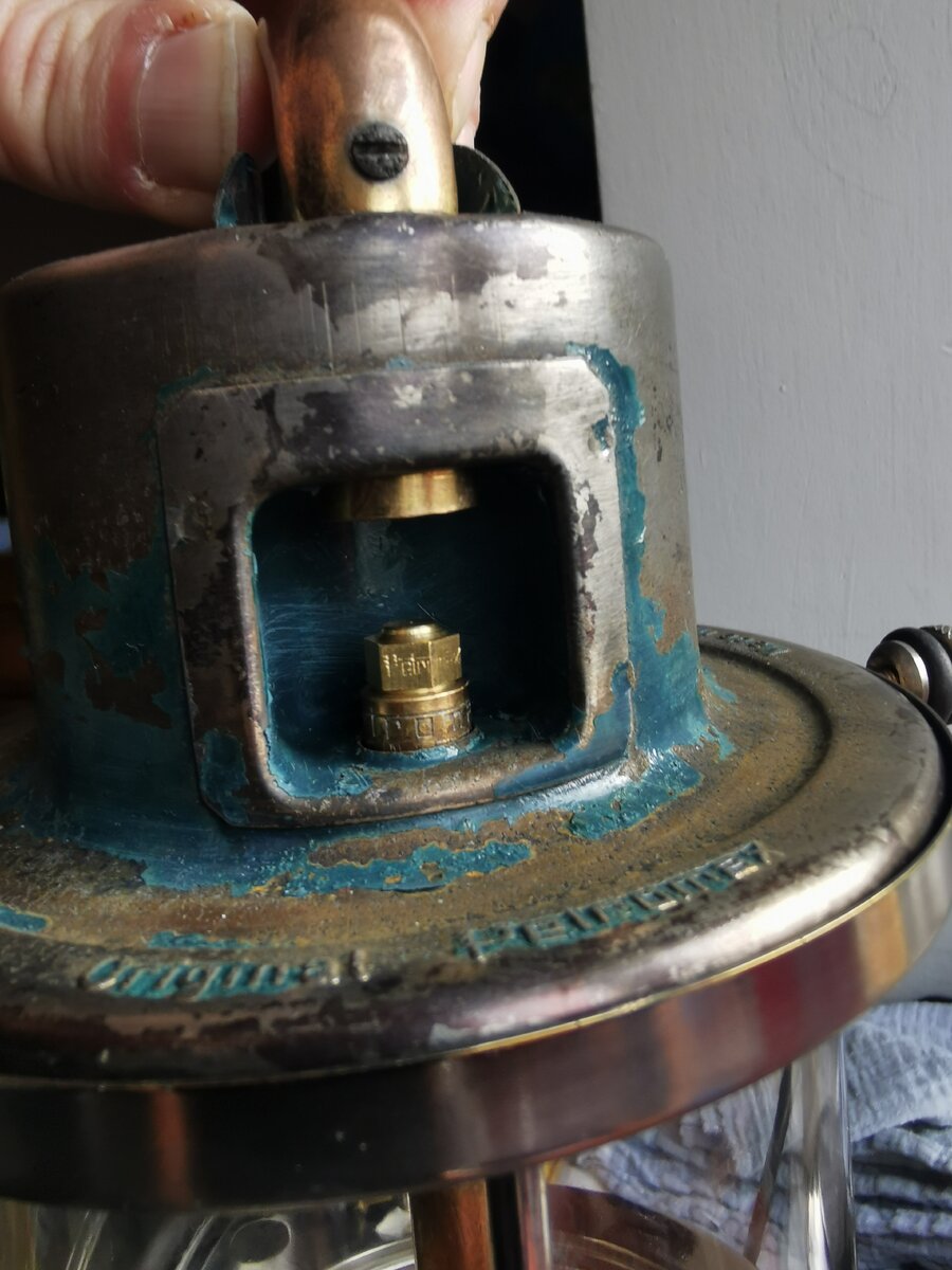

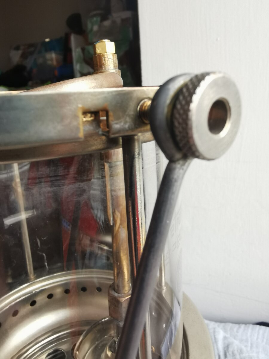

    I've taken a couple more. Not sure what else I can show?

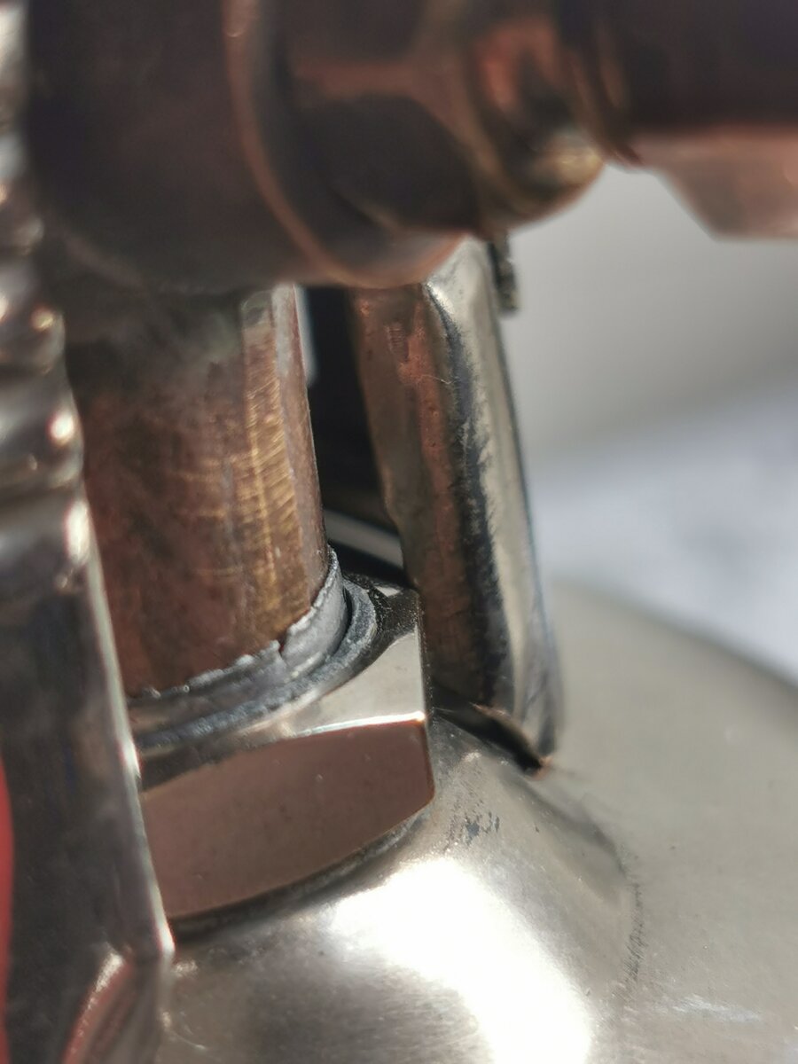

    Thanks Erik.. Well this last turn that I did was VERY stiff and squashed the lead washer a lot.. I am concerned that any more and it'll break if not already.
    After dismantling I removed the old lead washer. I replaced it with a new one from the Base camp site.. It didn't seem unusually thick.
    There is an air mixture screw/paddle, it's loose and lost it's weld or fixture in the J tube (another issue to deal with) so it's wonky. But I don't understand how being in the wrong position could effect the gap.

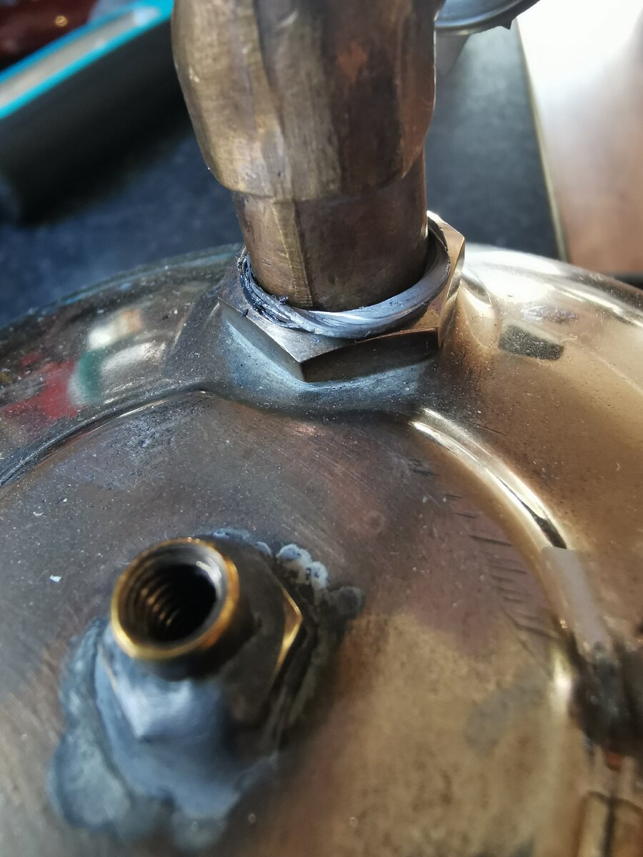

    You can see in one of the pics that the lead washer is squeezing out of the bottom where it screws into the fount.
    The other pic is the highest position that it'll go.

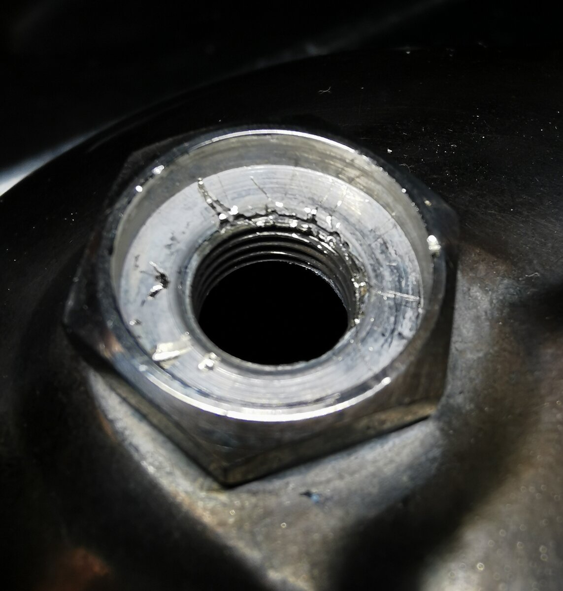

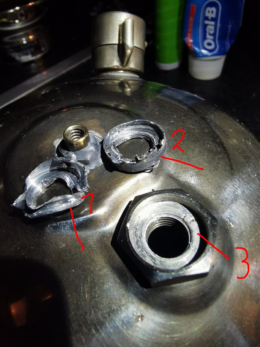

    The last picture with the lead washer squeezing out shows another one that remained in place. The fitting soldered into the tank is only the chromed hex nut, there can be seen another grey ring which belongs to another lead washer that remained in the fitting. Obviously it is much harder that the one you used.

    This picture shows that the vaporizer seems to be protruding a little too high above the inner hood's flange: IMG_20251112_133926.jpg
    Check the vaporizer again too see if it is the correct Petromax one. Ensure it isn't a vaporizer from another brand which, can sometimes be slightly taller than the original.
    As mentioned by others, check again if there's actually another older lead seal that could be causing the vaporizer to be seating too high.
