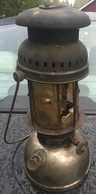

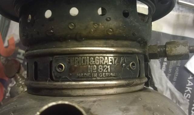

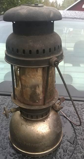

    I had these images of an old 821 sent to me by Petri in Finland. Appears to be an early 30s or maybe even late 1920s example. I can't think of another with a collar label like this one. ::Neil::

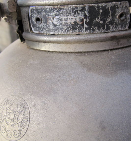

    It would be nice if he (Petri) would search for the scratched numbers in the buttom of the tank. That would tell the age more precise.
    It is not easy to see, but I believe the vapourizer is in one piece - so early.

  4. Mackburner
