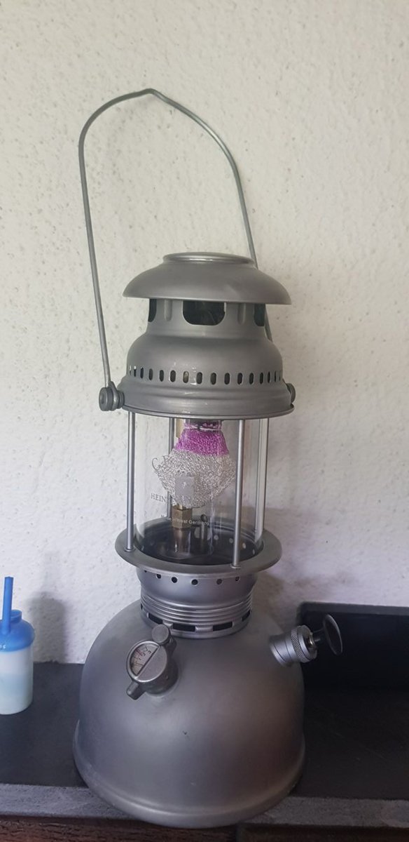

  7. Harder Sorensen
    Harder Sorensen Subscriber
    Jun 6, 2018
    48
    Thank you all for good and sound advice (have sacrified several times x eyebrows and hair, incl. 3 x Eye surgery in my younger years ](*,))
    - but I wonder, how come we have been using the same NRV design in our Optimus 111B for ages - and still do. Eventhough the fuel is much closer to the flame compared to a lantern mantel behind a globe?
    Several armies have used the smaller PX with petrol for a decade or two?
    The accidents which now and then took place - how many were caused by pure stupidity or neglient maintenance and how many were actually due to malfunctioning NRV’s?
    Looking at a beauty like this made on specific NATO specs (Petrol and 10 hours continous burntime) - they can’t be that bad? Or are even this one a disaster waiting to happen?
    (Picture borrowed from Finn Hjelmerud)
    That said - I will definately reconsider my project.
  8. ColinG
    1,264
    Maybe the military spec ones had built in safety features as part of their design? The matt chrome finish looks pretty badass actually!
  9. JonD
    JonD Subscriber
    Apr 15, 2014
    615
    Hertfordshire, England
    Isn't safety in a military environment something which is "relative" and even then quite a new idea? (Compared to the lamp designs under discussion at least).
  10. MYN
    713
    There are no additional safety features in the military Petromax(Bundeswehr) as compared to the civilian ones.
    The only differences are having a straight vaporiser instead of a Preston loop, supposedly meant to burn 'Benzin' and has a matt finish.
    Provided there are no defects on the lantern, you can still burn petrol in any such Petromax, including civilian ones and light up fine.(I've done that).
    Only thing is, you can't do it safely. And you do at own risk. For instance, should the NRV fail when the lantern's in operation, it'll flood the pump and surroundings with petrol and that'll burst into flames almost instantly, well before you could do anything to stop it.
