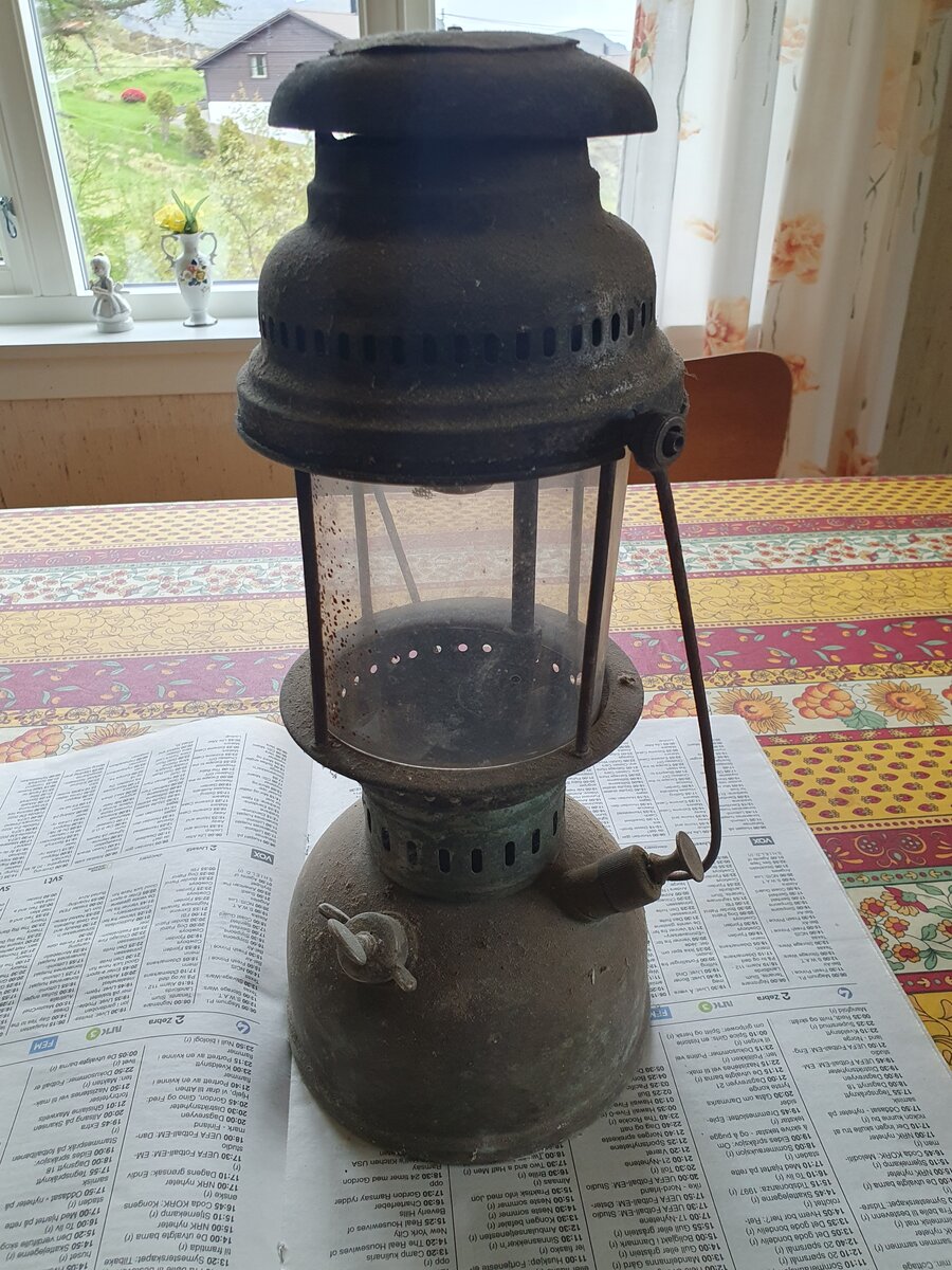

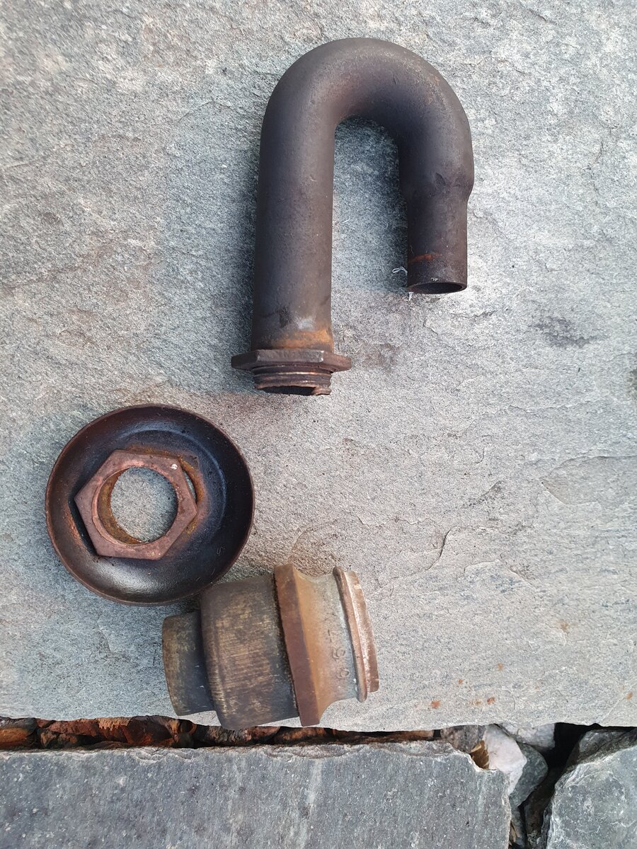

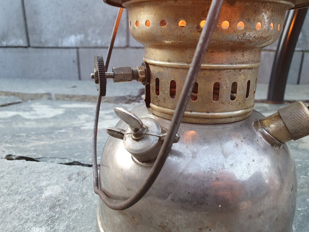

    I finally decided to have a go at refurbishing this petromax 826. Im a pressurelamp-noob, so maybe you guys can give me some guidance :)

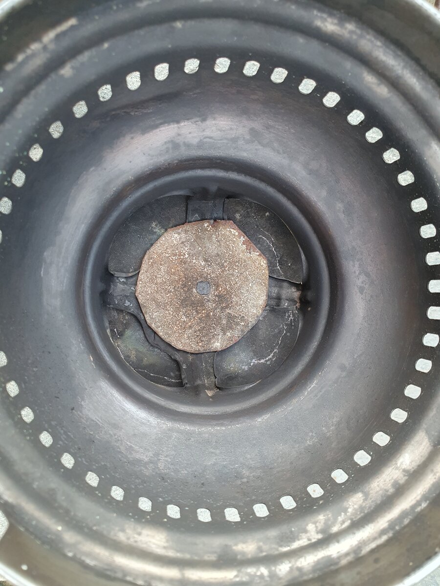

    It has been sitting in a basement since my grandfather passed in the 60s.. This is a pretty corrosive environment, and the lamp show signs of this. The inner hood (?) is badly rusted. Is it possible to find a replacement that fits?
    What replacement globe and mantle will fit this stove?
    The rest of the lamp looks to be in okay condition. The adjustment knob turns freely, and the cleaning needle pokes out when knob is turned. Pump assembly looks to be in good condition.

  2. Sellig33
    Sellig33 France Subscriber
    May 15, 2017
    875
    15,180
  4. eiremax
    eiremax Subscriber
    Jul 5, 2014
    623
    Potential is there! Parts readily available. Look at the bottom of the tank, there may be a code scratched into the base similar to what was done with earlier Petromax lanterns. Your regular 829 globe will fit as will any 500HK mantel. (I use Helox). I presume you are doing a complete strip down and clean? Plenty of resources on YouTube that can show you the process better than I can type it! If you have access to an ultrasonic cleaner that would make your life easier

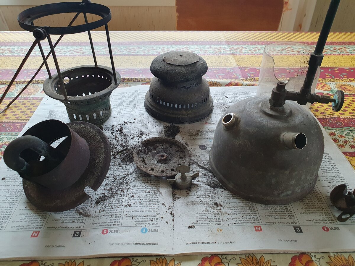

    I will do a complete teardown and cleaning. I dont have access to a ultrasonic cleaner, but i guess a citric acid solution bath will do.

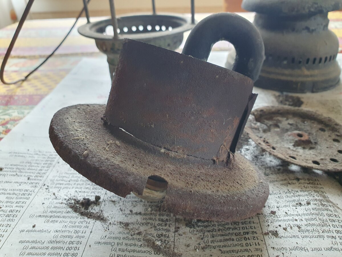

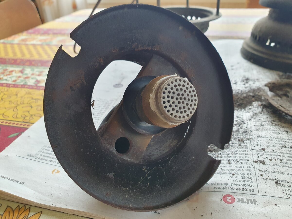

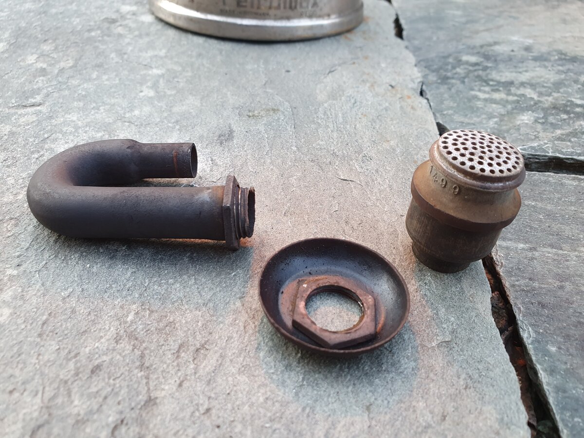

    Looks like I can get most replacements parts from the sources you guys provided. But I cant figure out what to do with the inner burner hood. Do i need a new replacement piece (part p117) complete with mixing tube and burner? Or try to fix the one i have?
  7. Fireexit1 United Kingdom
    3,220
    The mixing tube/burner are brass so should be OK. I would look for an inner hood. A new one or a second hand one would do. Others will confirm but I think the 826 and 829 ones are the same.

    Should have no problem in finding a European made hood, ie. From Petromax, Geniol or Hipolito. The inner hood you show is identical to my prewar 2826. If you want take a measurement of its outer diameter along with the height of the rim. I can double check interchangeability for you with that of the above mentioned brand hoods. No harm in checking just to be sure.

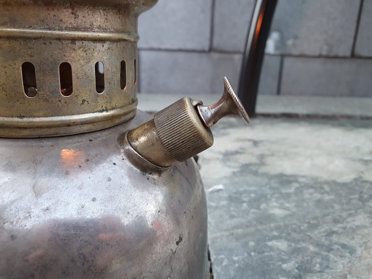

    After some time spent tracking down parts and a bit of fettling, this 826 was brougt back to life. A few soaks in a citric acid bath, a new filler cap gasket, new globe, and a new inner hood, new mixing tube, a spindle gasket and new pump leather made it light up again.
    The nickel plating is almost completly gone on the collar, but still mostly intact on the fount. The top of the hood has at some point been fixed. I kinda like the rustic look it has now.

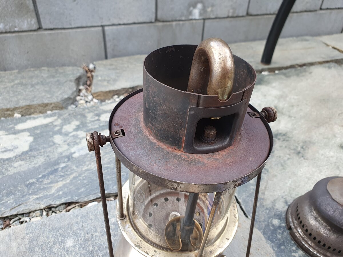

    The old inner hood was completly rusted trough multiple places and had to be replaced. I bought a used complete inner hood. I dont know wich make this is, but the place i bought them sells both surplus primus 1082 and optimus 300/350 lamps. So i guess its from one of those.
    My plan was to mount the original mixing tube in the replacement inner hood, but i soon found out that the mixing tube was in bad shape and couldnt be used. The inner hood i bought had a mixing tube with an ajustment screw. This screw made the hood not fit properly, so i had to replace this aswell. Luckily i found a compatible mixing tube.

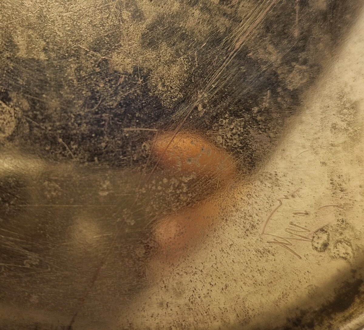

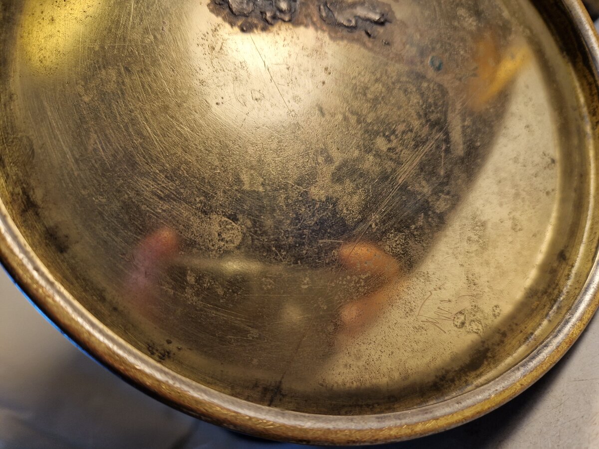

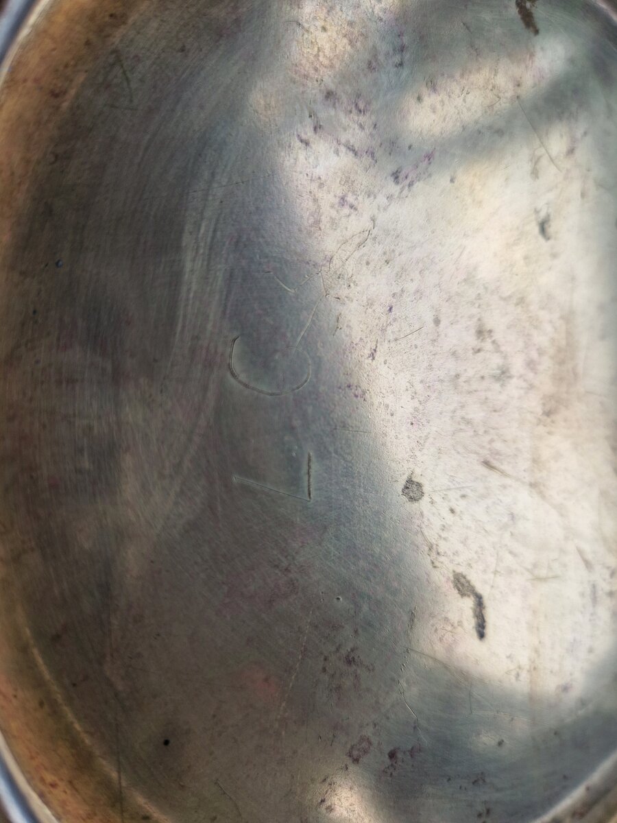

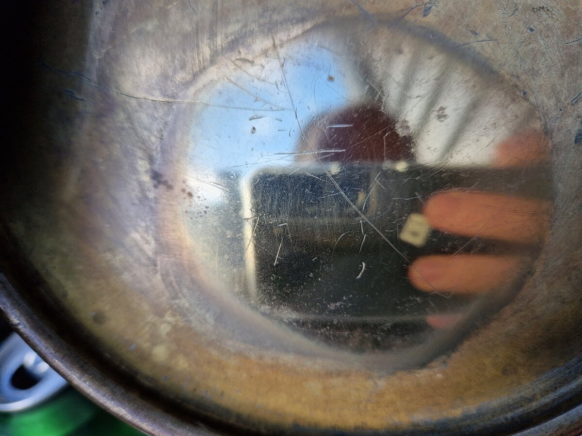

    Im curious how old this lamp is, it i possible to date it based on the pictures? I have not been able to find numbers on the bottom of the fount.

    It would be hard to guess the manufacturing date without knowning what had been inscribed/scratched at the fount's bottom. Those dating from the 1960s and later would have numbers stamped at the fount's bottom plate. Your lantern mostly has typical constructional features of the pre-WWII Petromax 826 design...especially those made in the late 1930s /early 40s.

    Unfotunately I have a chronological hole in my collection from 1930 to 1936,so I can't look it up.The hood cap was put together by someone himself.Except for one variant of Petromax900,as far as I know there are no other Petromax with only one screw for fastening the cap.
    The hood has only 4 bars. The carburetor is already in 2 parts.The inner case looks strange for me ,it has features that I don't know from Petromax.
    The J-tube does not have enough threads to properly attach a mixing chamber to it.
    Please clean the bottom of the tank with cleaning polish.Perhaps you can find tank scratches there that can be used to identify the age.

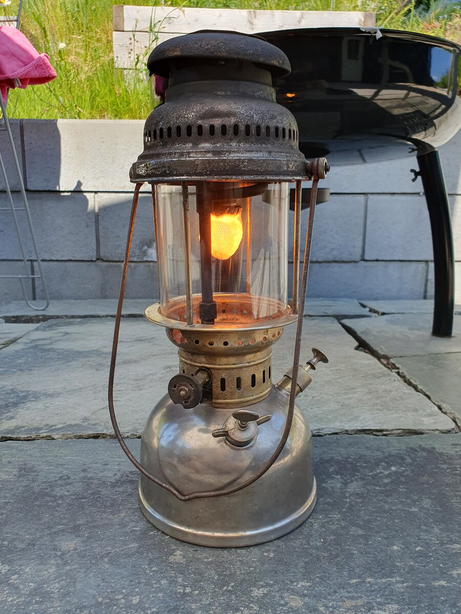

    The distance between the jet and mixing tube is correct according to my petromax-tool. I will try to adjust it until it gets just right O:). Does a yellow tint suggest a too rich fuel/air mix caused by a too short gap between the jet and mixing tube?
    I took a picture of the lamp in my dark, not wery tidy shed. More white tint this time. Since this is my first pressure lamp, i have no idea how bright they are supposed to be :-k.
    The inner hood is a replacement, as is the mixing tube. The original mixing tube broke when i tried to remove it from the inner hood. It was so corrodet that i using very little force litteraly tore it in half :whistle:.
    I looks like the cap on the hood has been corroded in such a way that there is a big hole in it. My grandfather apparantly fixed this by riveting a piece of metal on top of the cap, and one inside the hood, sandwiching them together. It may have had 2 screws holding the cap to the hood originally.
    I will do another search for numbers on the bottom of the fount :D

    The colour looks fine - it is difficult to tell from a photo but I think it could be a little brighter. I use a lux meter installed on my I-Phone - it probably does not tell the truth in relation to the actual brightness but it can be helpful when comparing before and after moments..

    A yellow tint can also be due to the mantle composition. If you've replaced it with a modern mantle, it could well be yttrium-based. The older radioactive thorium-based mantles usually, but not always, give a 'whiter' tint. That in turn can make it appear visually brighter(eye perception) but not necessarily brighter in the actual sense (by lux measurement).
    You can also try adjusting the air gap higher than the normal 14.2mm to see if there're any further improvements. That's provided there is still allowable threads and room in both the j-tube and its mounting within the hood.
    Besides that, see whether a few more strokes on the pump(slightly higher pressure) makes it brighter or yellower. If it starts to get yellower or sooty, then you know its due to improper fuel-air adjustment.

    First picture is defenitely a not well burning lantern in my opinion.
    The last one is better.
    There can be several reason for this fro dirt to worn parts.
    That is why I always say that you must understand how the lantern works so you can identify problems but more over, can fix them.

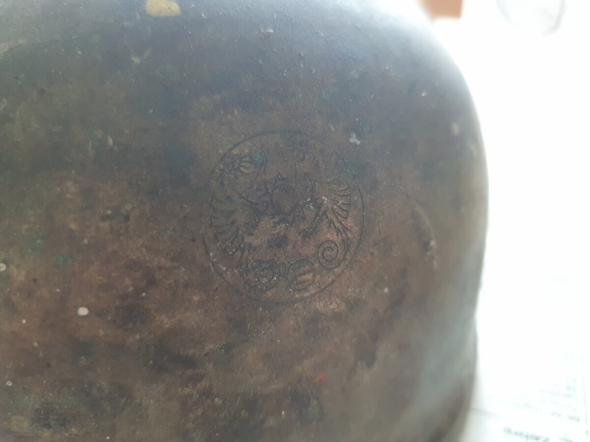

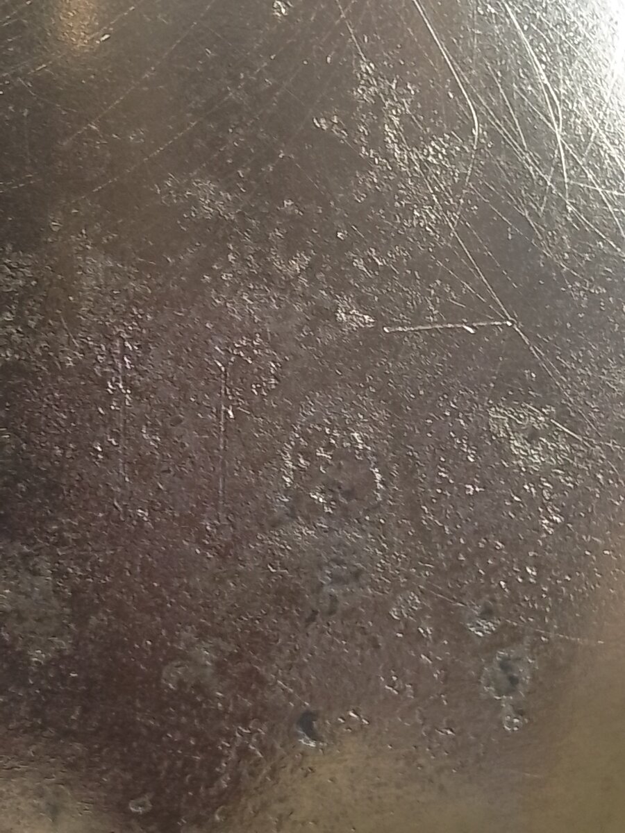

    I took another look at the bottom of the fount and numbers appeared :content:
    I read them as 11 6. So november 1936?

    Ah, got the pics mixed up. It is 7 7, so july 1937?

    It is common or typical that numbers are handwritten or scribbled in the following way in Germany and Austria:-
  26. Reinhard
    Reinhard Germany Subscriber
    Oct 15, 2018
    759
    @Bjorn
    You got the numbers absolutely right.The first number is 11 6 = November 1936 and the second is 7 7 = July 1937.
    Thanks for showing this numbers.I just checken my Petromax 827 from 1937 and the numbers are so bad there too.11 7 = November 1937.

    Yes, the numbers are pretty faint. I zoomed in a bit here to make them more visible:
    The numbers on my 828 stand out very clear in comparison:
  28. Reinhard
    Oct 15, 2018
    759
    The numbers aren't always weak,but what bothers me is that they look more like Norse runes than Arabic numbers.But I can read them.The last numbers are 9 7 = Septemper 1937.
