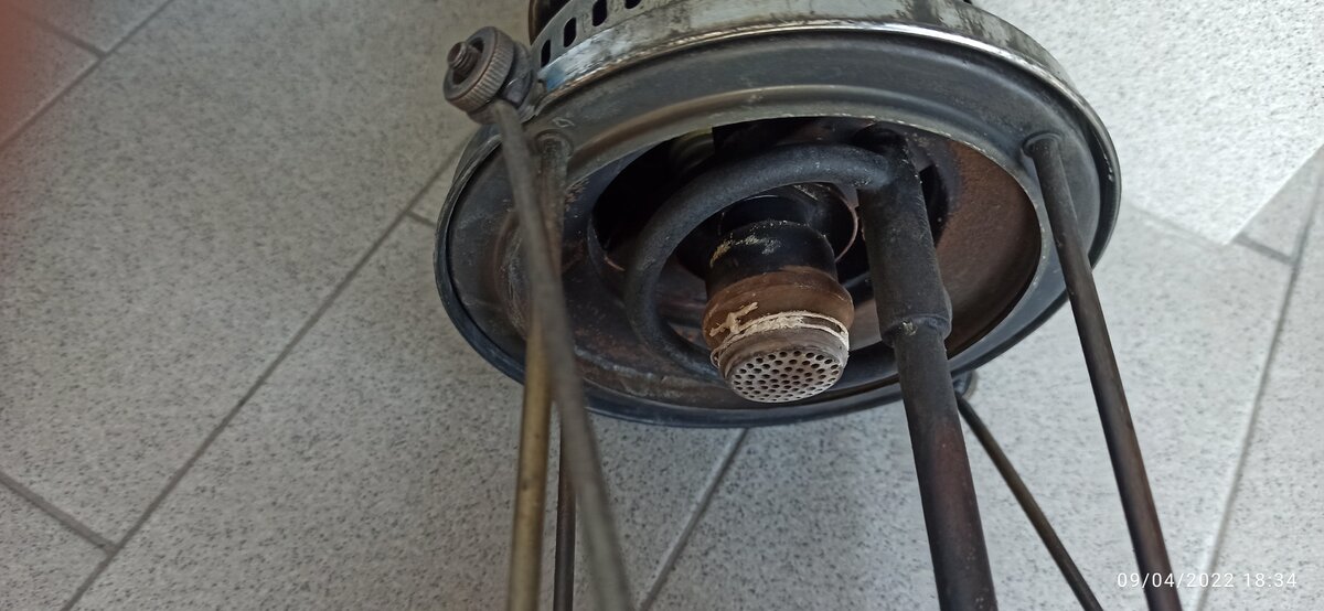

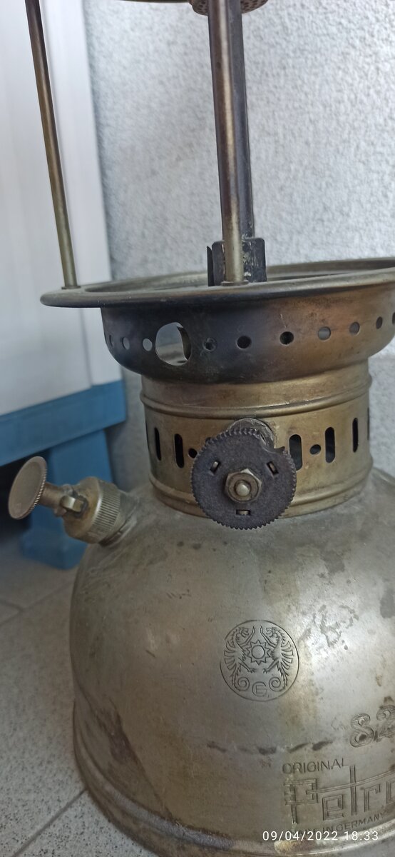

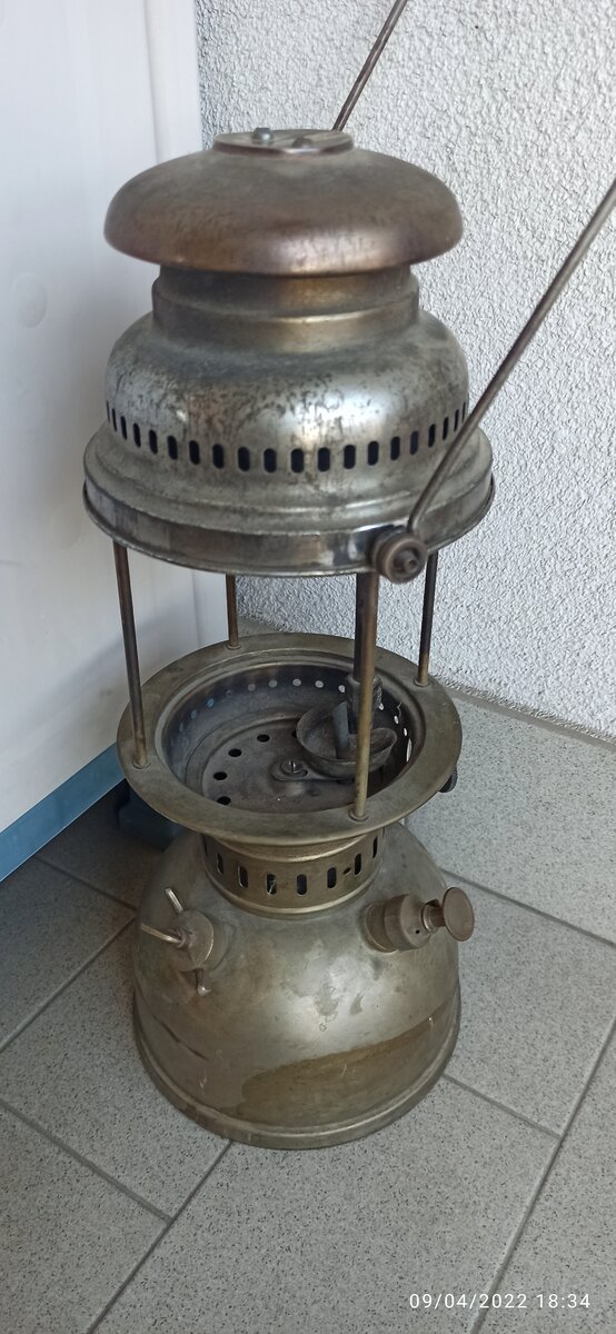

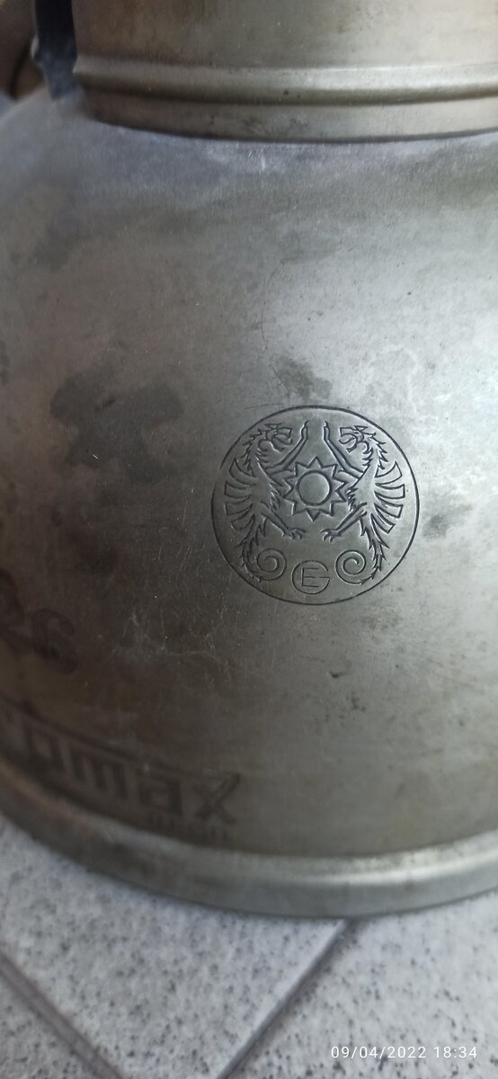

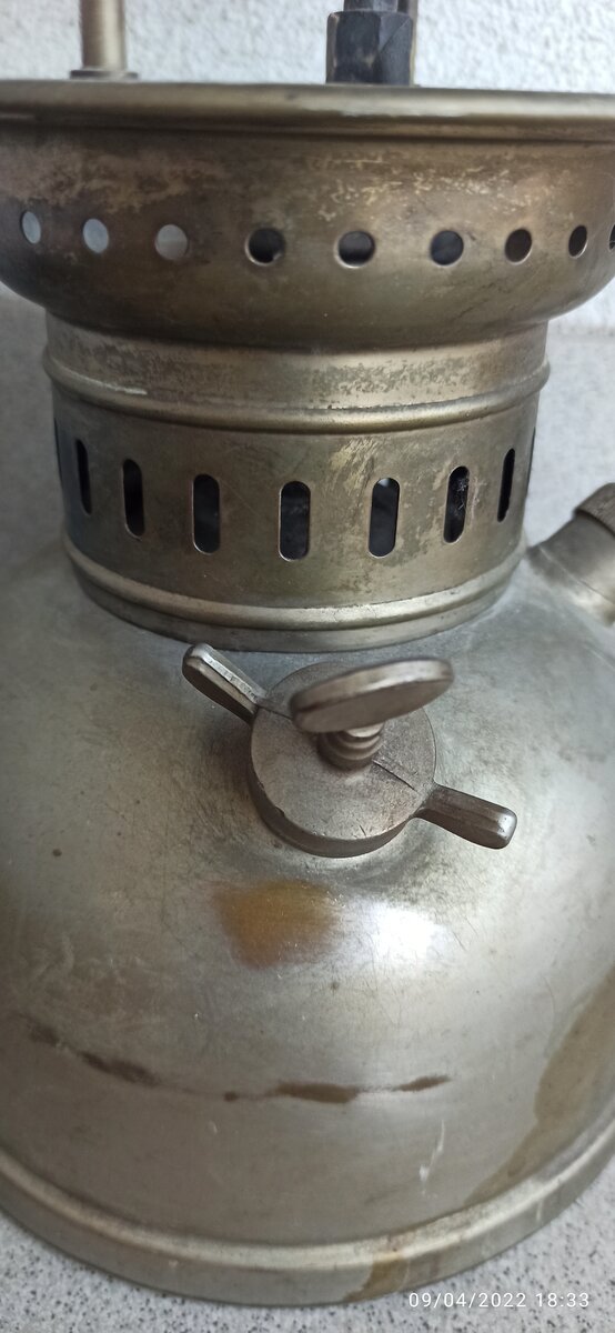

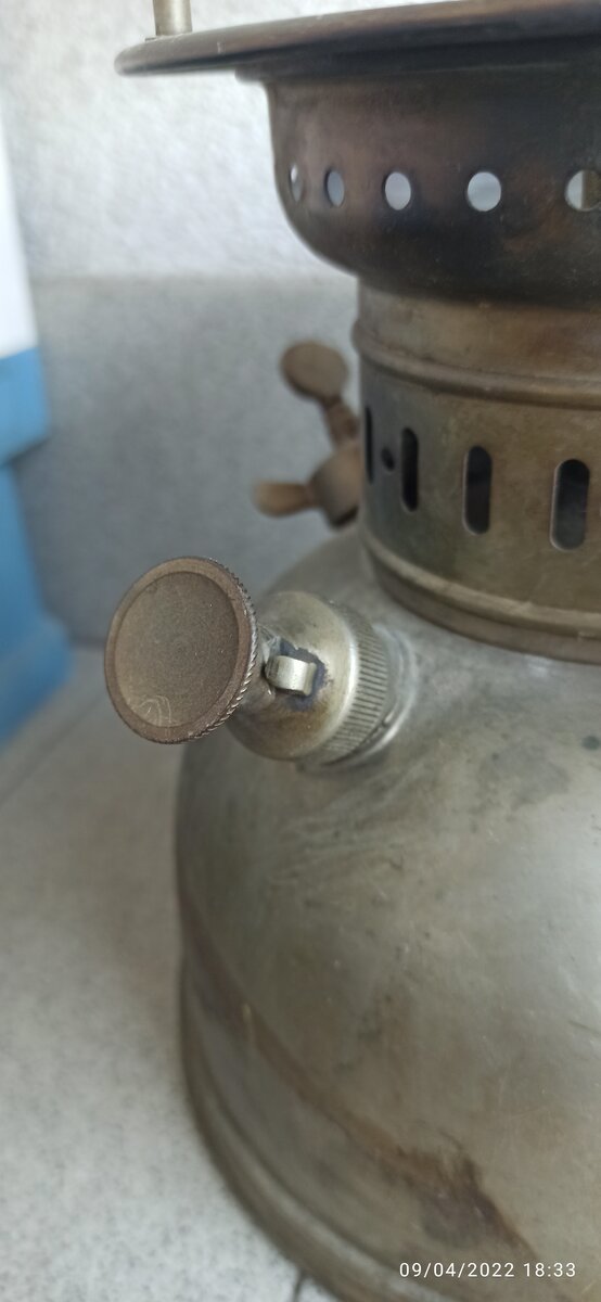

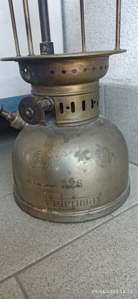

    Good morning everyone I am a new user, my name is Renato and today I bought a Petromax 826 of which I attach photos. Can anyone give me some information about it. I would like to put it back into operation and then recover the glass screen, but first I think it is worth doing some tests, some suggestions. I also have a Coleman 220K that without many problems I use after a general cleaning and that's it, but for the Petromax I know that I will have to work on it, thanks in advance for the advice·​

    Great lantern ! That should clean up and light well.

    Hi @Renato Lorenzi , and welcome to the forum.
    This one is a pretty old model, surely pre WWII era. Perhaps you can identify some faint scribbled numbers on its bottom, which will indicate month/year of manufacture.
    Parts for those are still available, and also the glass cylinder ist still to get by. However, to remove the non-return valve on the bottom of the pump tube you may need to make a special tool, but still this has been described here in the forum several times and is no rocket science.
    Good luck with your fettle!

    It is a very old rare Petromax 826.
    The inner cleading (#117) with J-tube and burner is attached to the cap with a metal bracket with 2 screws.This design already existed in the late twenties.
    7 4 is scratched on the underside of the tank,which means July 1934.
    Reinhard
