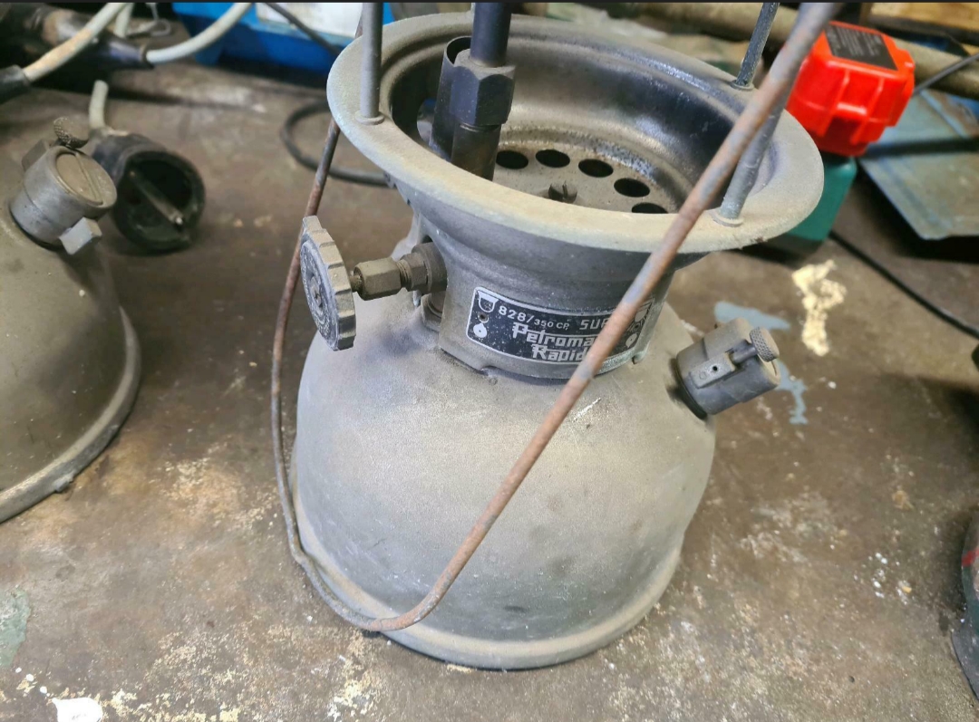

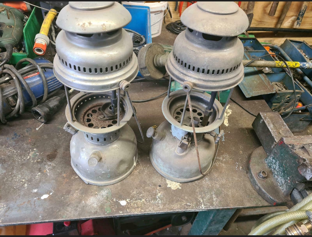

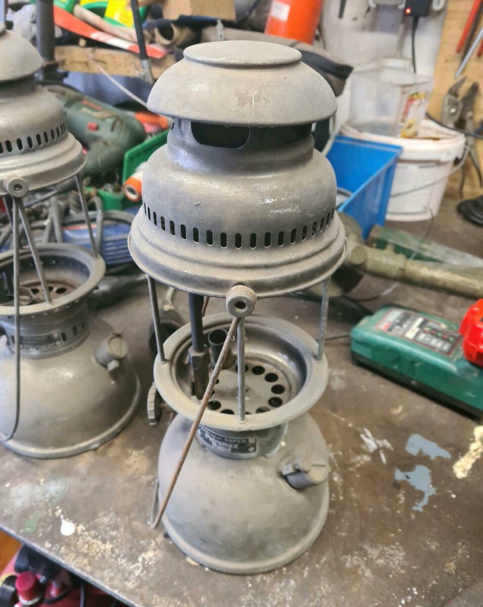

    I got an 828 "Sickentank" that I bought as a parts carrier.
    Screenshot_20210527-191955.jpg Screenshot_20210609-222025(1).jpg Screenshot_20210609-222014(1).jpg Screenshot_20210609-222002(1).jpg

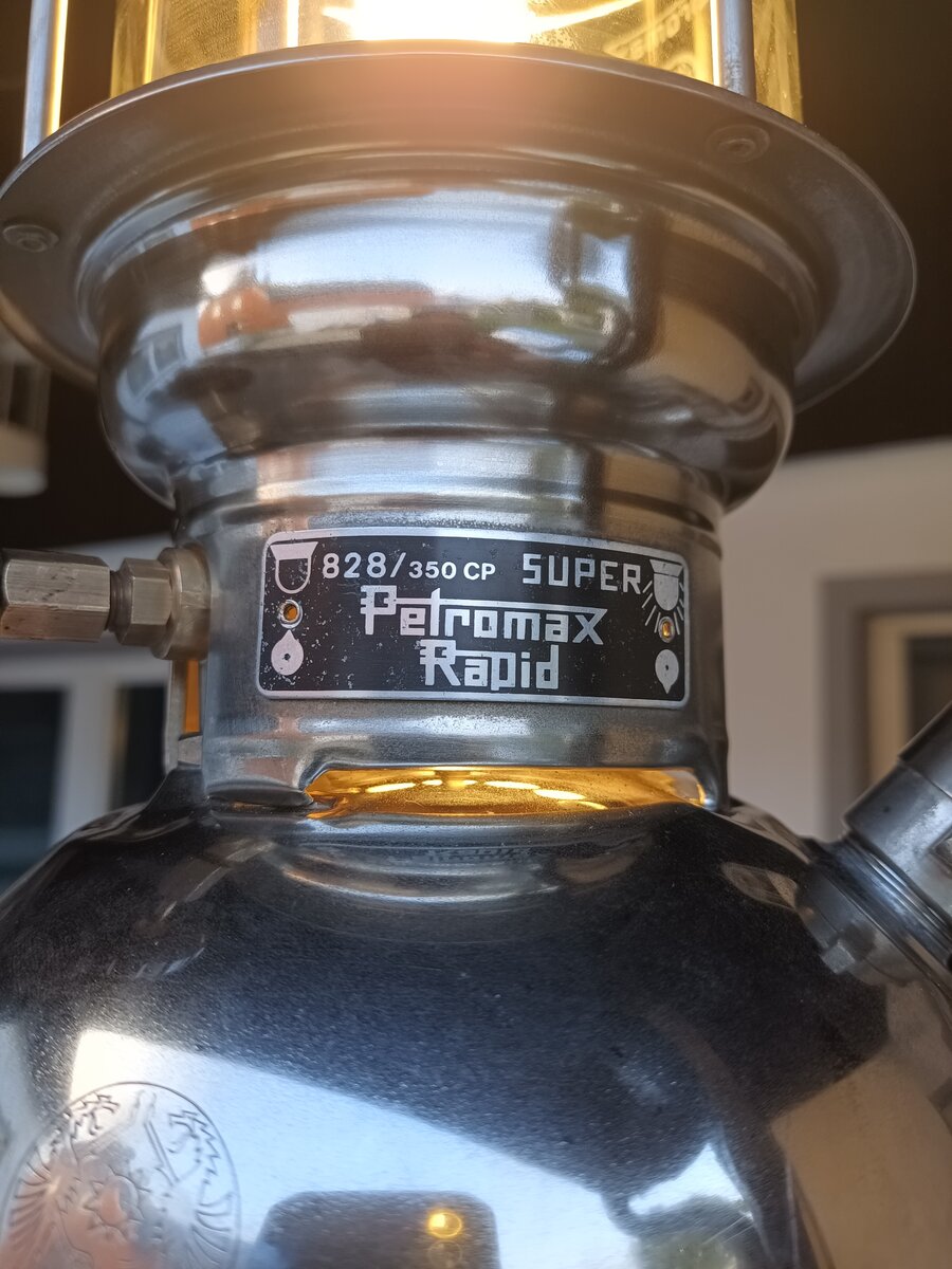

    When taking stock, I noticed that the lamp was completely untampered and technically new.
    I was able to recondition the surface, the technology only needed one cleaning.

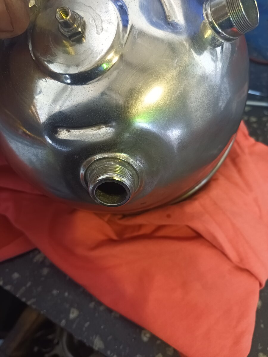

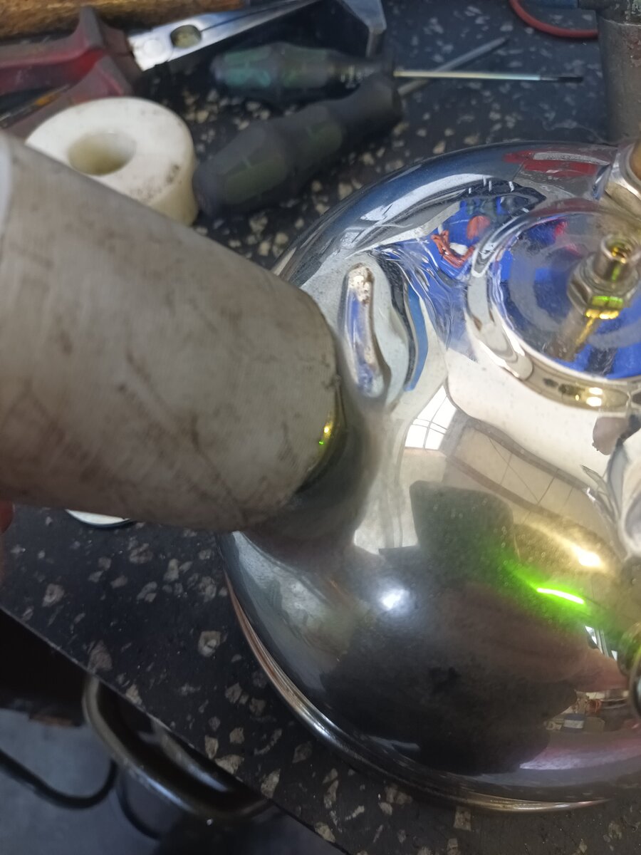

    Unfortunately, the tank had once received a bad hit on the pressure gauge and was badly depressed.

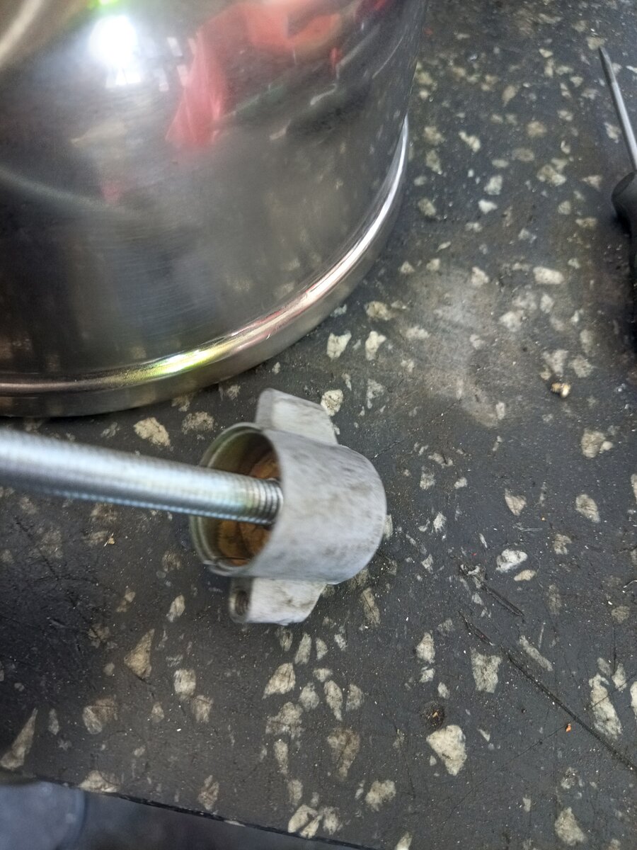

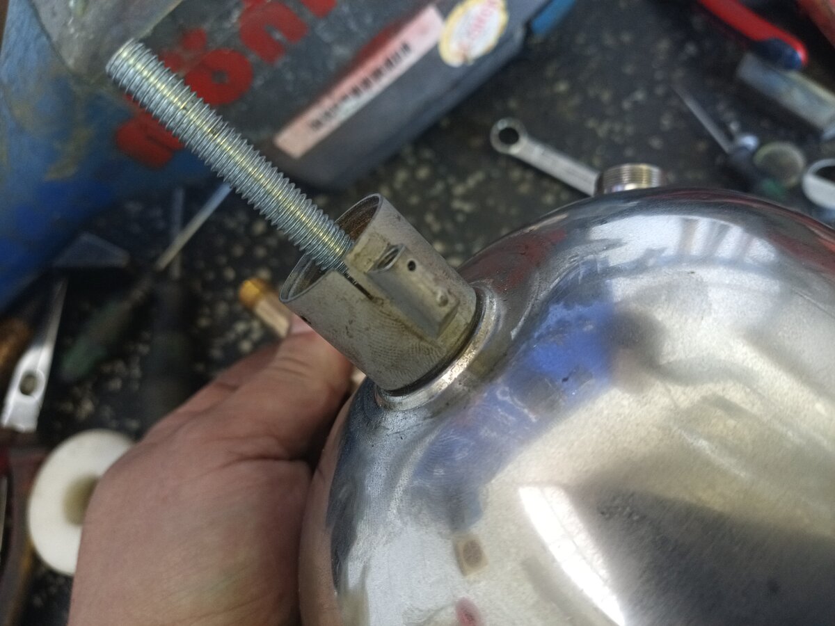

    With a self-made pulling device from a defective manometer from Chinese production, I was able to carefully pull the nozzle out again.
    I pulled the socket out again with a threaded rod that was inserted into the old manometer.

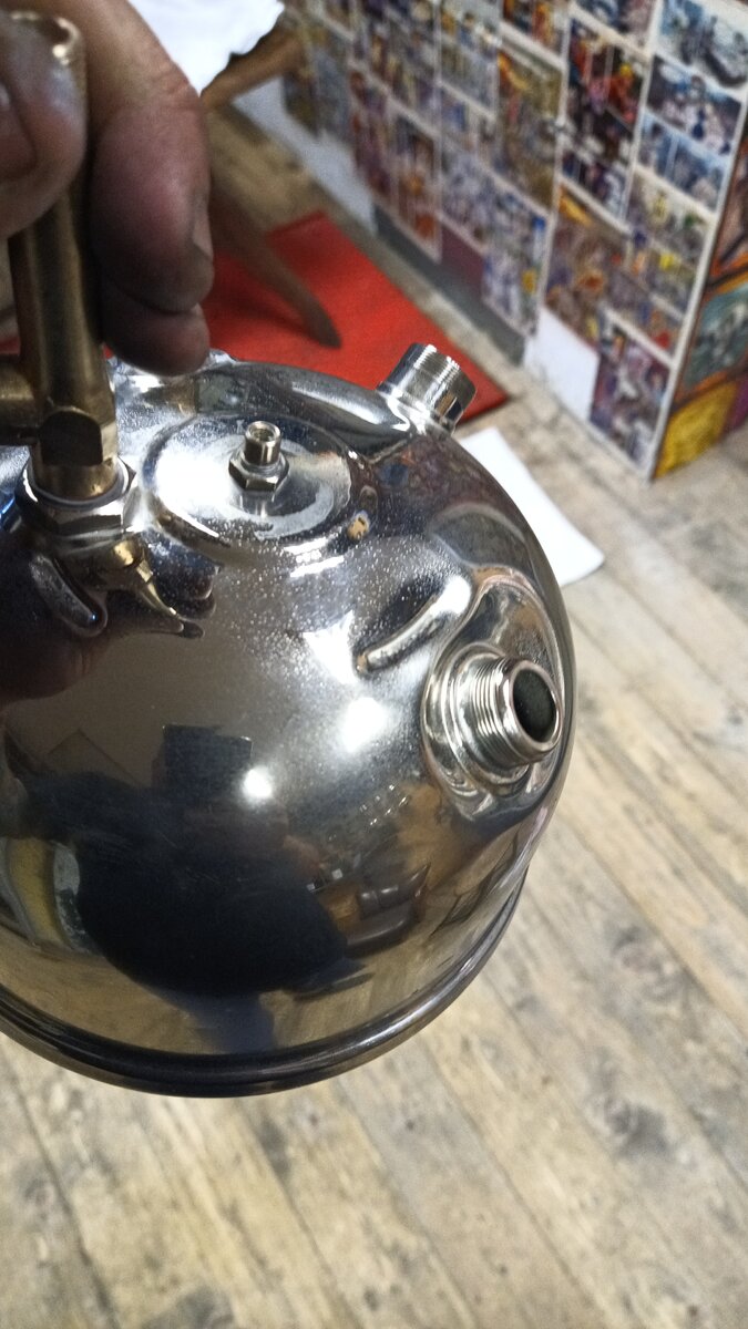

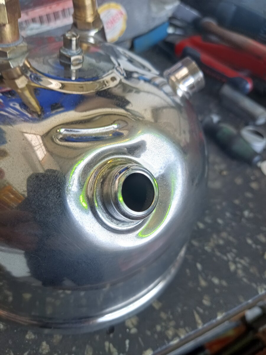

    A plastic pipe is used for support by pulling very carefully and checking frequently, I was able to quickly and completely eliminate the damage.

    Looks like 2 different founts. Well done.
  3. John
    John United States Subscriber
    Jan 8, 2011
    678
    Dallas, Texas; United States
    Very well done, I never would have thought of that.
  4. Fireexit1
    1,359
    Excellent job ! thanks for sharing that idea :clap:
  5. BigStevie
    1,992
    Well done, an excellent job and a fount saved!
