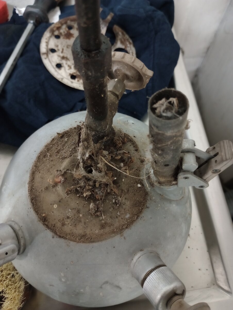

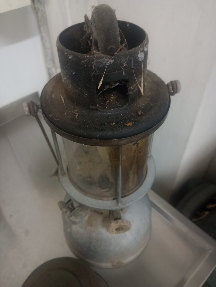

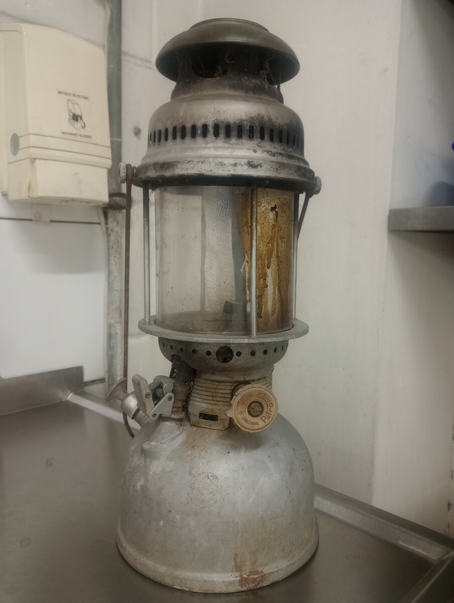

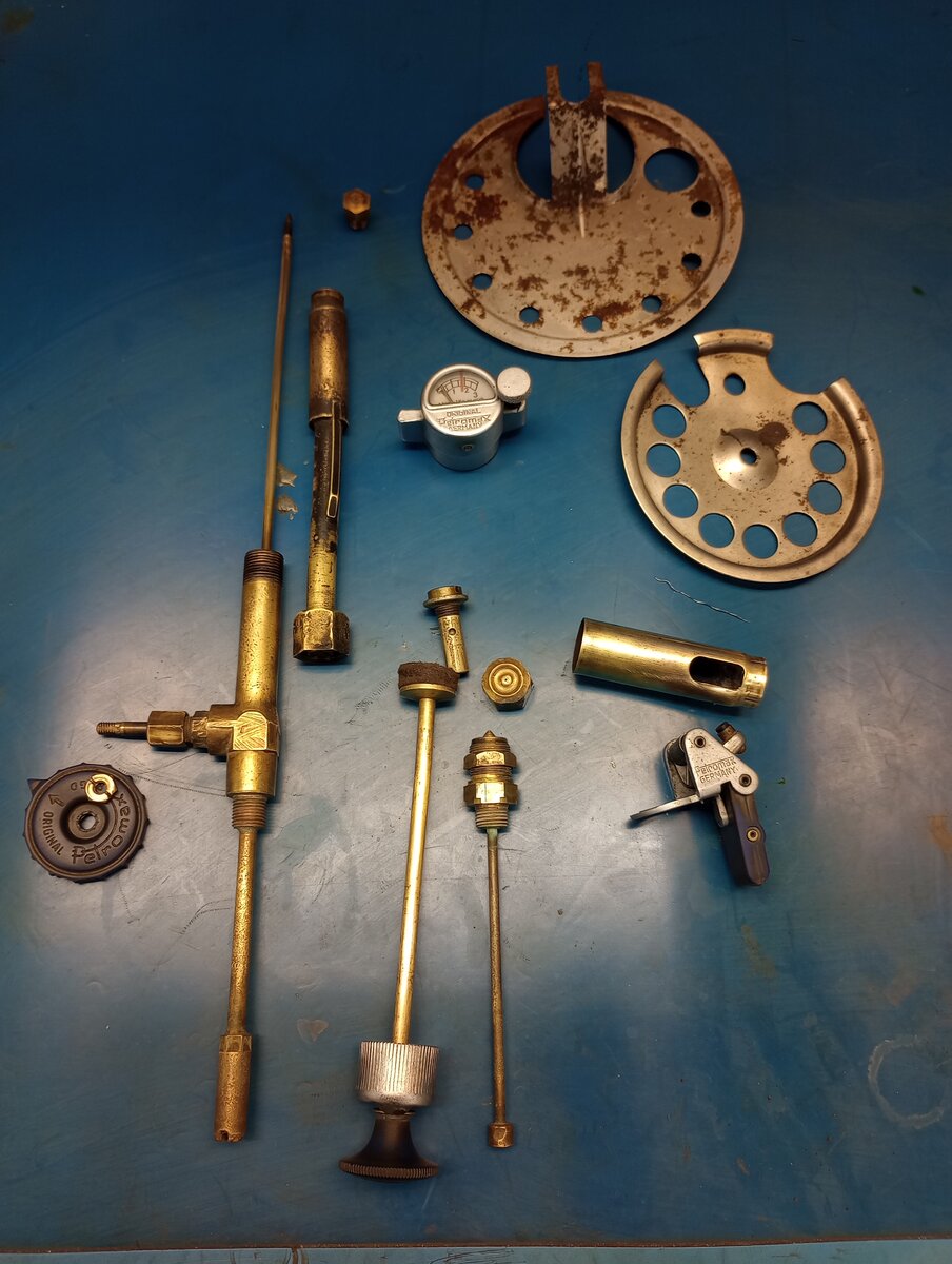

    This Petromax 829 B. I bought in such a condition.
    IMG_20231006_164544945.jpg IMG_20231006_164658602.jpg IMG_20231018_181312130.jpg IMG_20231018_181516071.jpg
    I learned from fellow forumers that it was designed to run on gasoline, but that for safety reasons it is recommended to use kerosene.
    I cleaned the components, washed what I could and put it together.

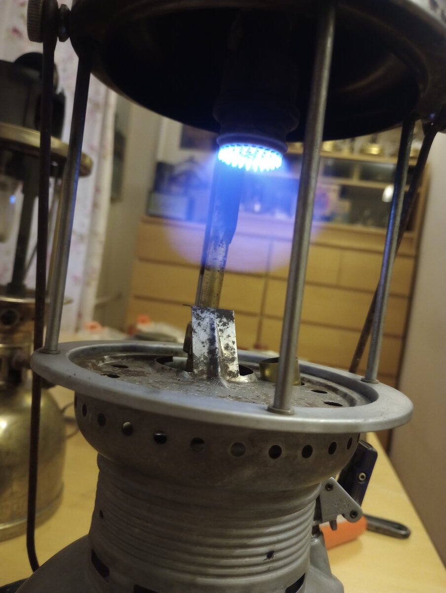

    I had some trouble getting the Rapid to work, but again my colleagues were happy to help.
    When I got to grips with the Rapid, I refueled with kerosene and did a burner test.
    It required a longer warm-up, but it looked pretty decent.

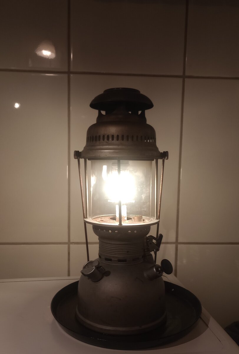

    I then put on the mantle and fired it up again.
    I noticed a slight yellowish glow outside the mantle.
    It was suggested here that I replace the nozzle with one with a smaller jet.
    I will purchase such one soon.
    Thank you all for your helpful advice.
    Greetings
    Stanislaw

    It's cleaned up nicely Stanislaw. :thumbup:
    Good luck with the conversion to kerosene.

    Looks good Stan. You’ve captured the aura of the burner output well.

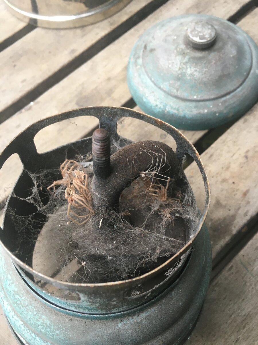

    Evidently you encountered former insect occupants as I did with my current BAT No.42 project.
    John

    Apparently the spiders have taken a liking to the lamps as their hiding place.

    2,891
    It looks good. At least it came with all original parts intact. Not sure about the glass globe though.
  7. JEFF JOHNSON
    14,743
    Well saved.:thumbup::thumbup:

    Very good work :thumbup::thumbup:
    And it is proof that the straight carburetor also works with kerosene.It is therefore rightly called a universal carburetor.
