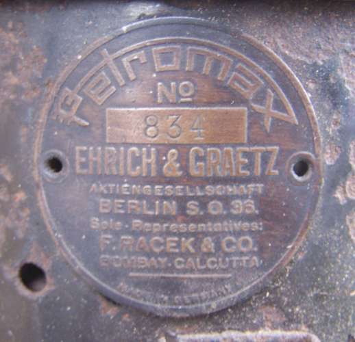

    I found this Petromax 834 on ebay recently. It's a bit of a rustbucket but I hope I can get running.
    Does anyone know where I could get a filler cap for it?
    What about the ceramic nozzle? Will a lantern nozzle fit? The mixing tube comes in two parts so I think the answer is no.
    1397149008-834a.jpg 1397149012-834b.jpg 1397149017-834c.jpg 1397149020-834d.jpg

    I wonder if you unscrew whats left of the combined ceramic mixing chamber/nozzle these might be a thread on the inlet tube that may take a 500cp Petromax clone brass & ceramic burner replacement :-k

    A filler cap from another Px fits for the moment, till you find an original one.
    More problems you will have with the nozzle, this is a aspecially 834 size

    The 834 is a 250cp lamp, the thread size is different from the same size nozzle off of an 827.
    834 on the left, 827 on the right.
    I do not remember if there is a seperate nozzle holder on the 834, if so perhaps it could be swapped for a newer threaded style.

    Thanks for the info about the filler cap - that's one problem sorted. If I can't find an original part I suppose one of those Schrader valve caps would be closest.
    Upon taking it apart I discovered that the threaded part of the mixing tube is broken. I could probably solder it up but maybe I should just try and graft the end of a modern lantern mixing tube onto it as this would also solve my nozzle problem.
    I bought this lantern from Italy but I assume it was originally used in India. I got it cheap so I can't really complain if it is missing a few bits.
