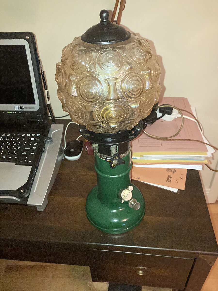

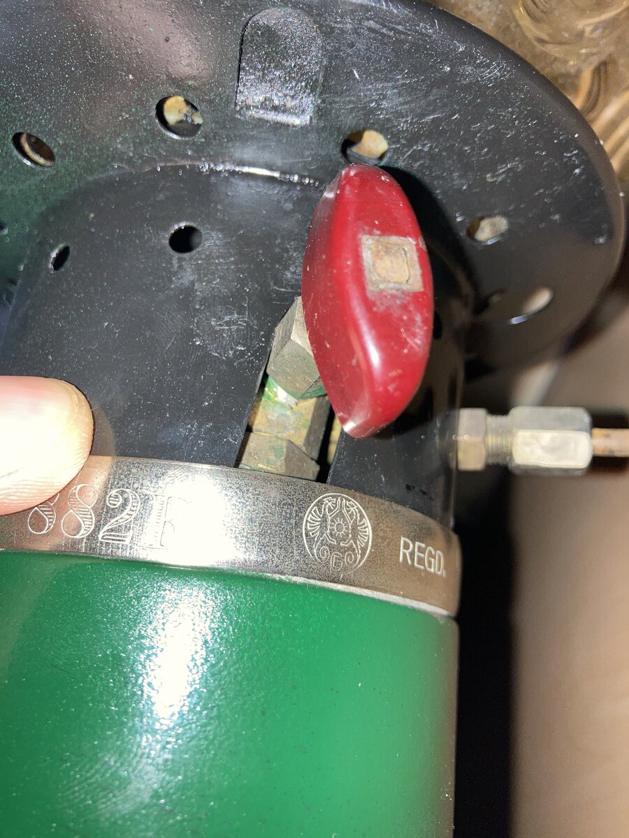

    hello all,
    ****Petromax 882E- error in title
    I am new to this forum but I got this lamp (converted) recently. Very hard to find any information on it- from scanning the forums here the glass shade/globe seems to be unusual or potentially difficult to find. What was this used for?
    It’s obviously been messed with is no longer an oil lamp-resprayed etc- is it valuable?
    Think it’s only recently butchered- fresh paint ... €70
    Thanks for any info
    Regards Alan

    Welcome,
    Well you can find information here in this forum. The petromax 882 is rare.
    70 euro is a steal.
    So you better get the paint off again and convert it back to kerosene.

    6,509
    882 and 883 lamps are rare as Wim says so it will be well worth the trouble to plug and seal the tank. You have the major parts of a very uncommon pre WW2 Petromax which deserves restoration. ::Neil::

    Plugging the hole in the tank is not a big thing for a collector to do. It's the missing burner parts that you really need.

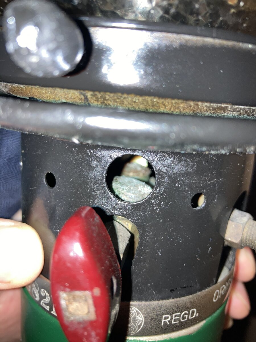

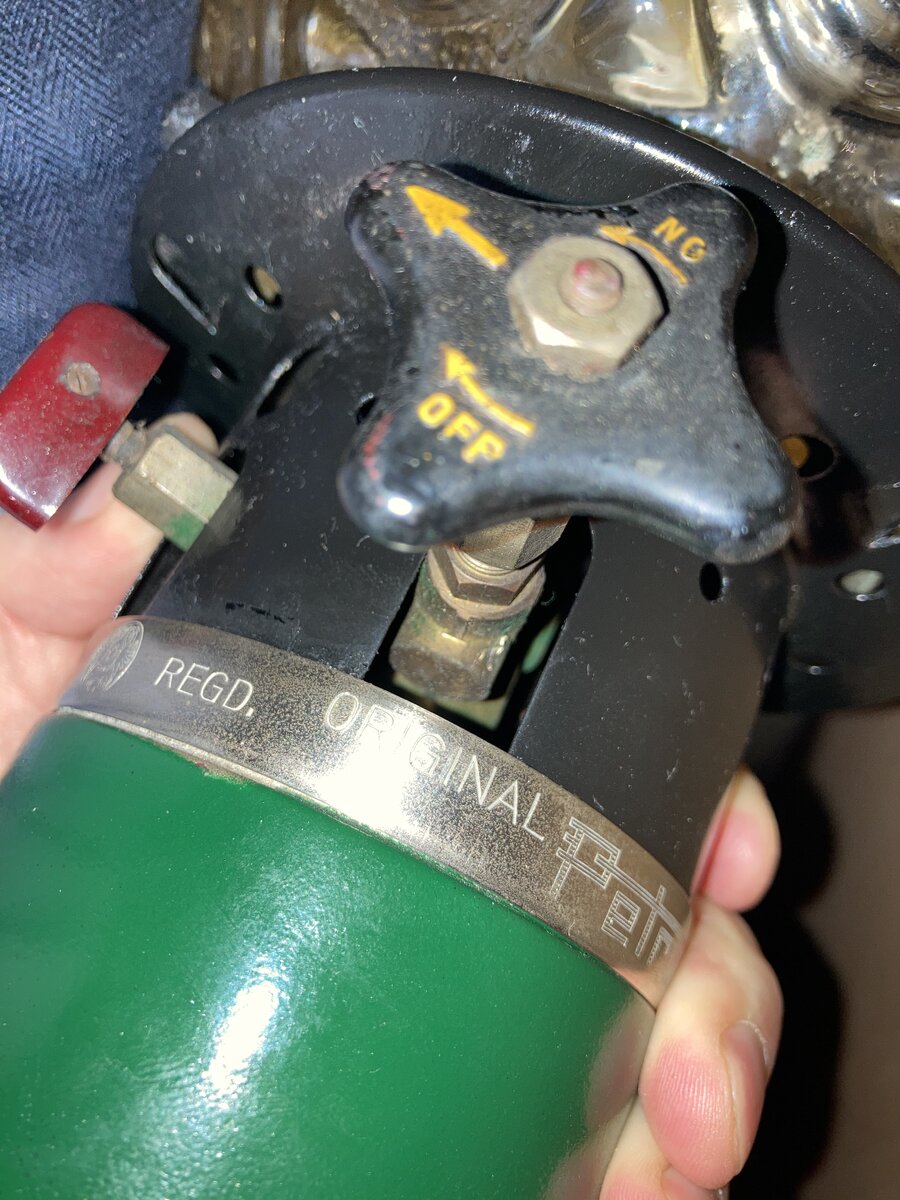

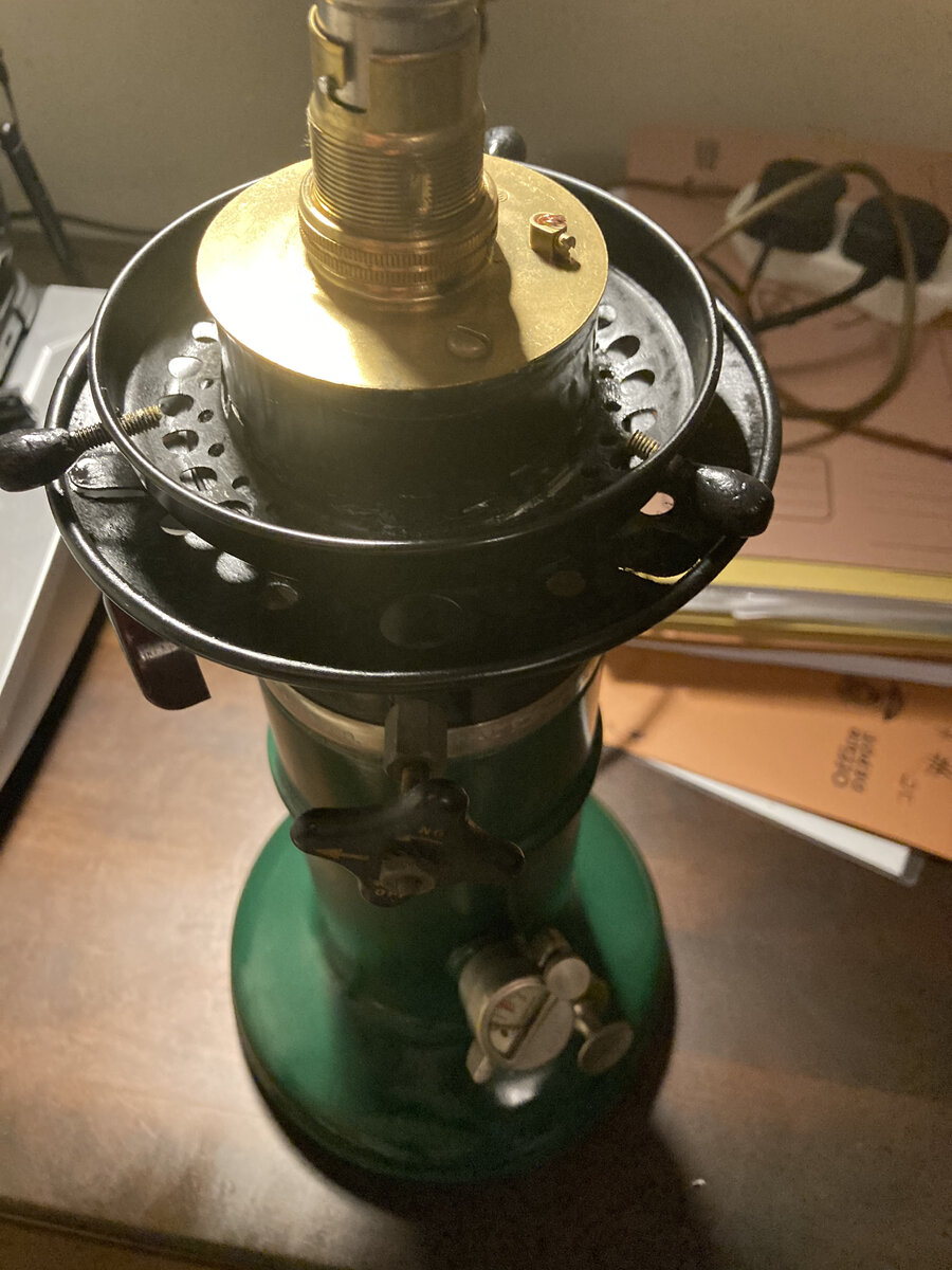

    I don’t know what I’m looking at tbh but I attach photos..the ‘riser’ containing the burner I presume seems sawn off above the black valve of the black star type knob.... the red knob seems to have its valves etc intact???.... any hope for it?
    on a positive note the glass globe is in perfect condition- no pictures online of such a shade ... is it decorative or designed to diffuse light or both... reminds me of a lighthouse lens... also Art Deco look to it?

    Well I actually thought about this: what is "modified" to house the electrical stuff?
    So how is the electrical cord brought up out of the top.

    had a look... he’s drilled a hole in top of tank also - not good!

    I expect someone could graft the burner from a Petromax 829 on top of it, rather like has been done here:

    Modern parts can be used to replace the butchered remains of the 'lower vapouriser' (riser) though the fuel feed tube will have to be swapped with the original one which will require soldering skills.
    Use the black star type control and the bits that go with it.
    The upper vapouriser and flame tube for the rapid preheater are still available.
    The burner and air tube will be a different matter.
