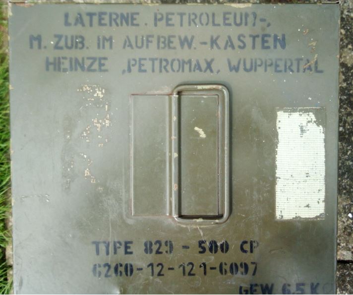

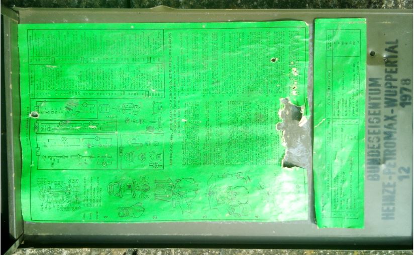

    829B, originally with straight generator, which was replaced with a loop generator, a spirit cup added (#35), and pump adapter fitted for a extremely reliable and user friendly lantern.

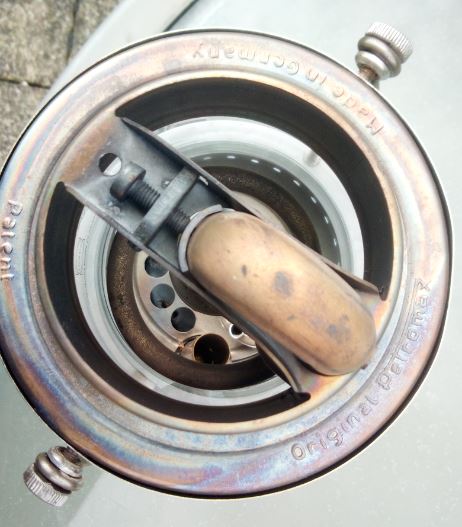

    A good lamp. But I'm curious about this black something around
    the preheater seat. Colour, tape, what's the use of it? Normally it should
    not be there.
    Matthias
  5. Alex Smith
    Jun 18, 2019
    62
    Midlands, UK
    Hi Matthias, you are correct about the tape. It should not be there. It is "Rescue Tape" (heat and pressure resistant self amalgamating tape - normally used for temporary fixes to pipes and hoses on vehicles etc).
    Long story, it was my first lamp, and hadn't fully understood the relationship between the lead washer (#90) and the font, and hadn't yet discovered how effective copper-slip is at helping to seal the joint. The long story short, while waiting for new washers I fitted the tape, which has held since and will remove it in due course!
  6. LatMag49
    LatMag49 Germany Subscriber
    Aug 31, 2017
    27
    Hi Alex, so when the rapid preheater is tightly fixed with a lead washer,
    you will have the choice and fun with preheating both ways. The torch
    is more spectacular while the spirit cup is more gentle to the mantle.
    Try out and enjoy.
    Matthias
  7. Alex Smith
    Jun 18, 2019
    62
    Midlands, UK
    Hi Matthias, Thanks for the advice. I will give the rapid pre-heat a go once I have tightly fixed with a lead washer. Regards, Alex
