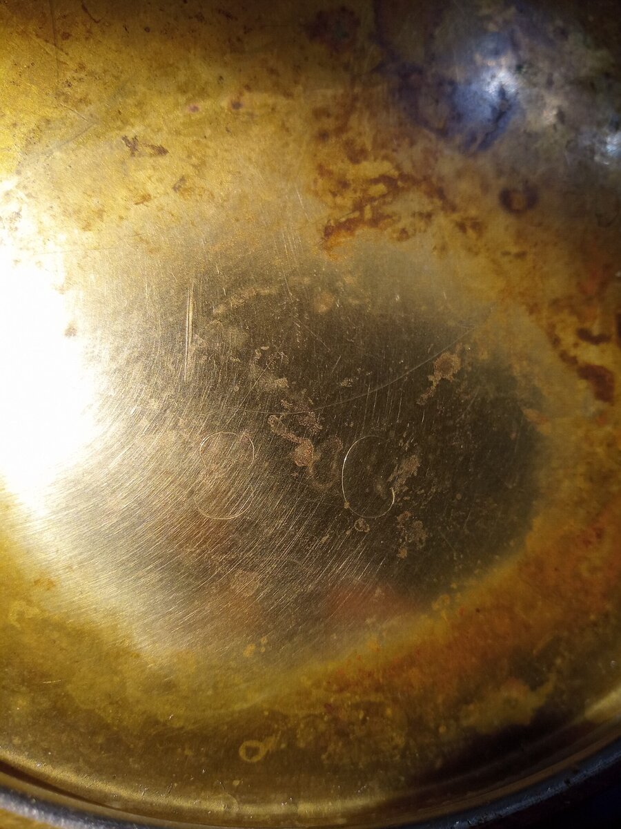

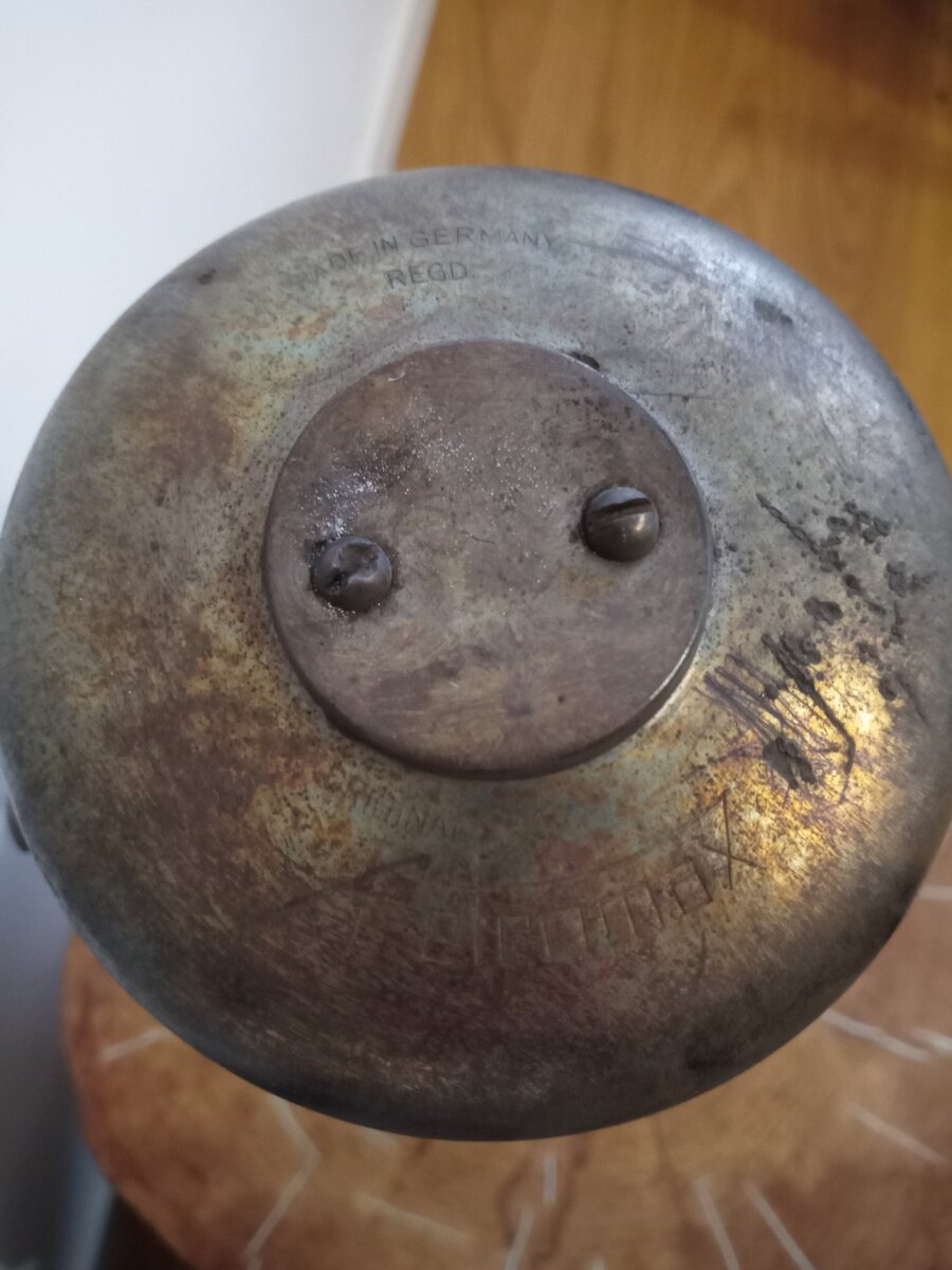

    Please find my Petromax R 826.
    It is not that old. The bottom shows the scratched numbers 8 6 which most likely stands for 8, August and 6, 1936. Anybody please, feel free to correct/verify me.

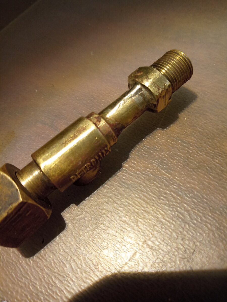

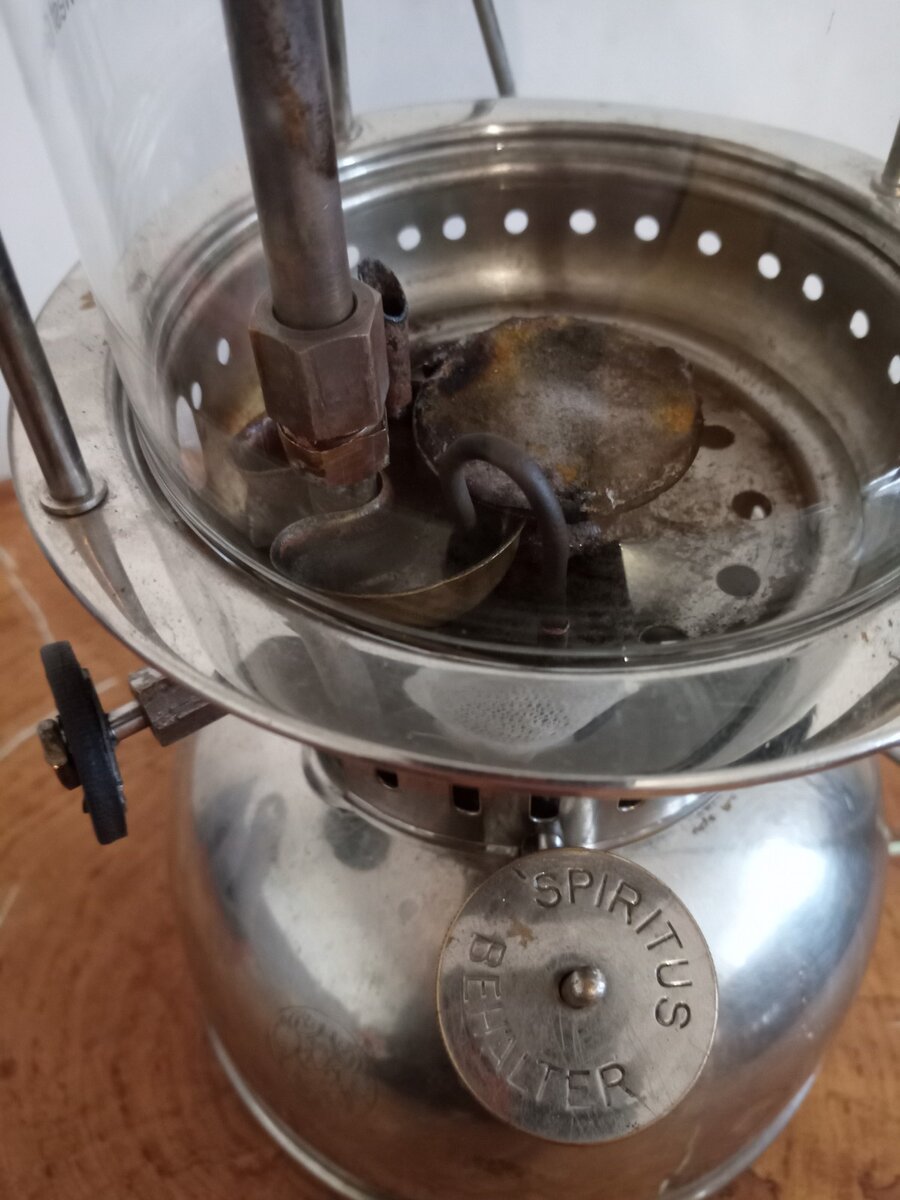

    I was surprised to find some weird looking generator type, but then realized that someone in the past modified it soldering several pieces together to fit newer, typical upper part of the generator. I presume that it was not done but any collector, because that lamp was in filthy condition and generator full of carbon. That lamp was a user. The same about „improved” wheel steel holding part – some nice personal touch from the past:)
    Lamp is fitted with some old 300cp Primus jet and needle set. Jet size is more 400-500cp now, so I put 500-600cp Butterfly mantle and it works fine.
    Generator required several of heat, quench, tap and steel wire cleaning cycles to get rid of plenty of carbon from the Preston loop.
    OK, now my shameful fettling “adventures” – readers with less patience and sense of humor are advised to skip that part :)
    The modified generator part as well as the “regular” upper generator parts were bent. I decided to correct them.
    Regarding that weird, “custom made” part of the generator:
    I got overexcited with heat and vice and somehow fu…. it up. I made the threaded part and that additional soldered nut more like “egg shape” in the process… I was devastated, but I am getting used to that feeling). Miraculously I managed to shape it back to circle/round and threads fit again. After that, I even made it straight. While repairing/reshaping that part, the pipe seam just below that soldered nut developed cracks and I had to hard solder it to reinforce the cracked brass seam. I was successful again. That additional nut just below the threading was looking ugly after my vice “help”, so I corrected the shape of it and made it rounded on two sides and made nice flat surfaces on other two sides. Finally that part was straight, soldered and reinforced along the seam, not leaking, looking even better then before. So this is my personal input to the lamp history. You can see how that part looked before and after my intervention on attached pics.
    Straightening the upper part was easy and nothing unexpected happened during the process.
