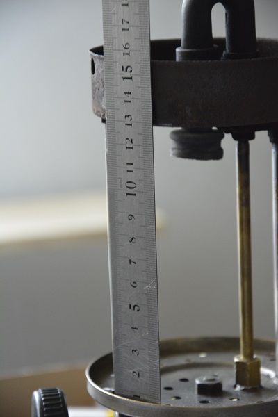

    Several months ago my friend Serge Dupont sent me these two Phoébus lamps, a number 625 kerosene lamp for in-depth maintenance and a number 631 benzin lamp to make a mica globe for him.
    I completely resealed the joints of the 625 by fitting a new needle for 200 cp.
    Viton gasket for the tank cap.
    Graphite and lead seal for needle control.
    I removed all the flexible Teflon plumber's tape gaskets back to the original source.
    A little copper grease for the brass parts.
    Cleaning only mechanical parts for a light test.
    Fresh oil, three generous preheats, a Pétromax troubleshooting globe and the lamp works perfectly despite a small 150 cp mantle.
    Before the lighting was asthmatic and now they have disappeared.

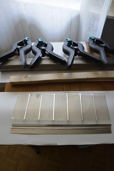

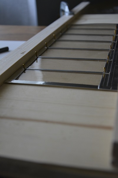

    For number 631 I did a small overhaul, removed the plumber's flexible Teflon seals, firmly tightened all the parts and remade a mica globe.
    After a little preheating with a lighter from the Coleman 155 type generator, it works and lights perfectly despite a small 150 cp mantle.
    Now they are back on the road to meet the lucky owner at the end of the week.
