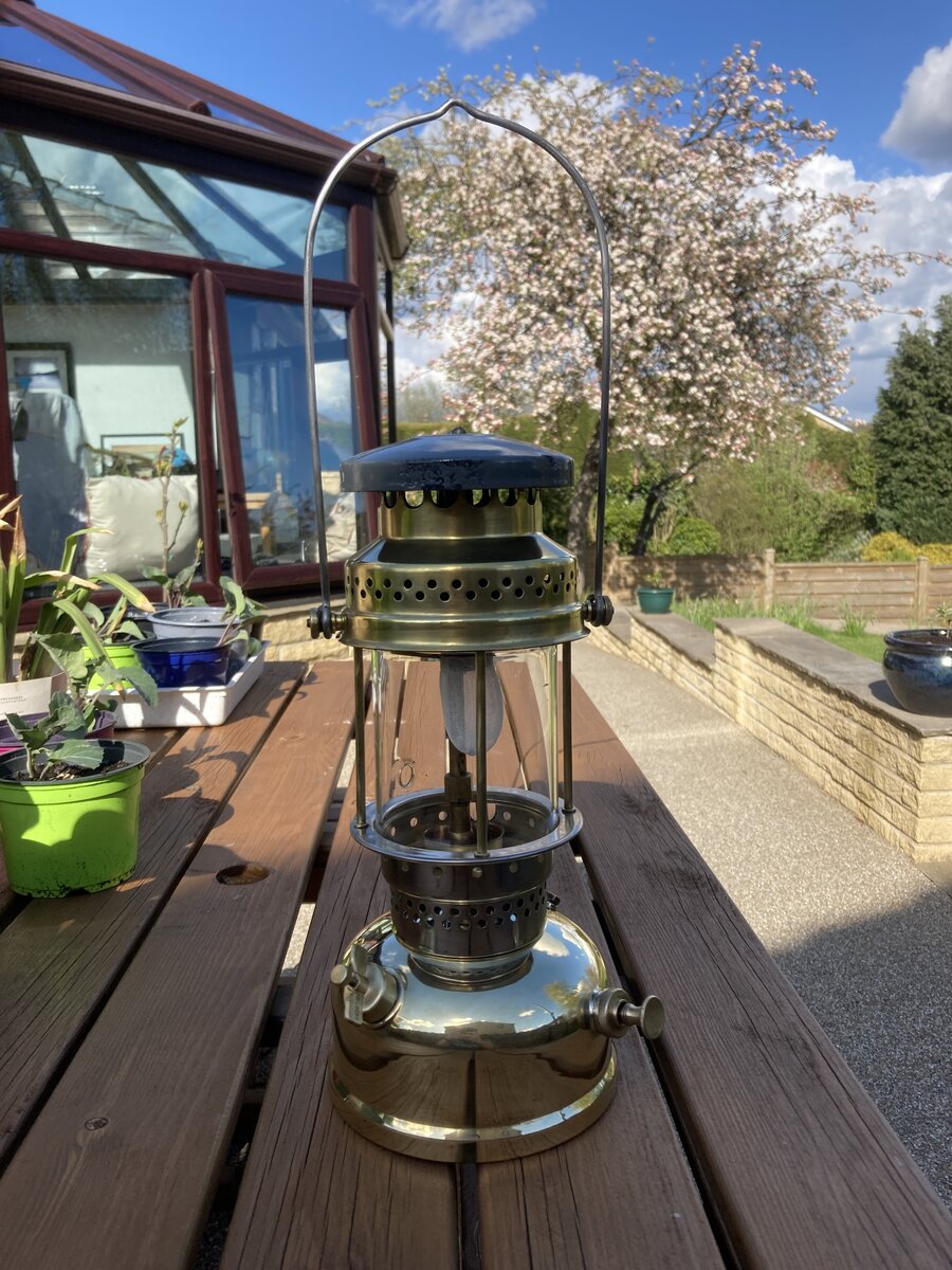

    I may have a problem!

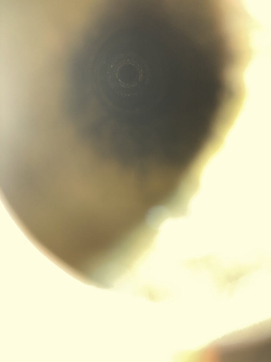

    I fired the Phoebus 635 and got a decent light initially but the nrv was passing enough to be a problem. I tried to remove the valve to replace the pip and spring but the lug sheared off the top of the valve not leaving enough to be able to get anything on it. I tried an extractor but still couldn’t get it moving but after several attempts have now drilled straight through the valve so the bottom end section dropped into the fount. I think/hope I still have the upper edge and thread of the top section of the valve in the threaded hole at the bottom of the pump tube so I don’t think all is lost yet. I’m open to suggestions as to how to proceed with the final extraction, assuming there is something left to extract. (It would be a big gamble on my very recently acquired soldering “skills” being up to removing/replacing the whole pump tube). I’ve also struggled to find much info on the lamp. It looks like a typical Primus/Optimus nrv and the Primus tool fits but I need to know for certain before I make this situation any worse.
    If I do have to drill out completely, could I size and tap for a larger nrv, a Bialaddin for example?
    Of all the lanterns I’ve worked on so far it would have to be one of the rarer ones that I have my first major problem on!
    Couldn’t manage a better photo.
    Thanks

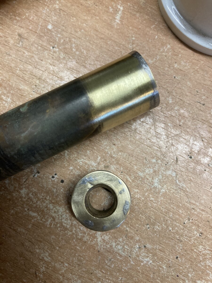

  9. Scott D
    Aug 10, 2020
    275
    Yorkshire, UK
    A4010079-1047-4E25-9E24-7D3A3AB31AA9.jpeg Well I wish I’d done that two days ago. It seemed fairly well stuck when I started trying to pull it out but once I started twisting and pulling at the same time it slid out fairly easily. The good news is that it looks like I’ve stopped my drilling and extraction attempts just short of the pump tube thread for the most part and the body of the valve just fits through the hole and the NRV thread is wider still so I should be able to get a good enough fix to seal it. There is still some surplus metal in the threads but I think just passing a tap through it will clean it up nicely. The NRV thread is 5/16” OD, but wondered if anyone can confirm the size/pitch as I seem to have misplaced my thread gauges in the 20 years since I last used them and I’m rather hazy on thread measurements, but do remember it wasn’t as easy as sticking the verniers on the thread and reading the OD.
    Thanks again for the advice, feeling pretty confident about the Phoebus now and really pleased that I’ve actually attempted the repair!
